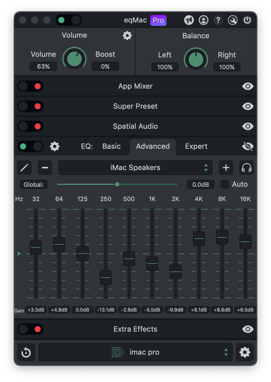

Sure. I haven't measured anything, so it's really just a subjective EQ.
Code:
Preamp: 0 dB
Filter 1:  ON  PK  Fc 32 Hz  Gain 3.31 dB  Q 1.41
Filter 2:  ON  PK  Fc 64 Hz  Gain 4.9 dB  Q 1.41
Filter 3:  ON  PK  Fc 125 Hz  Gain 0 dB  Q 1.41
Filter 4:  ON  PK  Fc 250 Hz  Gain -13.08 dB  Q 1.41
Filter 5:  ON  PK  Fc 500 Hz  Gain -2.81 dB  Q 1.41
Filter 6:  ON  PK  Fc 1000 Hz  Gain -5.49 dB  Q 1.41
Filter 7:  ON  PK  Fc 2000 Hz  Gain -9.91 dB  Q 1.41
Filter 8:  ON  PK  Fc 4000 Hz  Gain 8.11 dB  Q 1.41
Filter 9:  ON  PK  Fc 8000 Hz  Gain 8.77 dB  Q 1.41
Filter 10:  ON  PK  Fc 16000 Hz  Gain 6.46 dB  Q 1.41
Perfect this really made a huge difference! thank you

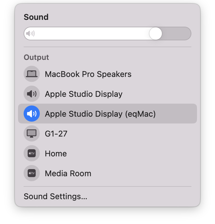

Anyone know how to rename the audio device name in Mac OS? plist or something.
I have a sort of work around but it shows the old G27 name etc. would love to clean it up a bit.

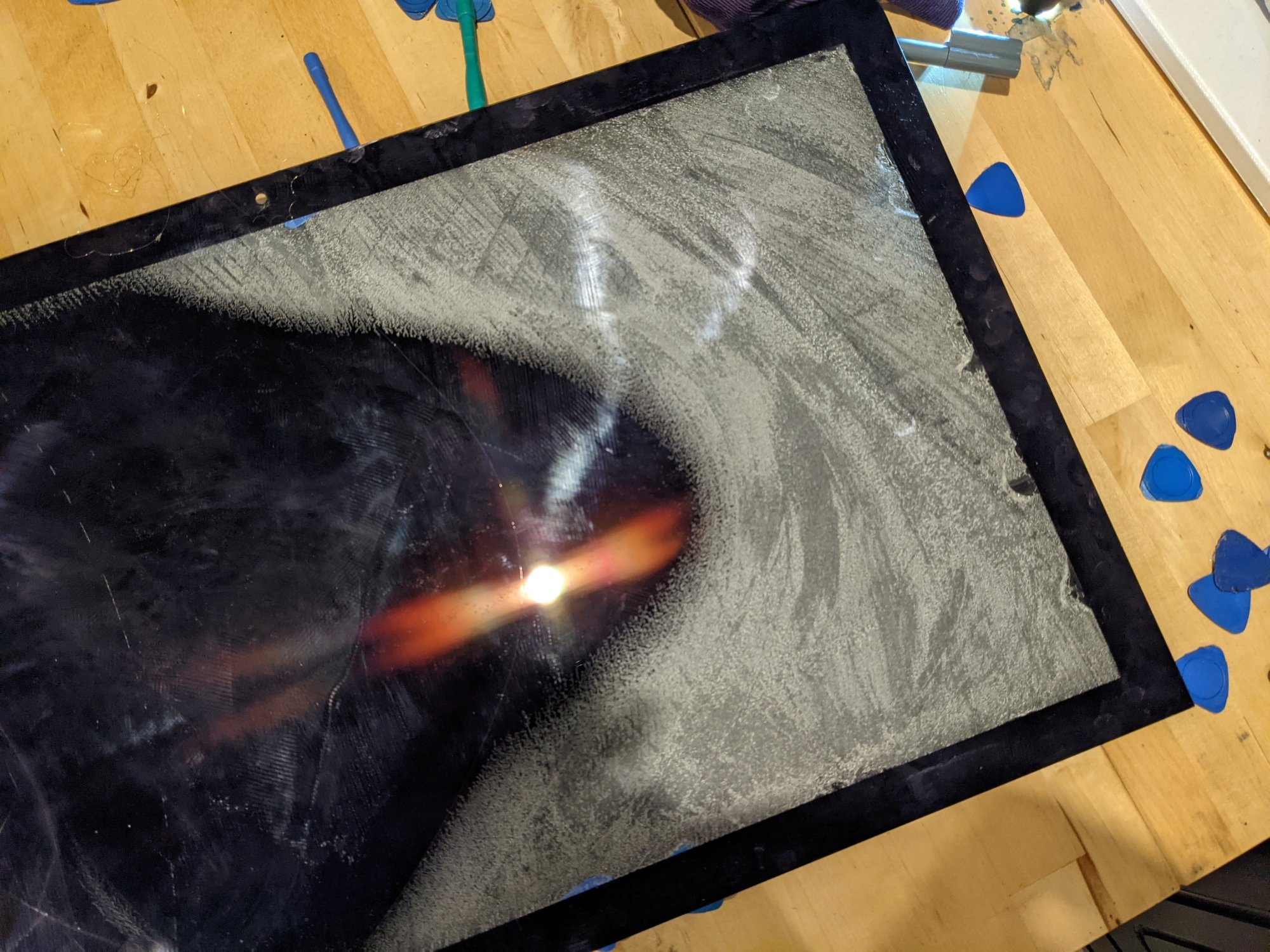

Quote: "does anyone know what the apple panels are like if you remove the glass? is the panel useable? "
Everything has been done in this thread. ;)
Not sure if @thewilewizzard actually answers your question in post #815
but he shows pictures of how to dismantle a screen panel:
"Comrades. Greetings to everyone. I am from Russia and would like to share my experience. I took out a broken imac 5k lm270qq1 matrix and decided to glue the glass from imac 2010 on it and assemble it in the same case. With a 0.1 mm molybdenum string and a blowtold dryer. We worked together with my friend, he warmed with a hair dryer, and I worked with a string.
The first thing I did was to remove the metal panel and left only a glass and matrix sandwich (the reflective scattering films were removed aside, which was a big mistake) now I think that you can paste the matrix without removing it from the metal body.
After I took off the glass, I started laying the films in my place, which was very difficult to do, they constantly slip off their place, so I grabbed them with painter's tape. After that, I screwed the plastic guides to the body and finally centered all the films and matrix in the case.
Then the most difficult thing was to clean the matrix of oca glue and MECHANIC 8333 spray helped me with this, which in turn is very similar to acetone in smell and in the way it destroys plastic. After I cleaned the matrix, I began to cover up the area with black sealant where you can see the glowing halo from the backlight and after it finally dried, I centered the glass and glued it to the sealant on the back of the plastic guides.
Of course, it was not without mistakes, when removing the glass with a molybdenum string, the polarizing filter was damaged and now there is a slightly inclear image, the pieces had to be glued to transparent glue. I'll post here a photo of the work, in not very good quality, it may be useful."
Reactions: Regulus67
Separating the LCD panel from the glass itself is indeed possible. It's a lot of work and very messy. And it's way too easy to damage the LCD film layers. It might be an easy way to get a panel at a reasonable price though.
Reactions: Semmo and uller6

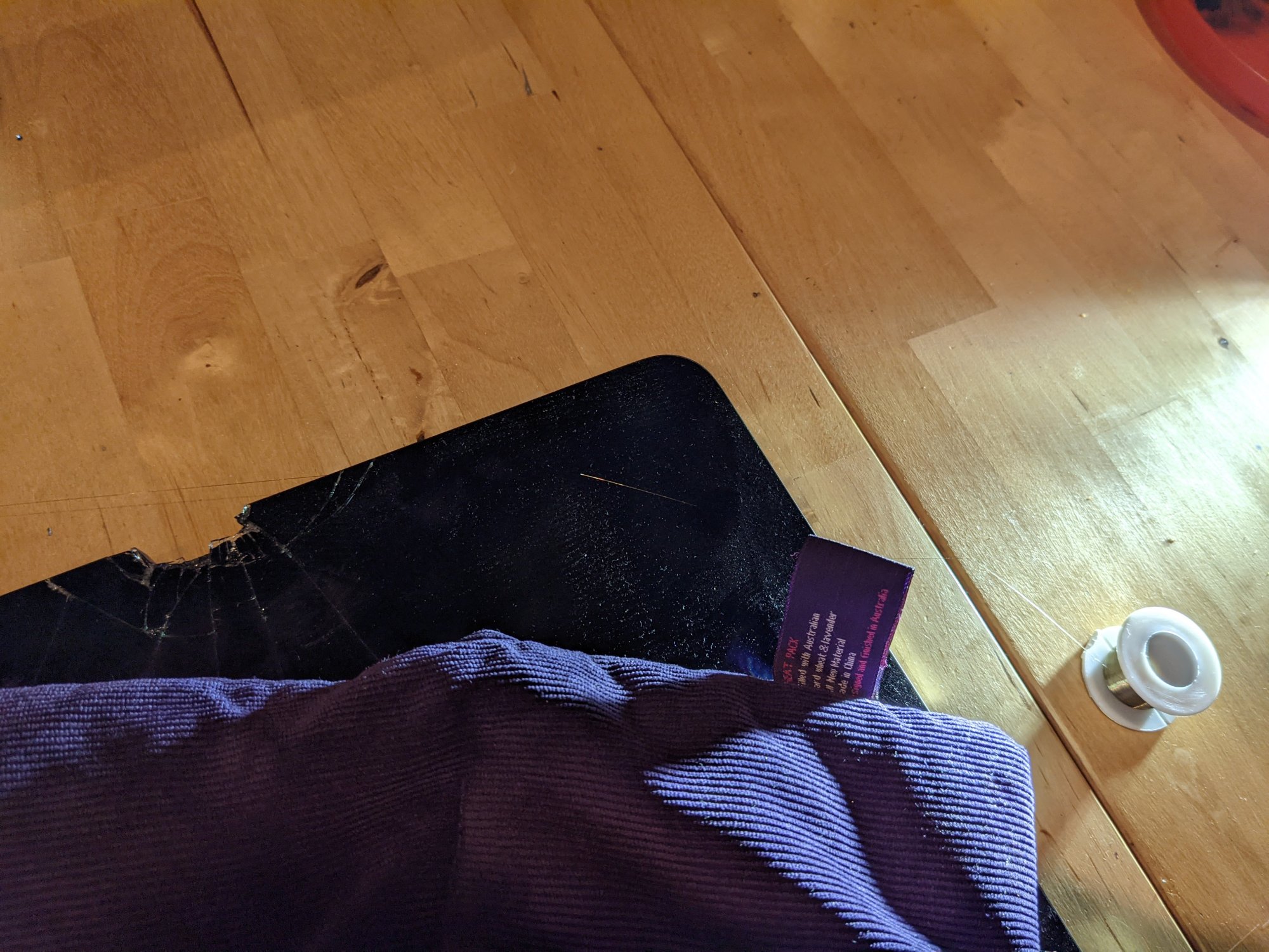

Wow, ok this looks hard. so the screen isn't just glued around the edge, it is actually completely glued lcd surface to glass surface? how is the image quality? if it is a downgrade I will just cut the glass as small as possible to my custom frame
There's glue everywhere. If you manage to separate it the image quality is the same. If you want a proper glass front you might have to re-glue the entire LCD panel to the new glass front. You can see in the last image that there's still glue residue left. I didn't have the magic dissolver which ipad repairer who separate digitizers from LCD panels every day have, so I had to resort to scraping with a credit card and IPA.

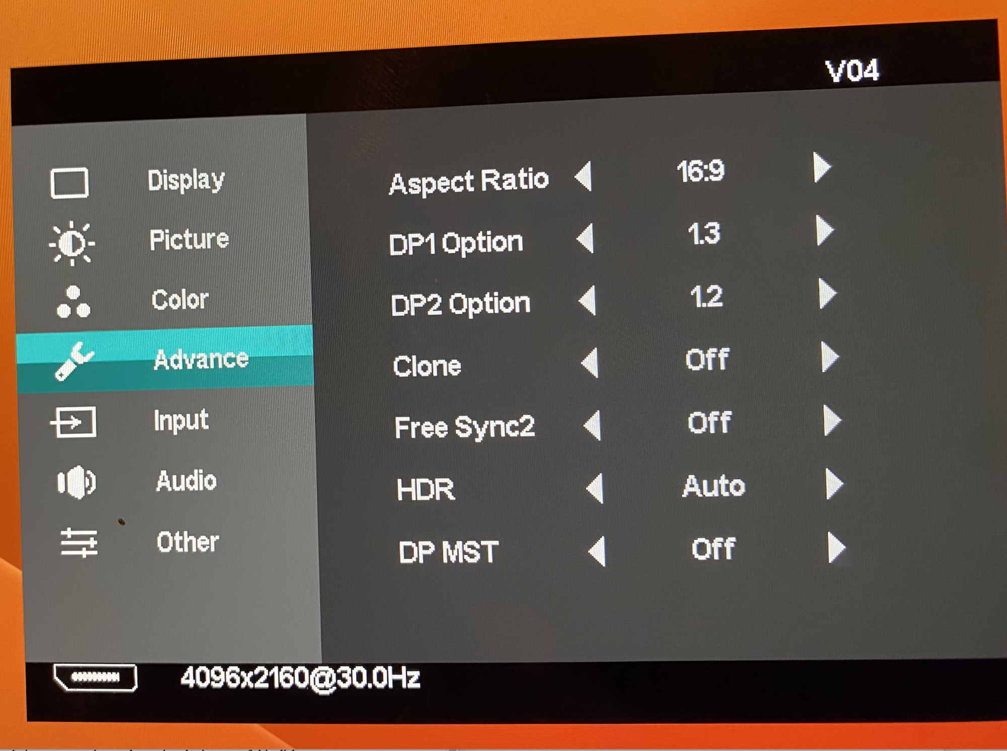

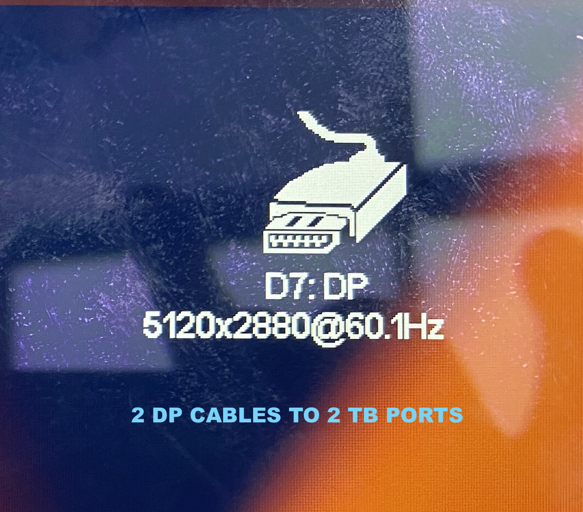

If you connect a R9A18 board via a single USB-C>DisplayPort 1.4 8K cable you will get 5K/60fps (like the Luke M video)
Whether it's 8bit or 10 bit isn't clear.
Hmmm. I’m not getting 5k/60fps via a single USB-C>DisplayPort 1.4 8K cable from a R9A18 board
I’m getting 4k/30fps via a single USB-C>DisplayPort 1.4 8K cable from a R9A18 board

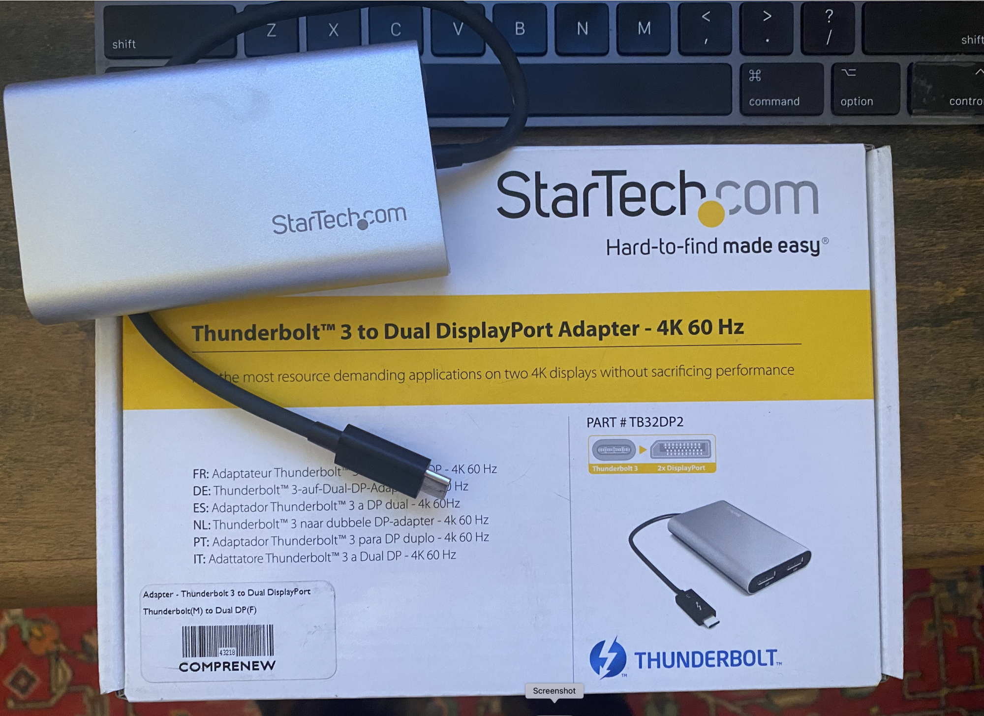

The only way I’ve been able to get 5k was attaching both display ports to BOTH of my MacBook pro’s TB inputs.
I get nothing at all when attaching both display ports through a StarTech Thunderbolt™ 3 to Dual DisplayPort Adapter… Of course it’s possible that the StarTech adapter is bad.. I’ve got to come up with a way to rule that out.
Ideas and advice welcome! Forgive this wonky formatting, I’m unsure what that’s all about.
As always, thank you to everyone for the wealth of information in this thread!
-Paul NYC
What computer are you using?
What is the firmware of the R9A18?
That’s the number at the top of the OSD.
