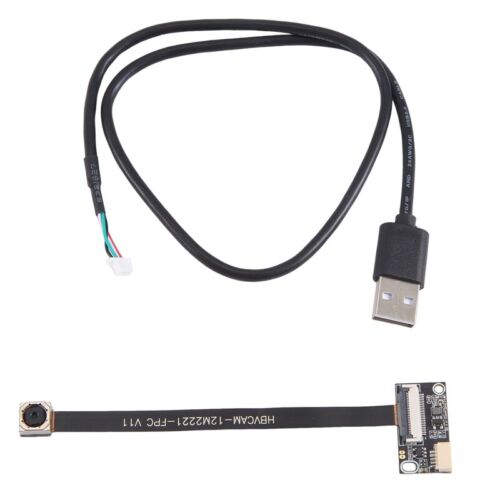

2. I want to have a working camera in the display. Which one can be recommended?

2. IMO Continuity Camera with an iPhone is better...
The one @Aiwi used seems to be the best that anyone in this thread has used.
His link doesn't show details but searching for IMX258 gives this one, which looks like it:
4K 12MP CMOS IMX258 USB2.0 Camera Module High Speed AF/FF 30FPS MJPEG, YUY23211

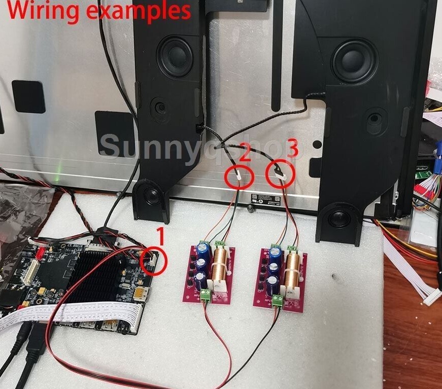

Pulled the trigger on a 1811. I want to hook the orig speakers to it. What’s the easiest plug and play solution for this? I have read the thread but it seems way over my head and too technical for me.
Just noticed the eBay-UK supplier of my R1811 is now selling kits to use the iMac speakers with the R9A18/R1811's inbuilt audio amp. Kit consists of crossovers and cables so no modification is necessary.
I had great success following PaulD-UK's post #793. Very easy to connect 👍
Swapped the cables to one of the modules (+ - cables), to get the sound in phase.
I ordered two sets, in case I'll make another DIY 5k Display in the future.
edit: see my post #807 for a close-up photo on the modules
Perfect just what I was looking for! ordered a pair!

I connected the original speakers to the R1811 driver board with a 2-way YLY-2088 crossover board from Amazon.
I find the sound very dull and not very nice, it is not as clear as the original iMac. :confused:
With the lab power supply at 1.5 volts and 0.5 amps, I tested whether the woofer went out or in. If it went out, then I had the plus and minus wires right. This is how I connected it.
But what about the tweeter, because no matter how hard I tried. I couldn't figure out what the plus and minus poles of the tweeter are.
Does anyone have any tips? 💡
