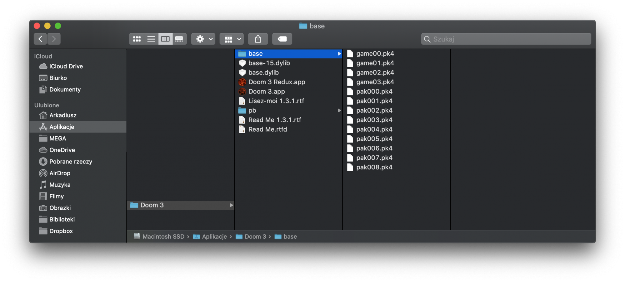

I had it working, and TBH it wasn’t even that difficult (in fact, I had simply missed the screenshot posted a few posts back *blushes*).
If you have a legally purchased Doom 3 copy, you just need to do this:
- unzip the file downloaded from the first post;
- right-click the Doom 3 app in the Application folder and select Show package content;
- navigate to Contents/Assets and you should find inside it a folder named ‘base’ which contains all the .pk4 files;
- copy the ‘base’ folder inside the folder you obtained at the first step and you should be ready to go.

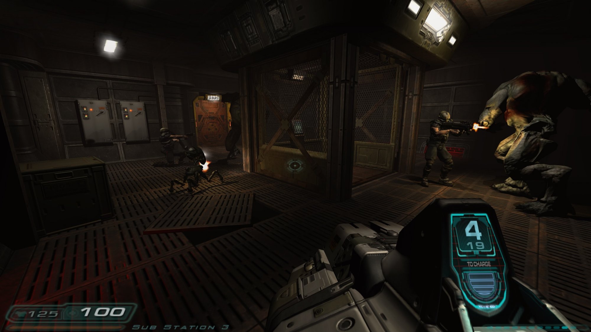

Running great after some matter magic on Big Sur, MacBook Pro 13" i7 2020 and eGPU. I remember I've had fun with single player bots in the past, don't recall mods name but I've seen Dhewm3 requites mods to be ported or recompiled. have you tried/compiled already bots for single player?
