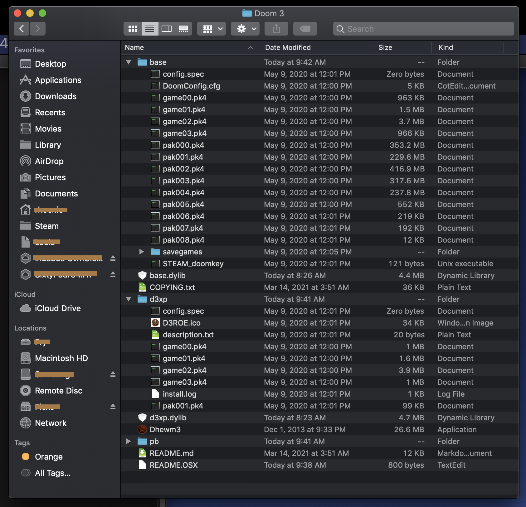

As others have already pointed out you just have to create a Doom 3 folder on your hard disc (I suggest to put it inside /Applications/) and drag all the contents of this disk image into it. In a second step you need to copy over all the data files (base/ and d3xp/) from your official doom3 disc/installation into the corresponding base/ and d3xp/ folders.
On my system the Doom 3 folder contents look like this:
