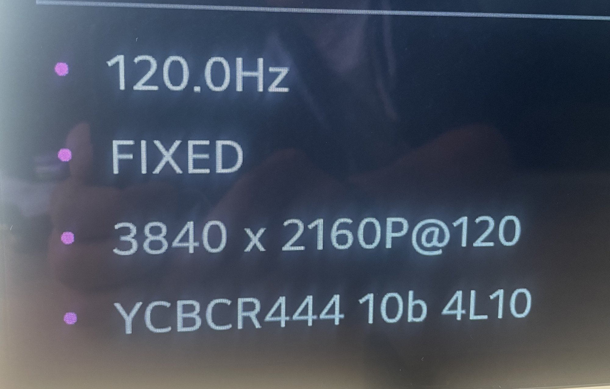

Now using the MacBook Pro M1 pro with the LG C2 42", seeing/using the 120Hz option, waking up from sleep (even with closed lid), all good. Only thing I haven't found yet: Where can I see if I get the RGB4:4:4 10b HDR? The LG menu is still confusing, at least I found that unintuitive "click the symbol and change it to PC thing" :D

I believe you click the green button on the remote 5 times?

It's now "RGB 10b 4L10" I have no idea what I did. I did change aspect ratio in LG C2 Picture Settings to Original and Just Scan to on to fix Overscan issues that I noticed. But I don't relaly notice too much of a difference from YCBCR to RGB, I may even prefer how text looks on YCBCR.
Thank you! Looks good I guess :)
