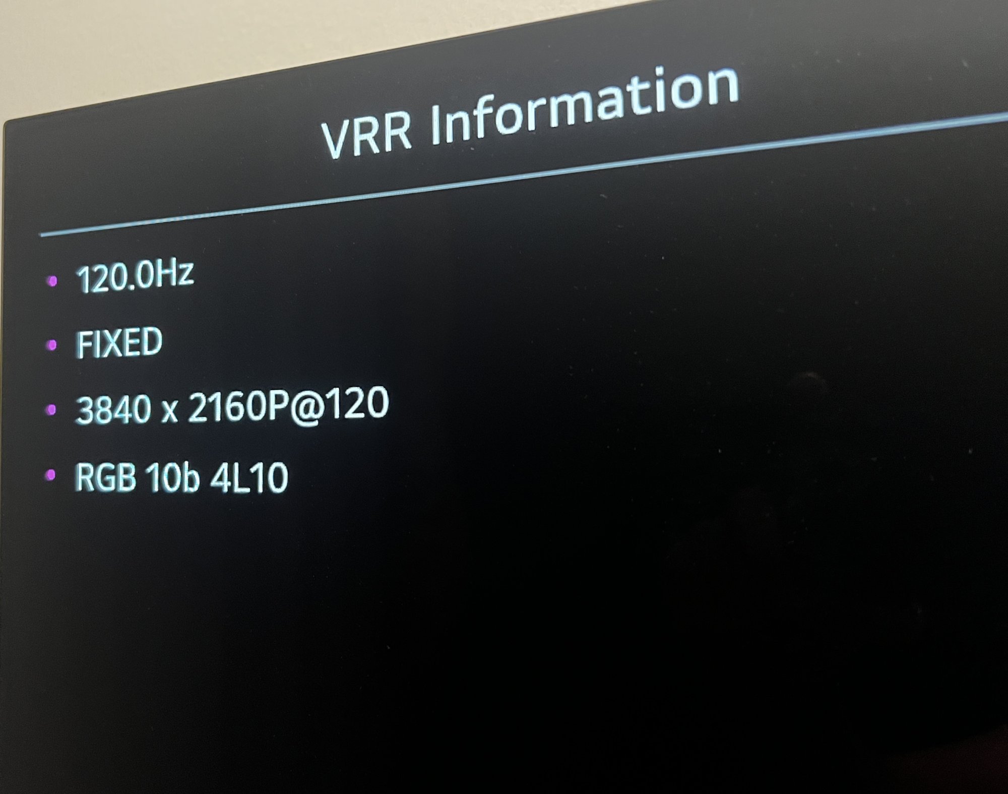

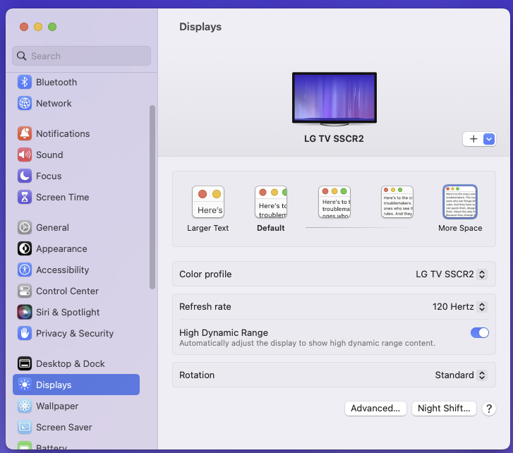

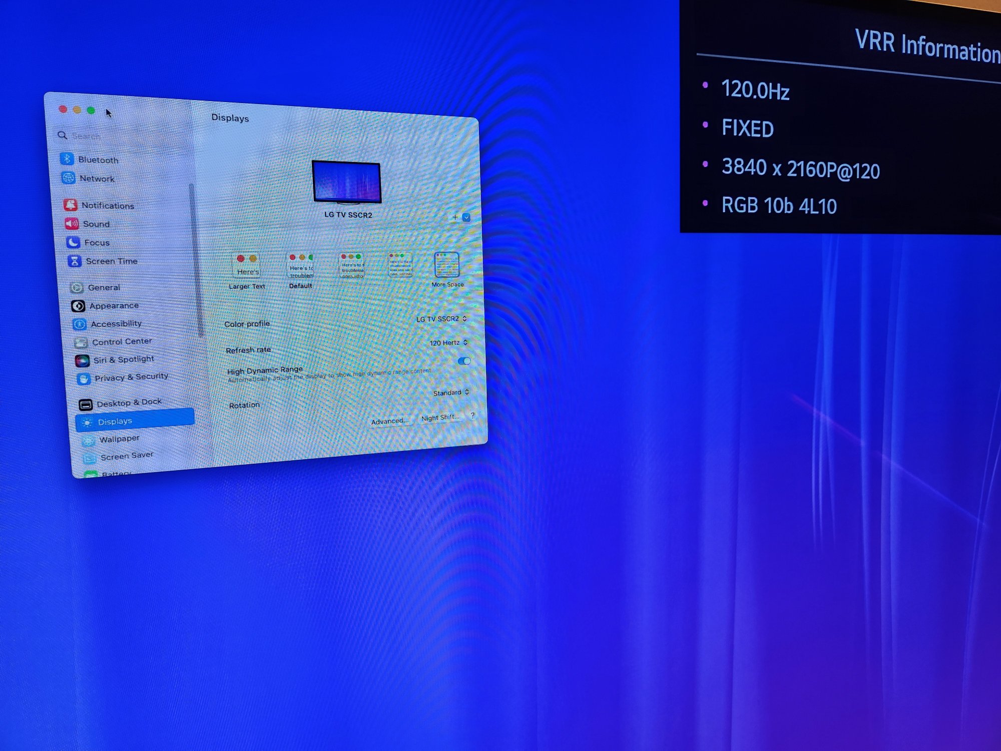

Good news! We now have a standard DisplayPort 1.4 to HDMI 2.1 adapter from cablematters. I was just provided a new firmware file from them and it works flawlessly. I am using a CalDigit TS4 dock with this adapter plugged into it's DisplayPort out. I have an M2 Max MacBook Pro with an LG CX OLED 48 inch and I am not using better display as it uses the VM7100 chip just like the USB C version. DO NOT USE THE FIRMWARE FROM THE USB C ADAPTER! It will brick your adapter. I have attached the file for the DisplayPort to HDMI adapter below and linked to the amazon link where you can purchase it. Make sure it is model 102101 before you flash this firmware and that it is using VM7100. This is great news for those of us using thunderbolt docks that have DisplayPort 1.4 as we no longer need to use an entire USB-C or Thunderbolt port just for our display out. Hope this helps!
