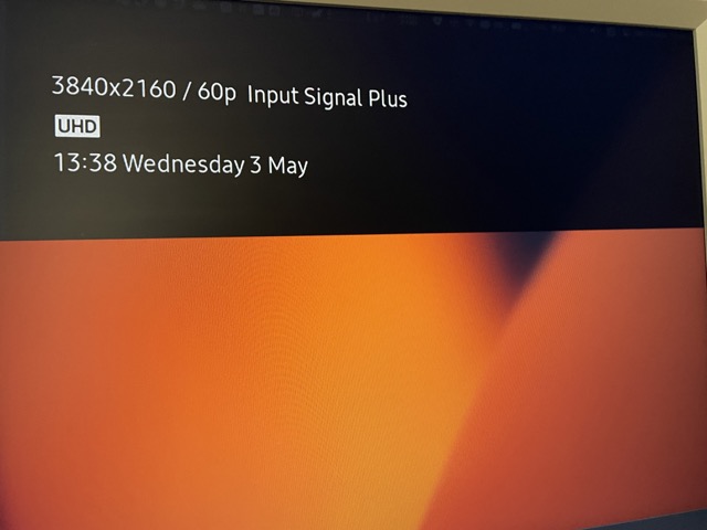

Hello everyone, BetterDisplay is suggesting that I'm only getting 4k 8b 60hz HDR on my Samsung TV, which is far from the 4k 10b 120hz I was hoping for. Based on this thread, most discussions about TV settings are focused on LG models. I'm wondering if there might be a compatibility issue with Samsung. Can anyone offer any insight or advice? Thank you in advance for your help.

- Samsung The Frame TV 2022 (with HDMI port N°4 being HDMI 2.1 for 4K 10bit 444 120Hz HDR input)

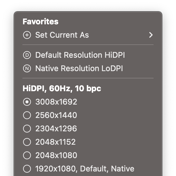

OK. For reference, when I use the following setup:
  • MBA M1
  • TB3 Dock (with a DP 1.2 Port)
  • DP 1.4 to HDMI 2.0 adapter (DP2HD4K60S)
  • KabelDirekt HDMI 2.1 cable (1 meter)
  • Samsung The Frame TV HDMI 2.1 port
BetterDisplay does suggest 10b (as shown below). This is why I thought BetterDisplay was gathering the correct display info.
> U have to check ure TV.
Sadly, I don't think Samsung TV can show detailed display information as LG TVs. All I Can get are Resolution with Refresh rate. I may have to use Test Patterns (image / video) to evaluate my display.
DP2HD4K60S is an HDMi 2.0 4k@60hz device .....
Plz read the OP
Certainly, DP2HD4K60S does not suffice the purpose of attaining 4K 120Hz.
I have mentioned this adapter since in terms of color depth, with DP2HD4K60S, BetterDisplay has suggested 10 bits for my Samsung TV whereas with 201388-A, BetterDisplay suggests only 8 bits for the same TV. Given these facts, it may not be a bug of macOS if 8 bits show in BetterDisplay in my setup with 201388-A. However, I cannot be entirely sure.
I would not have had to deal with these nuances if there were any other simple method to find out my current color depth.
On my Pro Display XDR it's also showing 8b in most times. 10b and 8b are switching without any reason. But in ure case it looks like 8b ist limited because of bandwidth limit of your 2.0 adapter, so it can be true.

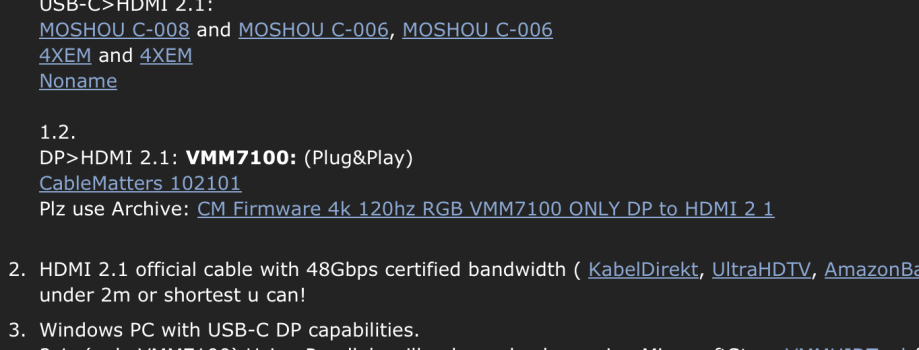

I've got the VMM7100 adapter (201388-A). I managed to update the firmware using Parallels and the VmmHIDTool from Microsoft Store - it's now showing Spyder_fw_DP_CM, version 7.02.112. The issue is that after the FW update, my LG C2 just shows "No signal". LG's Input is set to PC, adjusting the BetterDisplay connection management settings shown on the OP did not help, the TV is not found by Mac at all.
Is this maybe an issue with the cable, or did I miss something else? I have a 2 meter HDMI 2.1 "8k" cable which works fine @ 120hz on a PC though, seems like it should be fine here too...
EDIT: Yay, got it working! I used the older 7.02.102 firmware from this post. It's now 120hz with YCBCR444 8b 4L8 - seems great, not sure if it could be better somehow with the new firmware? Thanks to everyone involved with this!
