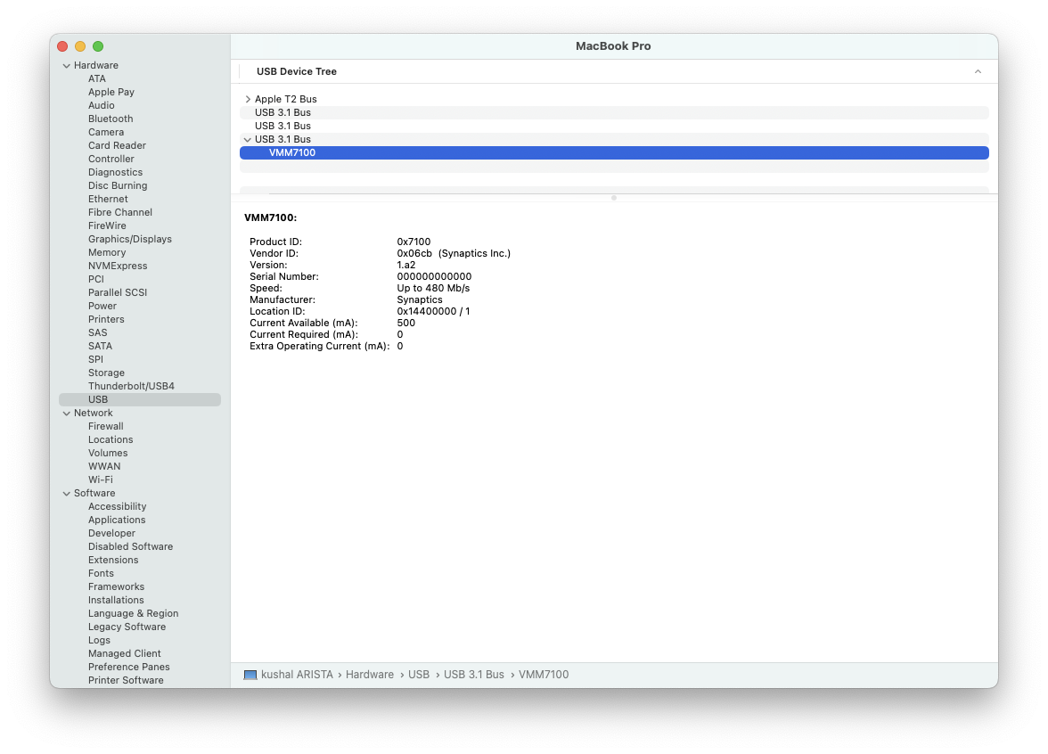

Is there a thread for intel based Mac. I tried with the following setup:
Details:
  • 16-inch, 2020 and 13-inch, 2020 Two Thunderbolt
  • macOS Ventura 13.4.1
  • Gigabyte AORUS FO48U
  • HDMI cable is OK because I use the same cable for PS5 which outputs 4K@120 HDR.
  • CABLEDECONN USB C USB3.1 to HDMI 8K 2.1 Cable [can confirm that its a VMM7100]
I didn't do anything firmware related, I just plugged everything.

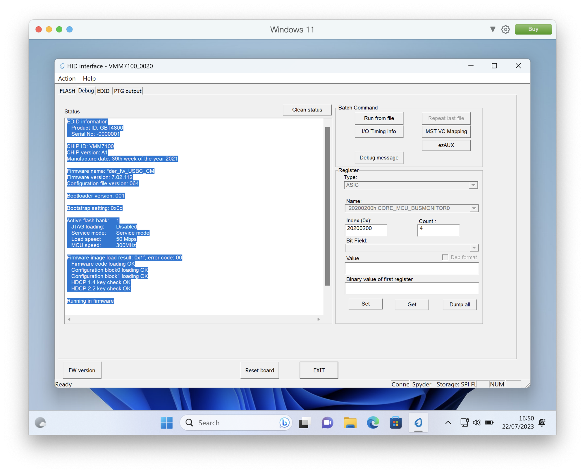

Update: I tried flashing the firmware using Paralles + VMMHIDTOOL but the display doesn't come up afterwards. I think I bricked the adapter 😭. I did back up the original firmware by going to FLASH > SAVE TO FILE; however while writing the backup firmware to the same adapter, I get invalid signature error.
Picture of FW Status after flash:
Details:
Try with other firmware from cablematic (a model like your cable) and try tv connection again
