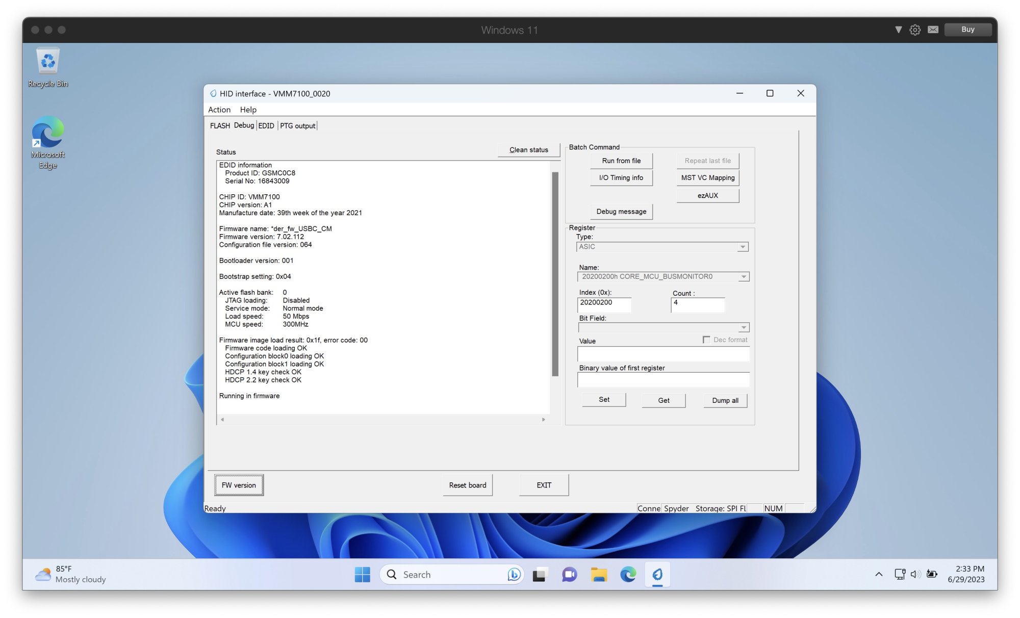

Okay, my turn! 😅
• M1 MacBook Pro
• Cable Matters 48Gbps HDMI Video Adapter (201428), which CM says should work for all of this because it's VMM7100.
• Parallels + Windows 11 (all up to date)

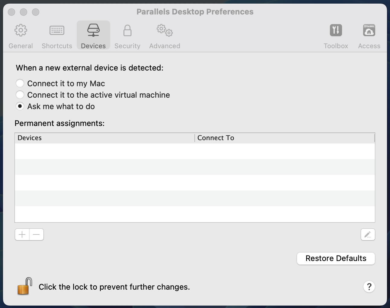

The adapter does not show up in Preferences > Devices. Not even my monitor show up. BUT connecting the adapter + an HDMI 2.1 cable (tried a couple, Including one I KNOW runs 4K 120hz) to the Mac makes my LG C2 work just fine.
@AironMan @NGHTCRWLR @davidawolf @eltron Any ideas? What am I missing?
TYIA!
Reactions: dabotsonline

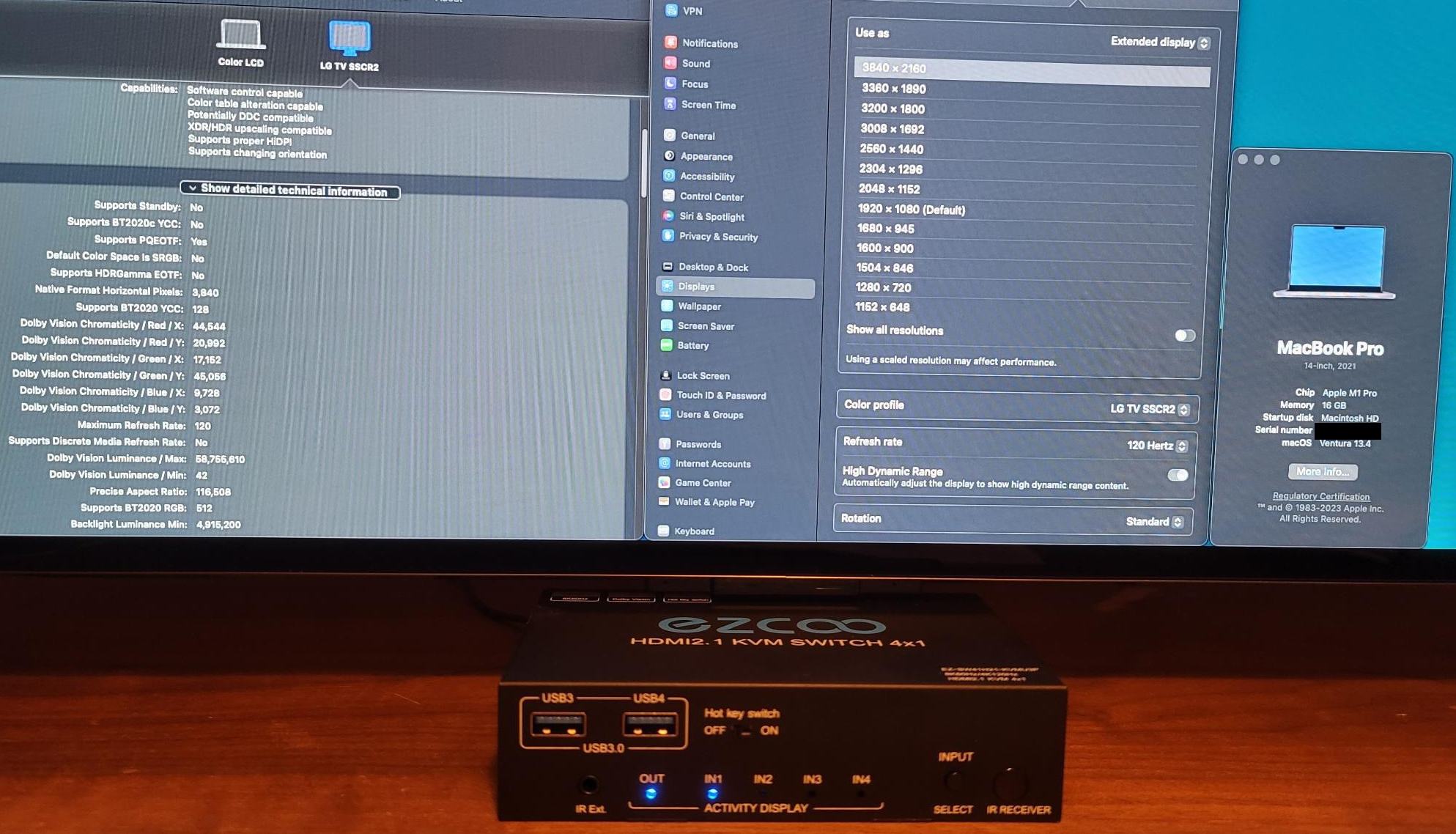

Surprisingly, this seems to work perfectly with an "ezcoo" HDMI 2.1 KVM switch thrown into the mix. I got the 4 port model, not really expecting it to operate at 4k120hz+HDR (given the warnings about finicky cables and this being some Ali-expresque brand), but it worked right away, with 3ft Amazon Basics "48Gbps" cables.
M1 MacBook Pro 14 -> VMM7100 -amzn hdmi-> ezcoo KVM -amzn hdmi-> LG C2 42" M1 MacBook Max 16 -> VMM7100 -amzn hdmi->
It even works with a couple Thunderbolt 3 docks. The CalDigit TS3 was limited to 60hz, but an intpw TB3 dock somehow runs at 4k120hz with HDR.
Hope this helps someone out there.

View attachment 2219511Okay, my turn! 😅
• M1 MacBook Pro
TYIA!

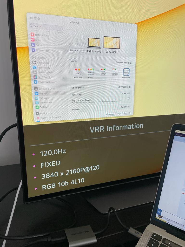

Great news from my end!
I have managed to get 4K@120Hz RGB 10bit and HDR on both my LG C1 and Dell G3223Q with just a firmware update – as expected from VMM7100!
I have used the CableMatters 201428-GRY adapter (HDMI 2.1 + USB-C PD 100W) which has the VMM7100 chip, and was said that it doesn't work. Well turns out it works... but with its own firmware which I am attaching and sadly flashing only on a Windows PC, so the Parallels trick doesn't work – @djlythium @AironMan

Glad that adapter works! It’d be a great single-plug solution for me. I could never get Parallels to work, and I don’t have access to a PC with usb-c DP alt mode. BUT Cablematters offered to flash the adapter for me! 👏🏼👏🏼👏🏼 I sent it to them, they’ll flash it, then send it back, and it should be GtG. 🤞🏼

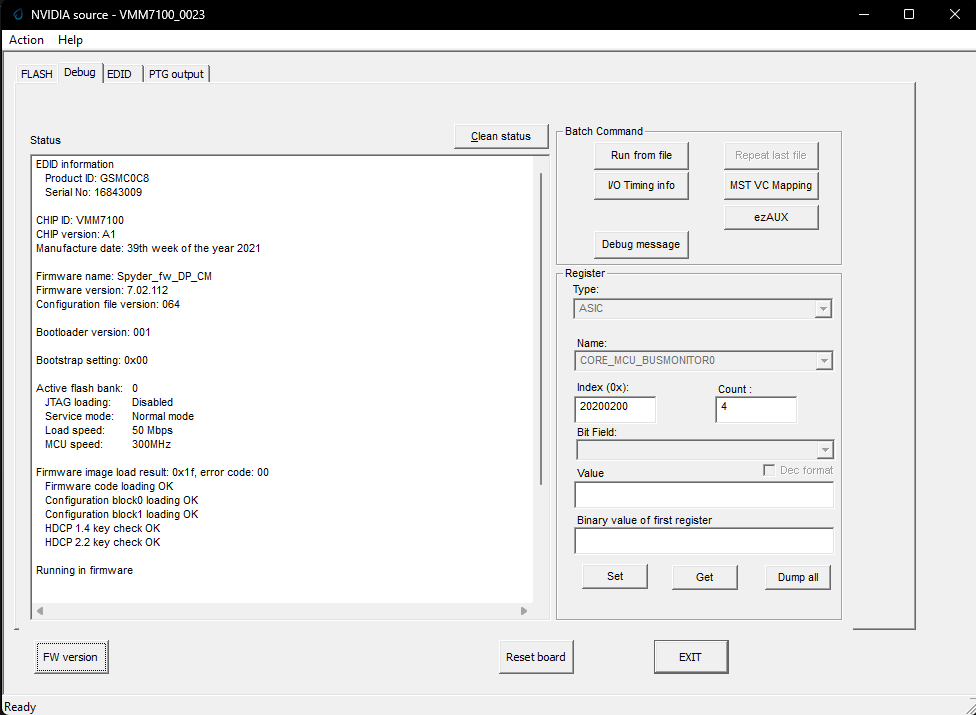

If you're not connected to a display, the flashing software simply won't launch, it won't be able to find the chip. You don't have to connect to a 120Hz TV, just any external HDMI display. It doesn't matter if it's OLED or TFT, 60Hz or 120Hz, HDR or SDR, as long as it can display HDMI, you should be good. But you won't be able to confirm the 10-bit HDR 120Hz without having access to such a device.
For clarity, this is only true when using VMMDPTool. If you use VMMHIDTool from the Microsoft store, it will find the board as long as it is connected to the USB port, regardless if there is a display attached or not.
