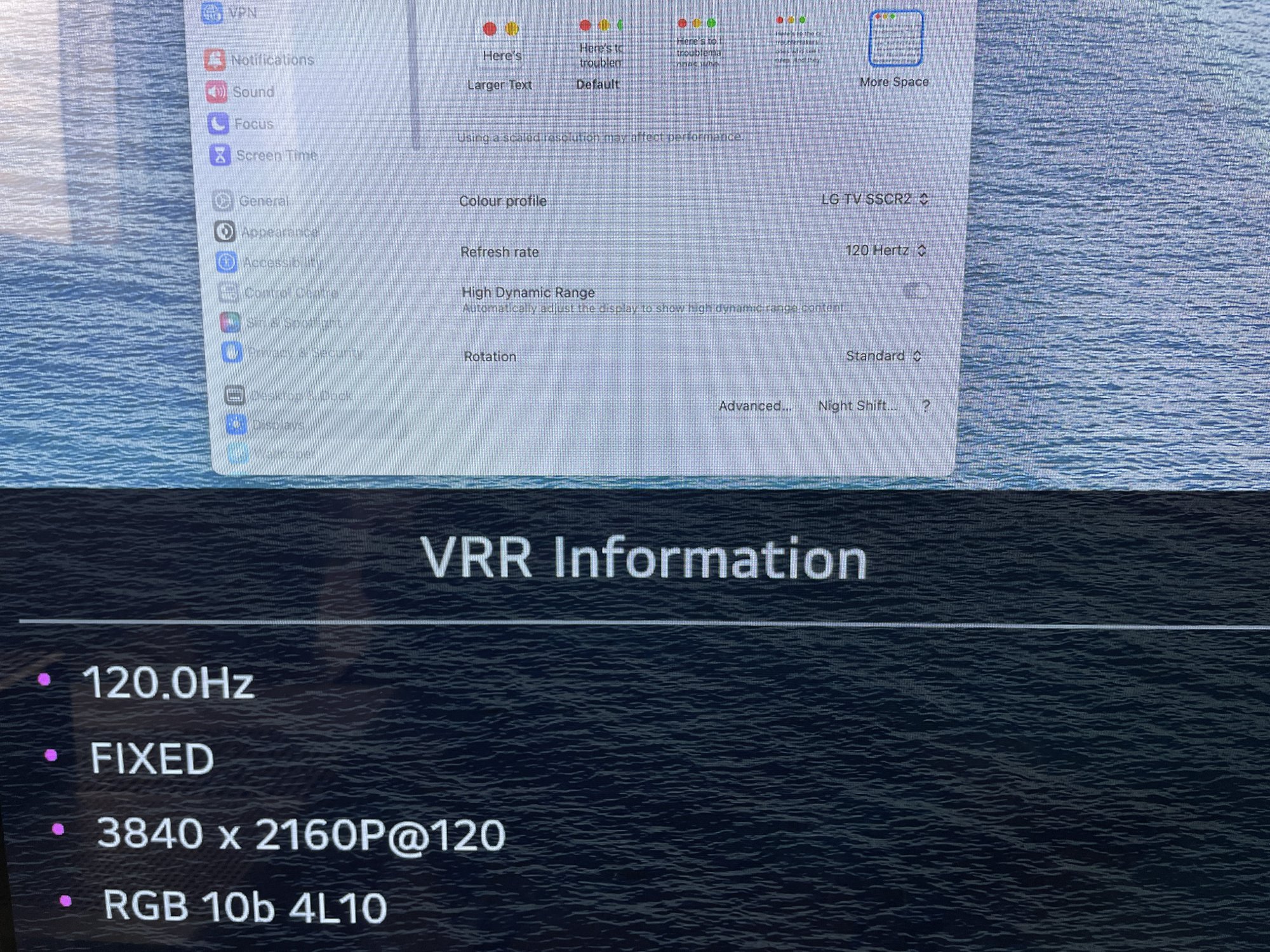

Thank you all SO much for the combined efforts and work on this issue!
I just found this thread two days ago while doing a random Google search to see if this was still an issue. An Apple Support thread linked to this thread. After much reading, decided to try this all out.
- 16" MacBook Pro M1 Max
- LG GX 65" OLED
- Anker USB-C-HDMI 2.1 Adapter (VMM7100-based) purchased from Amazon US here (https://www.amazon.com/dp/B0BG56WQN9?psc=1&ref=ppx_yo2ov_dt_b_product_details)
- Certified HDMI 2.1 Cable I already have installed in-wall for my TV
My current TV/HDMI cable is for testing purposes only. I am in the market for a 42" C2, but wanted to get the Anker adapter and flash it first.
Used Parallels Desktop 18 with a fresh Windows 11 install. Used the tool from the Windows Store that is noted in OP.
Backed up the default firmware
Flashed VMM7100 from the OP
Set LG's HDMI input to PC, turned on Deep Color.
Everything aside from VRR (as was noted) works perfectly, including HDR.
As noted, after firmware upgrade, it is now Plug and Play with no EDID modifications necessary.
Thank you, thank you, thank you! An equivalent display with DP costs many hundreds of dollars more in the US right now, plus these LG TVs are fantastic. Now I can go for the 42" C2!
Future step is to purchase a CalDigit TS4 and use the DP method, however that's on the backburner for now as I already have a TS3 Plus and can't see the need to immediately get the TS4 at this point.
This has been a very long time coming, thank you so much again!

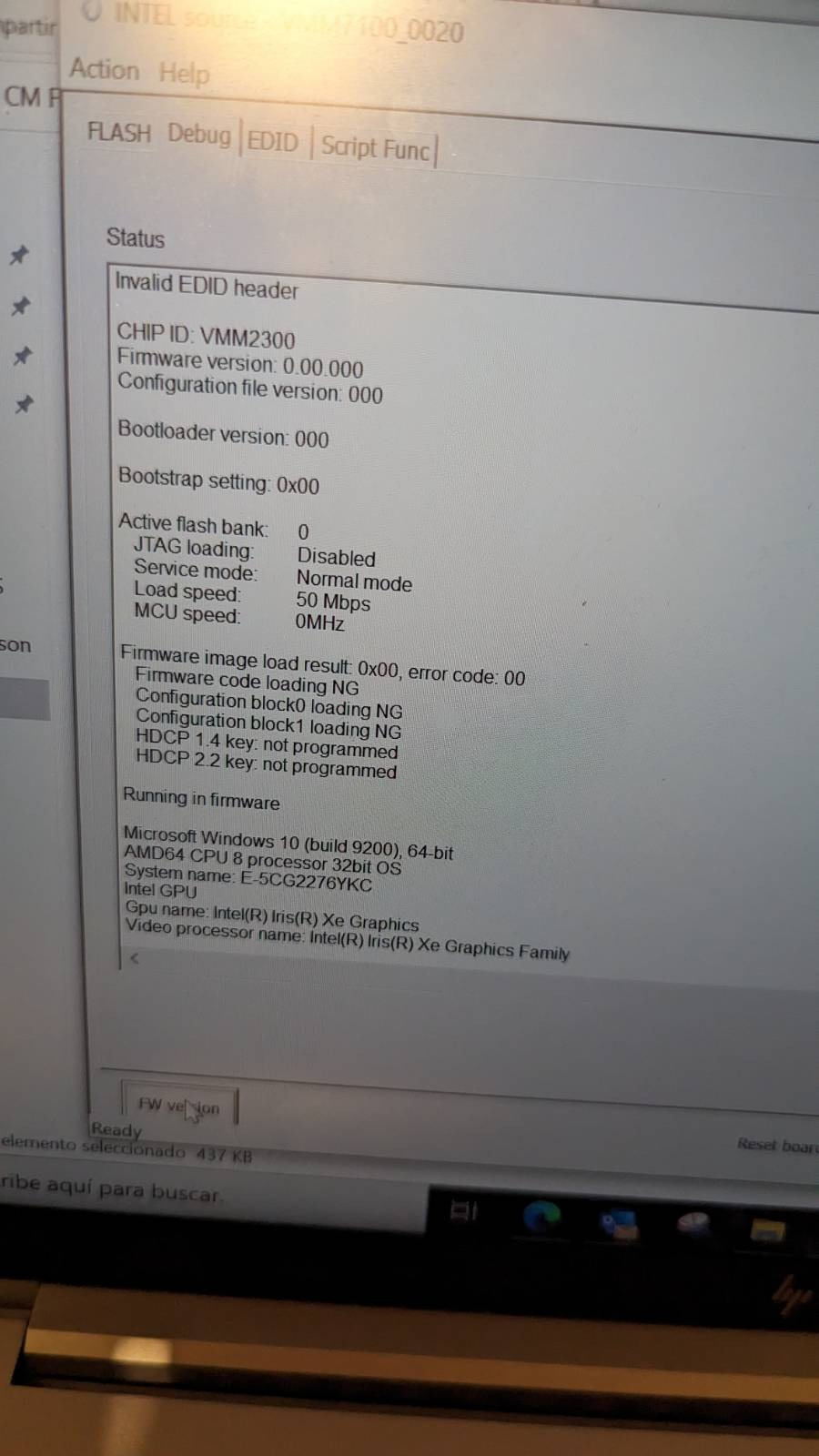

So... I bought this cable, the '8k' version. Then I used the direct dp to hdmi firmware version. And there was this mistake. The one in the image attached. Now the cable does not output any image, and when I try to run the vmmdptool says that 'can not find synaptics mst dp hub ic'. How ****ed I am? Is the cable bricked?
This was before:
This was after.

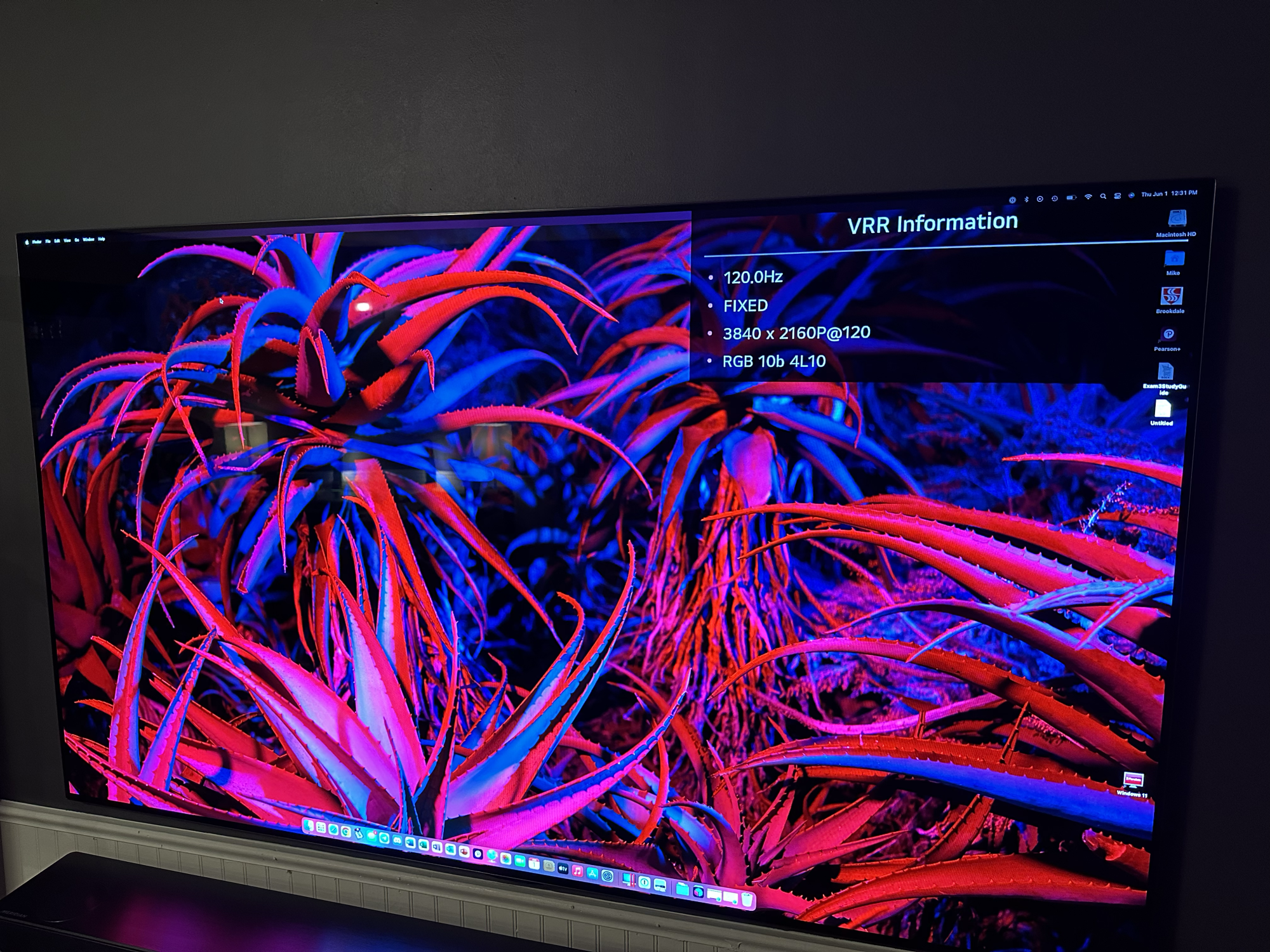

I got 120hz working perfectly on my lg c1 with 4:4:4 RGB! Has anyone had success in getting VRR to work?

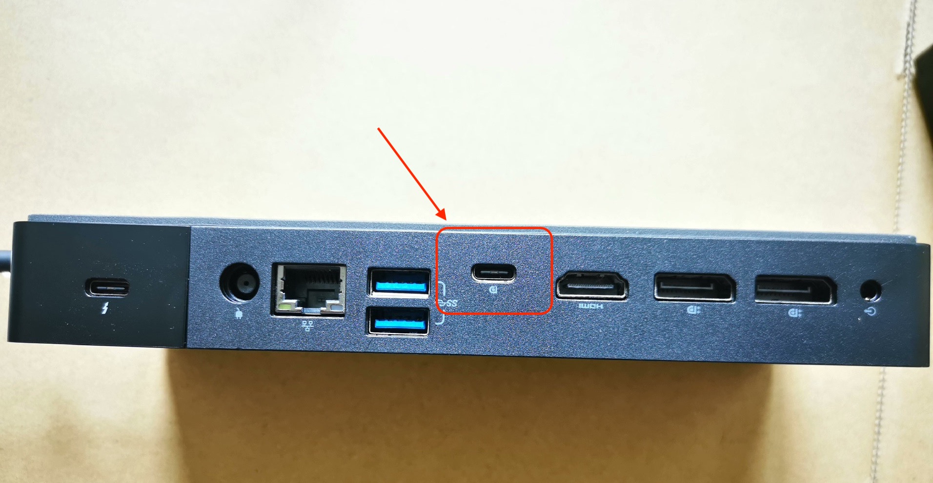

MacBook Pro M1 Max + Dell WD19TB Docking Station was able to output 4K@120Hz on my LG C2 TV after updating the CM VMM7100 adapter firmware.

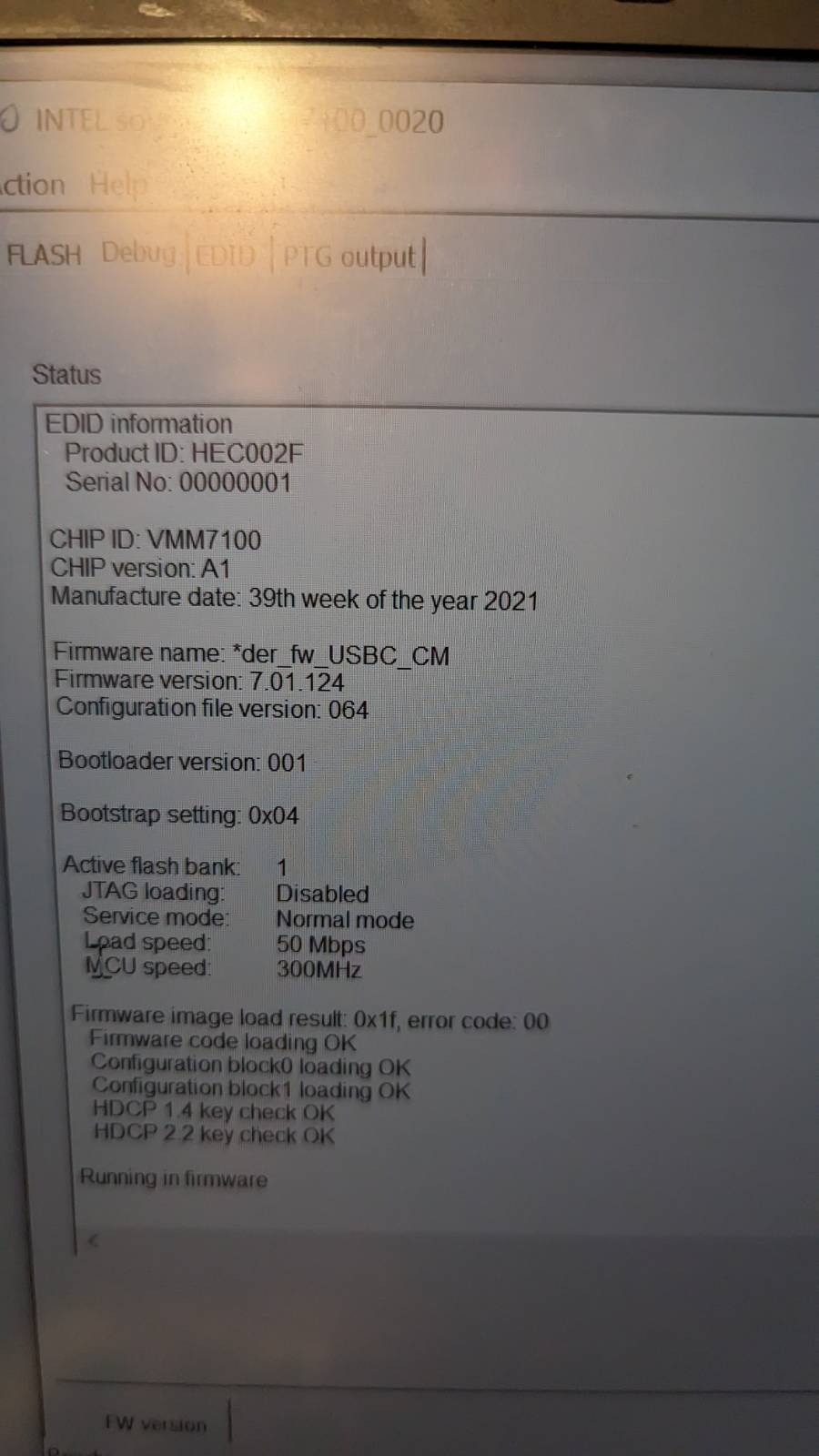

For someone accidentally flash the wrong firmware on the CM VMM7100 adapter (ex. DP to HDMI instead of Type-C to HDMI). You can recover it using VmmHIDTool from the Microsoft store.

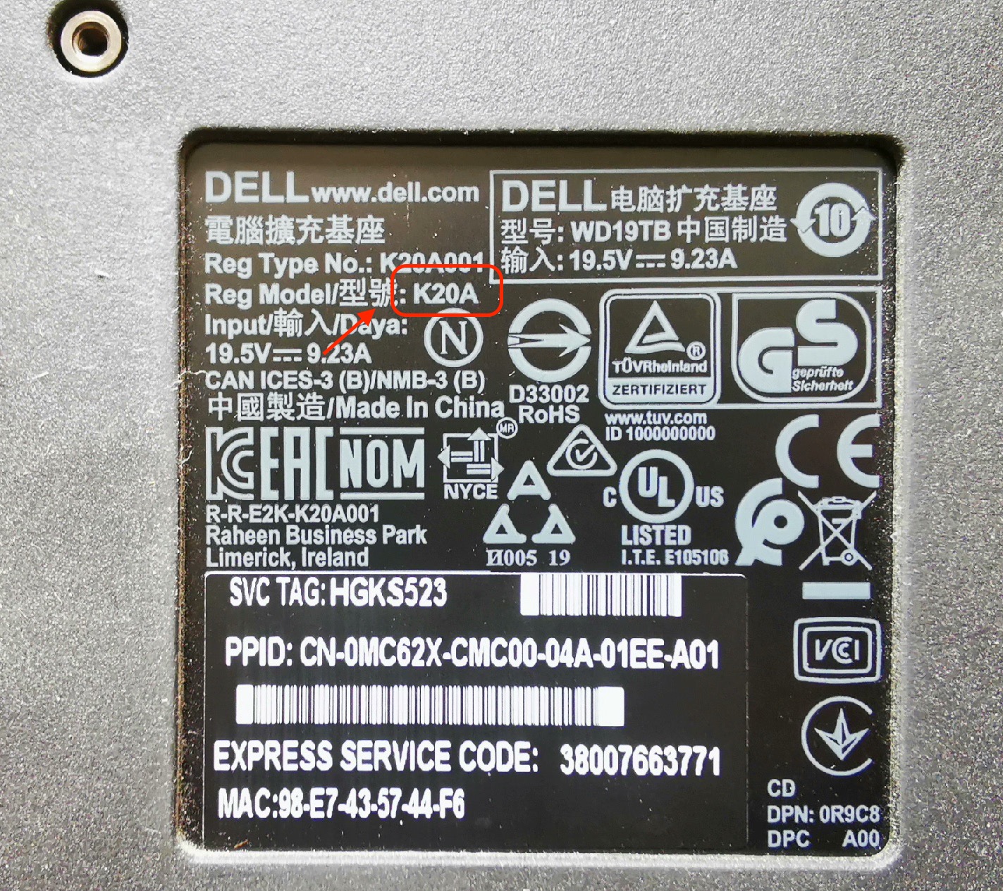

Thanks for your information. Is K20A the model name of WD19TB you are using? Which Type-C port are you using to connect the Type-C adaptor (Is the type C port marked with DP sign on the back panel?)

Incredible, I was able to repair the "bricked" Cable Matters adapter where I flashed the wrong firmware.
I downloaded VmmHIDTool from the Microsoft store (https://apps.microsoft.com/store/detail/vmmhidtool/9PDS6MLXXS7S?q=uva) and it worked, I was able to flash the correct firmware and now I have two working adapters at 10bit 120Hz!
Those who have accidentally bricked their adapter, try to flash from the Microsoft Store version of the software.
