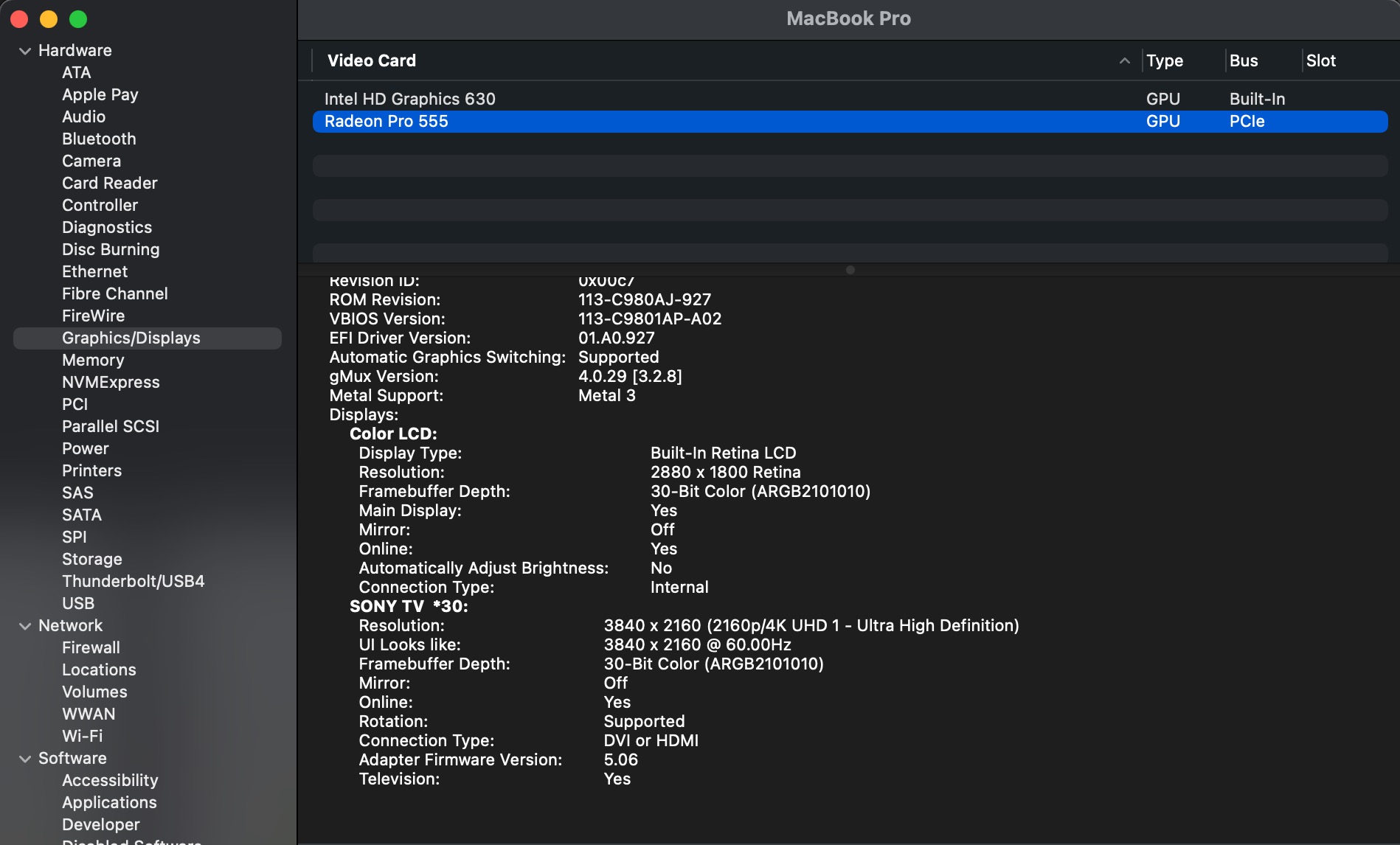

2017 15" MacBook Pro with 2Gb Radeon Pro 555 running latest Ventura 13.4
An AllRez dump will tell you how its possible to get 4K@60Hz RGB 10bpc with just DP1.2/HBR2 x2. It's probably using 4:2:0 but that would require using the 529MHz timing and I though 4:2:0 would only be used with HDMI timings so something interesting is happening here or your mistaken about one of the numbers which is why I asked.
Your AllRez dumps so far only show 4K60 529MHz modes using 8bpc 444 which is the limit of HDMI 2.0 which has more bandwidth than HBR2 x2.
I only use one external display and all dumps came from it (known as Sony TV *30). I haven't made any display changes and not sure how to check the timings. Upon plug in of usb-c dock cable, 2017 Intel Mac defaults to 4K@60 RGB 10bpc for Sony TV * 30 as displayed and Lenovo Hack defaults to 4K@30Hz RGB 10Bpc. Even without VMM7100 adapter and TV connected directly to HDMI 2.0 port on dock.
Ok, comparing AllRez output for the Lenovo hack and the Radeon Pro 555 MBP will show why one can do 60Hz and the other can do only 30Hz with the same HBR2 x2 connection limit. Is the Lenovo hack using Intel HD Graphics 630? Perhaps it doesn't support 4:2:0 since it only supports DisplayPort 1.2?
If you conclude 10bpc because System Information.app says 30bpp, then that's wrong. System Information.app only reports the resolution (3840x2160), color space (RGB), and depth (30bpp) of the framebuffer. They have nothing to do with the output resolution, color space, or depth.

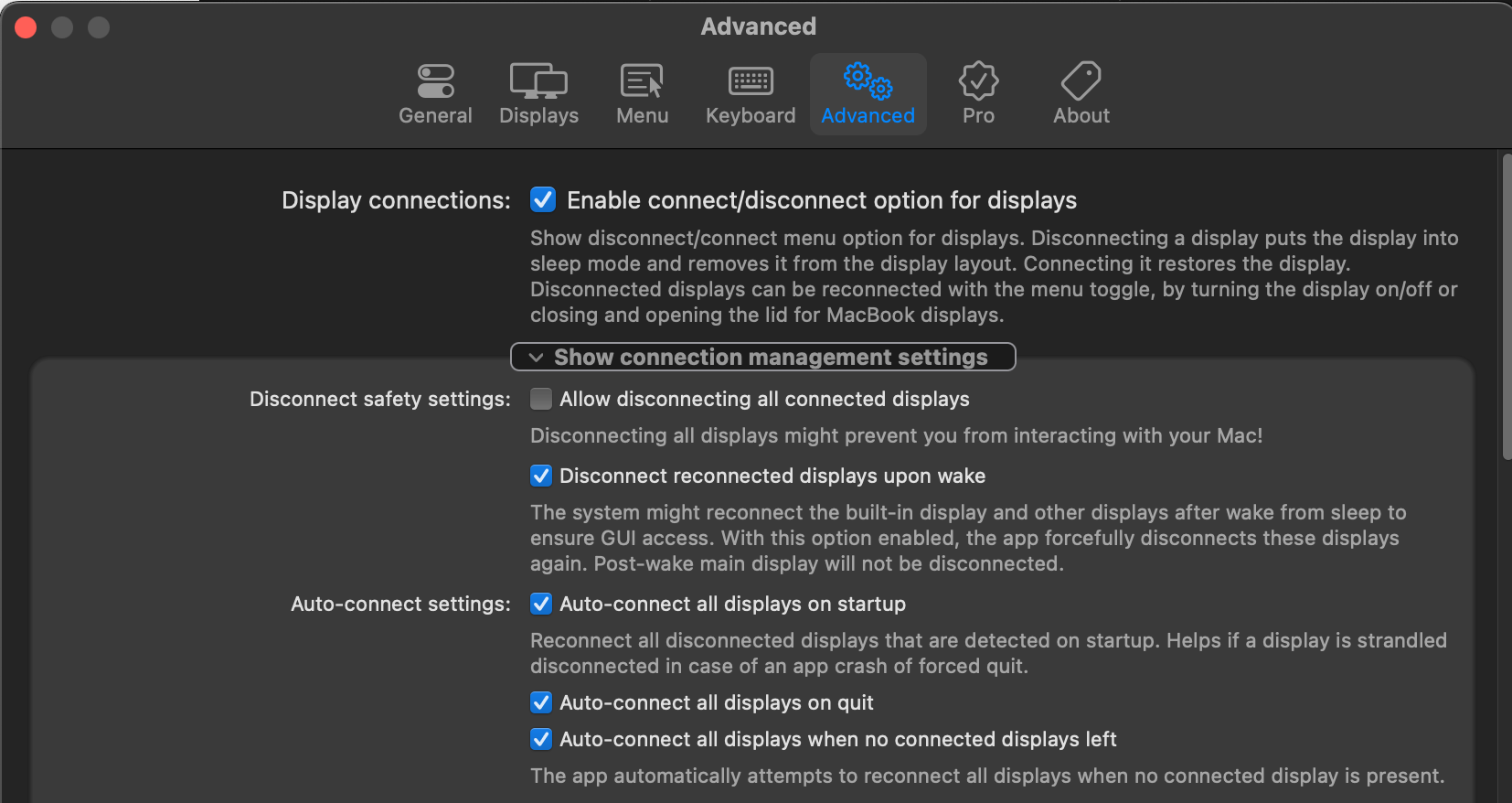

MONITOR WAKE PROBLEMS:
Monitor not want to wake can be fixed with this settings in BetterDisplay:
( On my side(VMM7100 with TB4 Dock) it works better when i switch of this function!! )
@AironMan what does this mean? Having issues when Mac goes to sleep, monitor does not wake up unless I unplug i plug back in.
Do you use the settings in the screenshot? Or did you disable the "Enable connect/disconnect option for displays" option?
Reactions: Brenyo

I got the CableMatters 201388-A = VMM7100, flashed the firmware (successful, 100% completed). Disconnected and reconnected, but it's bricked now. It no longer has any video connection, and running the tool again displays "Can not find Synaptics MST DP hub IC". I used a Dell XPS laptop, connected to the charger. I guess there's nothing I can do now. I'll try to get the Anker model.
Has anyone had an issue with HDR video playback in the Photos app being washed out? It looks HDR video being played on a non-HDR screen. YouTube HDR looks normal.
I bought the Anker dongle listed in the OP. I plugged it in but only 4k 60hz, so I thought it needed the new firmware. Downloaded the firmware and updated it with the guide. It said the update went fine and the dongle still shows up but it doesn't allow display output anymore under Mac OS. Not sure if I did something wrong or what, does anyone have any other firmware I should use?
I got video out working again with VMM7100_4kRGB120hz10b_V7_02_112.fullrom and it says it has the firmware on it but still no 120hz.
Started working after rebooting a few times not sure why it wasn't working at first, awesome though have had this working on PC since I got my RTX 3080 in 2020 and have tried so many things.

Ventura 13.4 does handle better wake up monitors from standby. I disable BD wake up functions now. With my TB4 Dock I get really good results.
