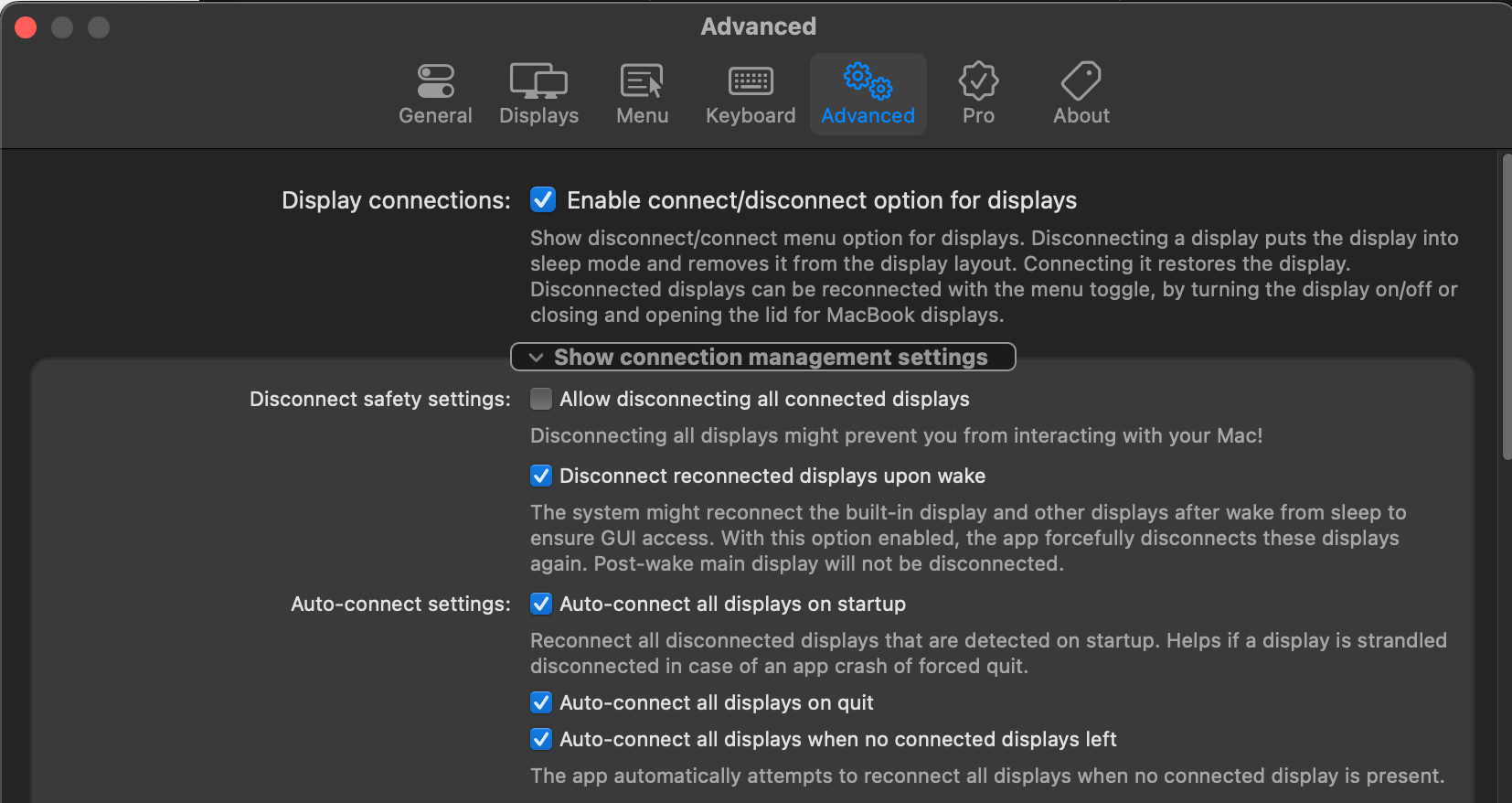

MONITOR WAKE PROBLEMS:
- Plz update to Ventura 13.4 or above
- Monitor not want to wake can be fixed with this settings in BetterDisplay:
( On my side(VMM7100 with TB4 Dock) it works better when i switch of this function!! )

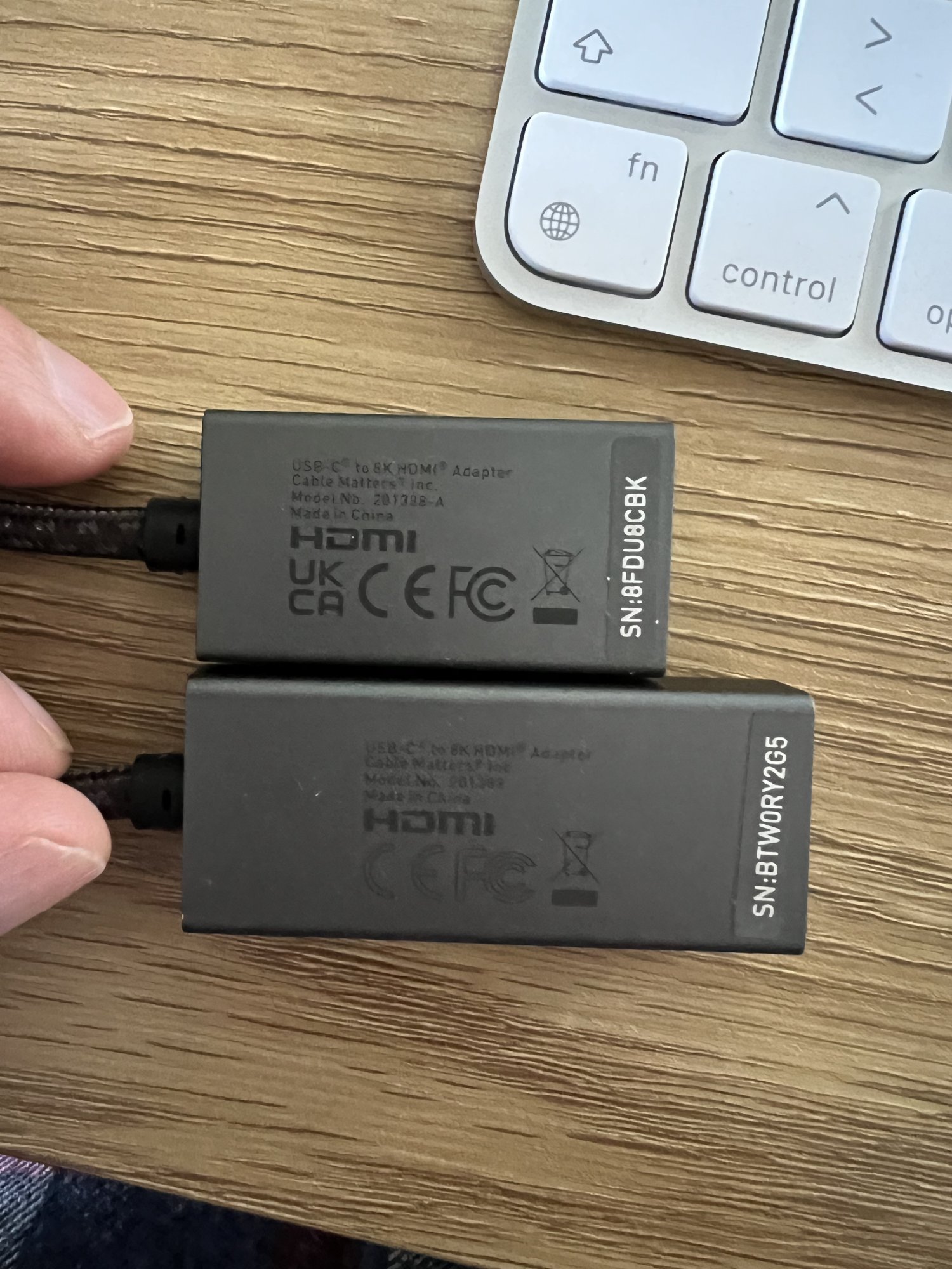

It was 201388-GRY (VMM6100) 😢
