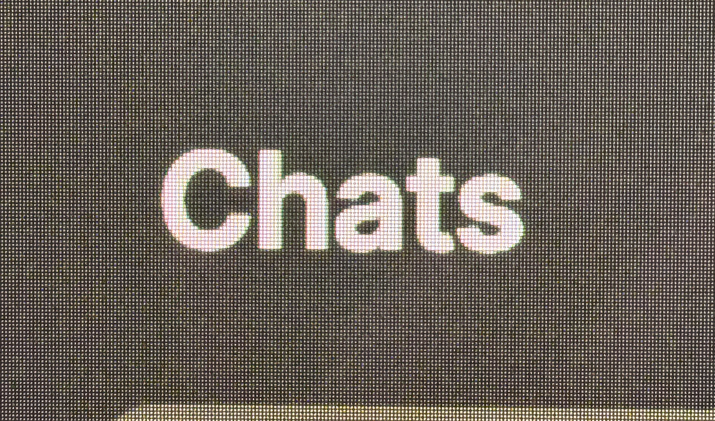

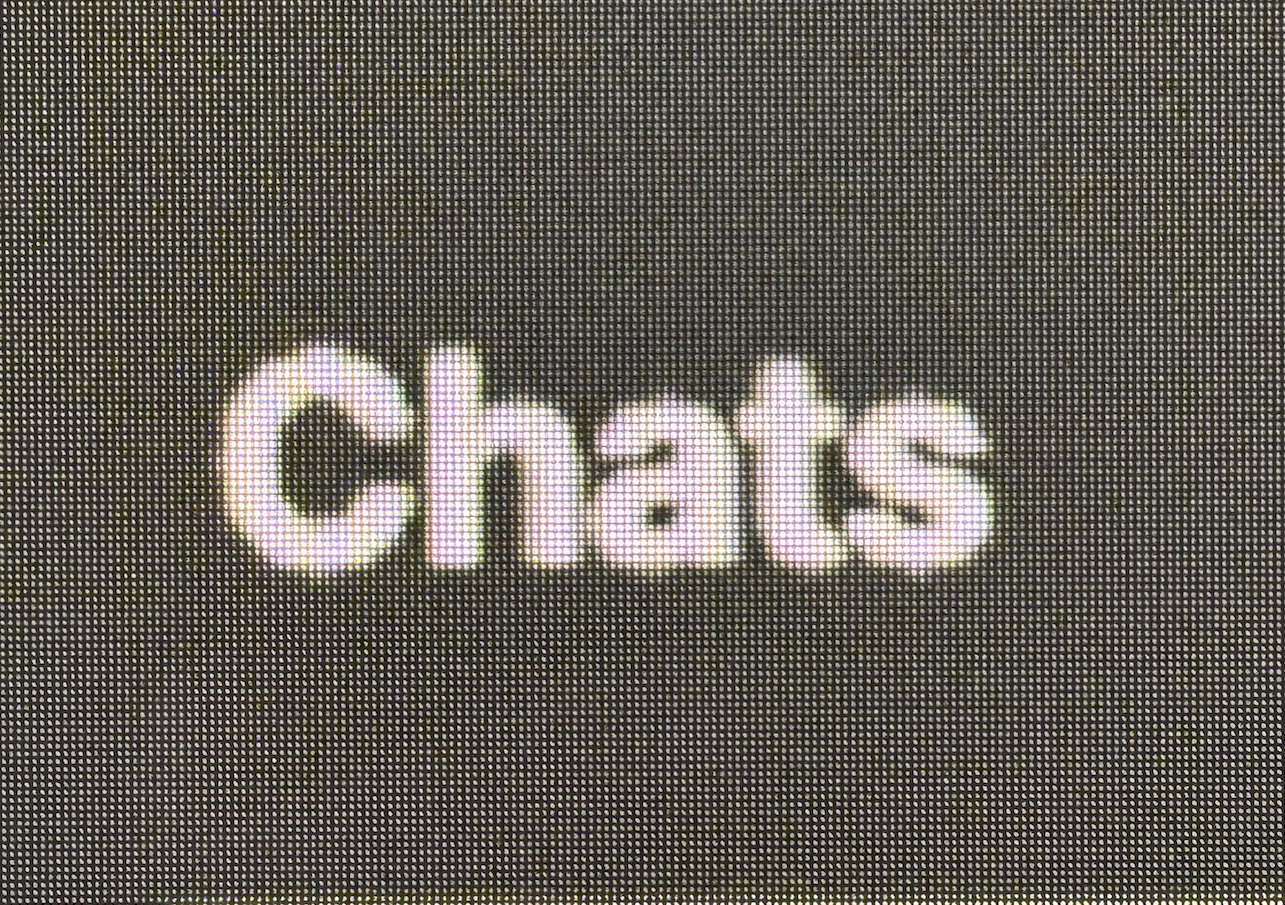

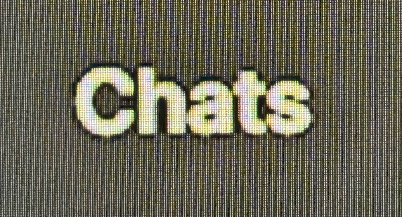

Hi!
I've been using the original method and the VMM6100 for a while. I've been using it with an LG CX 48" with the native 4k resolution of
but 4k native doesn't make use of Mac's scaling to make everything look "retina", so I wanted to try HiDPI resolutions.
It also works fine with 1920x1080 HiDPI mode, and looks really sharp. But at 60hz.
When I try to use it with 1920x1080 HiDPI at 120hz, it looks like the normal LoDPI.
Examples:
1920x1080 HiDPI, 60hz: Looks sharp, as expected
1920x1080 LoDPI, 120hz: Doesn't look sharp, but that's expected as it's LoDPI
1920x1080 HiDPI, 120hz: Doesn't look sharp, it should look like the 60hz one, it changes a bit from the LoDPI but doens't look good:
All pictures taken at the same distance from the screen, with an iphone 15 pro.
Mac studio running Sonoma 14.1. Always using SDR as I don't use HDR that much.

Check chroma. You are surely not running in 4:4:4 or RGB mode in that HiDPI mode.
Mash green button while on your TV remote in 120hz mode a you will see 4:2:0 or 4:2:2 chroma.
Which produces these kind of artifacts.

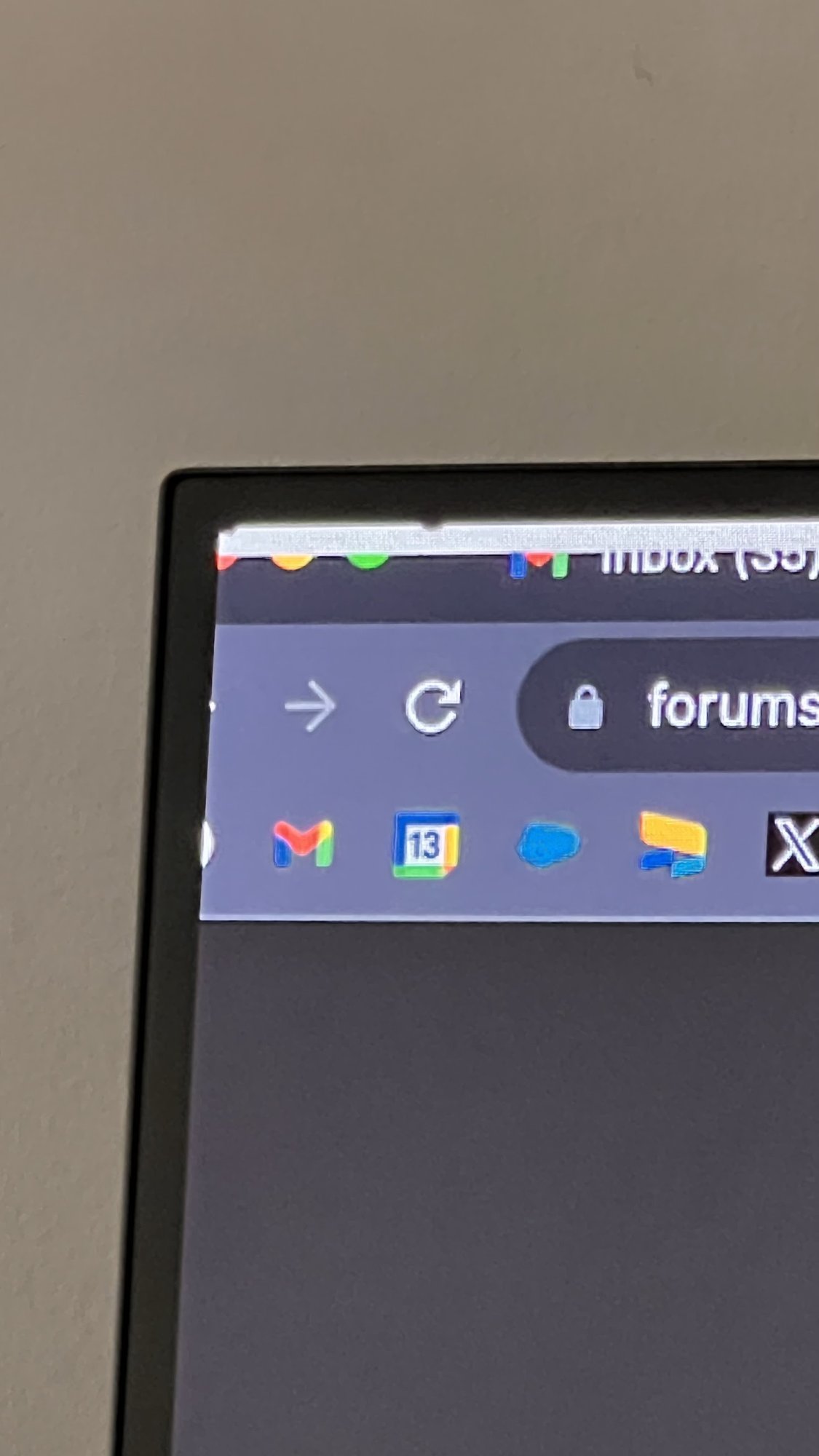

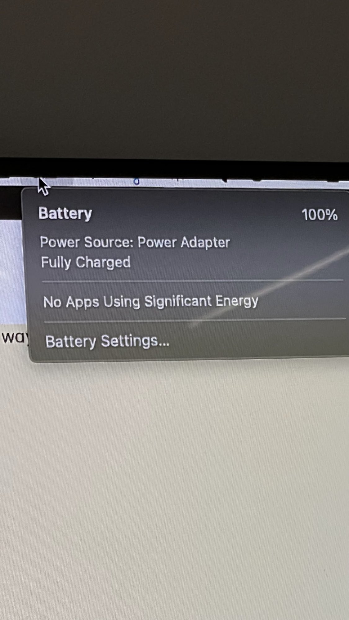

Hi all, first of all thanks for the guide, yes it worked quite well. At least I got 4k AT 120Hz, with a minor flaw. I don't know if this is related to this workaround but whenever I use usb-c on my MAC to connect to LG C2 42", resolution doesn't really fit. If I switch to traditional HDMI Port, it's just perfect, except being 60Hz.
Any idea what's missing here? Probably I'm missing a settings somewhere. attaching a photo sowing the edges of the monitor and how screen is not a fit, even I can't see the menu. this is almost same for all resolutions.

Did you put the TV into PC mode on that HDMI input?

This only happens to me when I'm not on HDMI PC mode. Unless it's the picture quality, this also seems to be evident by the artifacting/color banding I'm seeing here.
