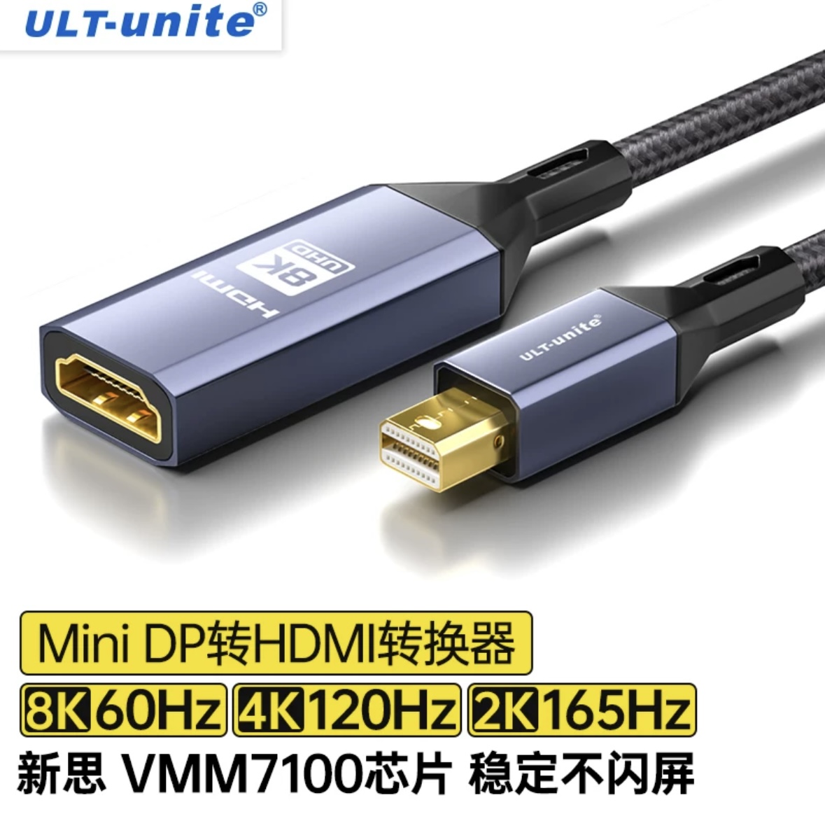

I found a mini DP to HDMI adapter with a VMM7100 chip. I wanted to ask if the mini DP to HDMI adapter can use your attached firmware "CM Firmware 4k 120hz RGB VMM7100 ONLY DP to HDMI 2 1"?
