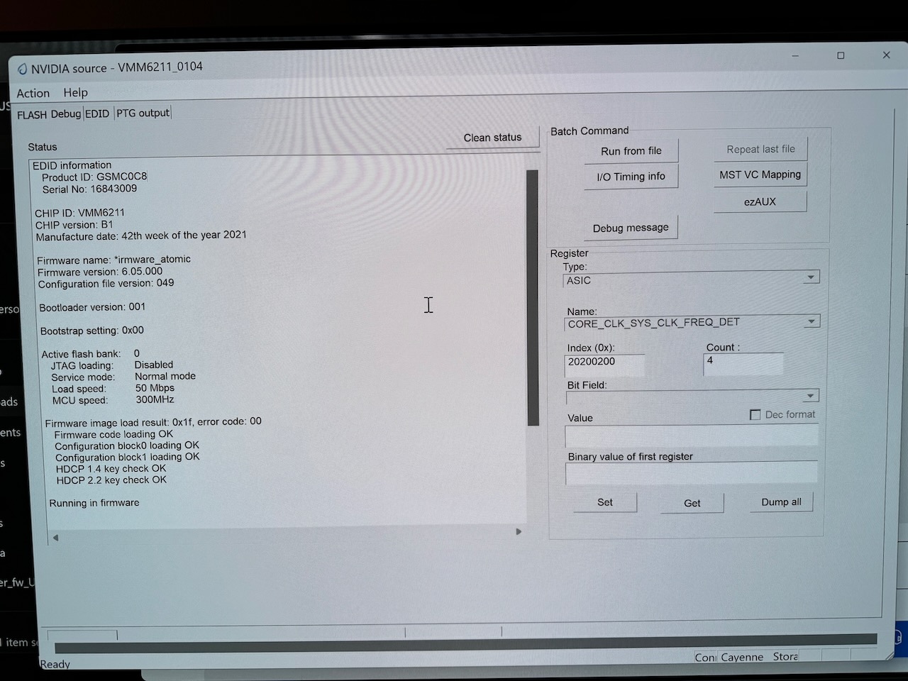

An interesting find that the Dell USB-C dock actually support 4k@120hz 10bit HDR natively on MacBook M1/M2 w/ betterDisplay.
I recently purchased this Dell HD22Q USB-C dock, It claimed only support 4K@60hz or 8k@30hz but says it's HDMI 2.1 compatible:

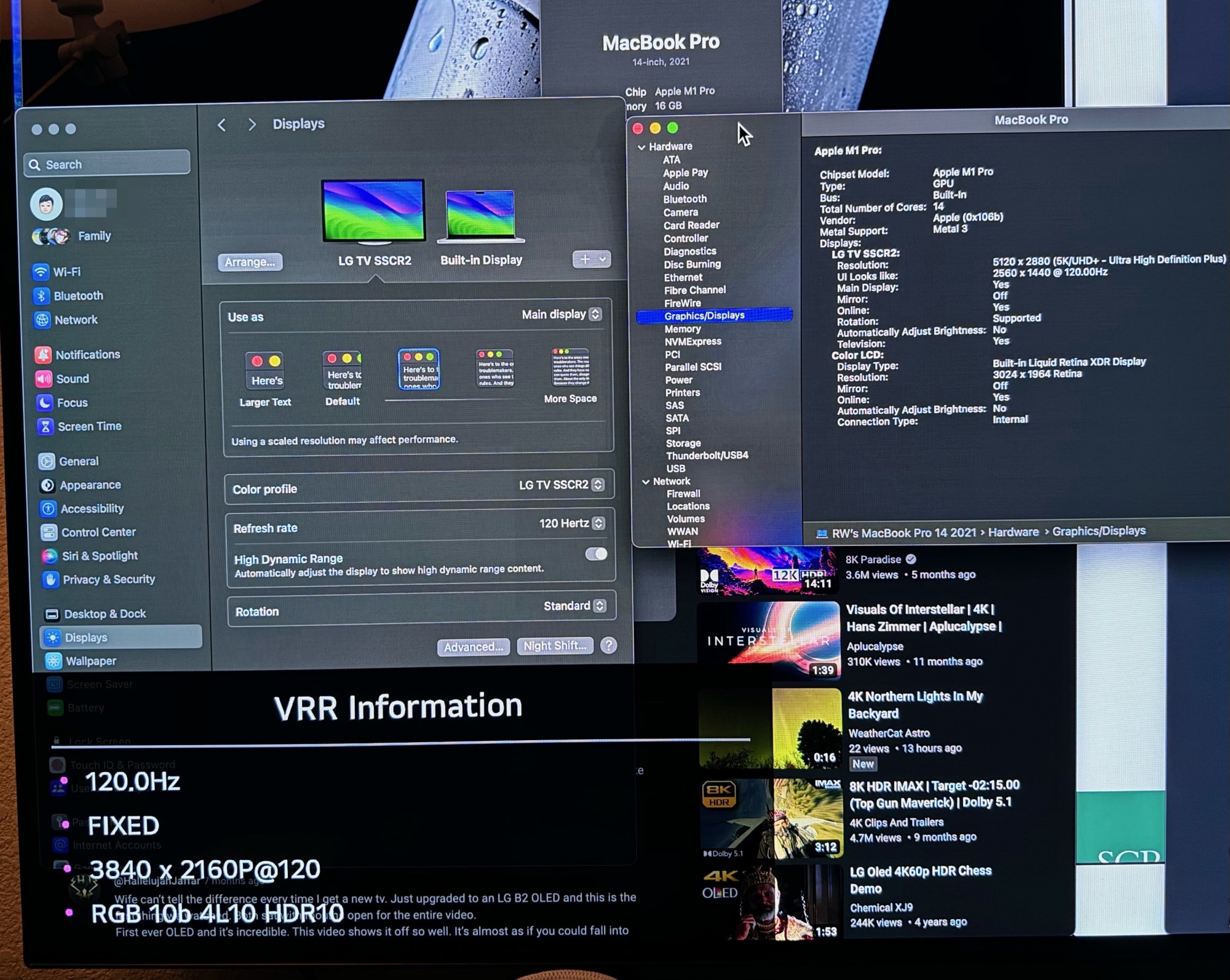

But when I hook it up with my MacBook Pro M1 Pro, it magically support 4k@120hz 10bit natively:
I thought there is no way this thing can support 4k@120hz natively given we have tried numerously way to get that working with help of custom firmware, but it's right there. without any probe or tinkering, it support 4k@120hz on my LG CX(more explain later).
Then I changed to my Windows laptop and using the tool to read what chip and firmware it use, it showed this
So looks like a VMM6211 running firmware 6.05:

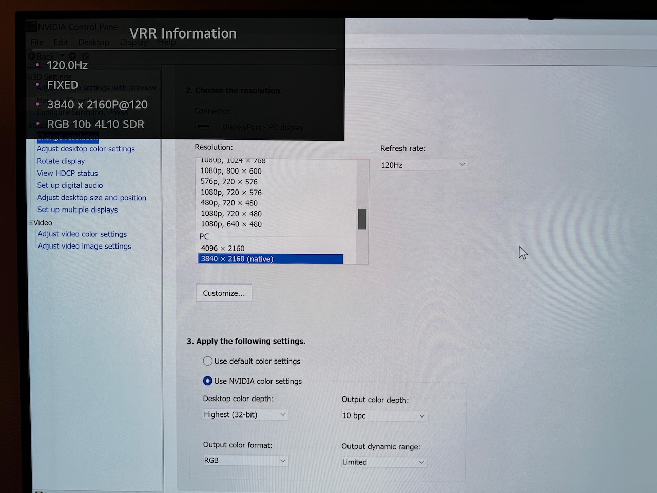

Also under Windows, it can output 4k@120hz 10bit without problem:
Since it's running VMM6211 chip, I think the reason it can output 4k@120hz under mac is because I have betterDisplay with EDID custom running at the background because my main adapter is a cable matter VM6100 adapter, so I did my due diligence back when @stevemr123 post his original method.
To verify my hypothesis, I use my wife's MacBook Air M2, which officially don't support 4k@120 10bit natively, It sure can't output 4k@120 10bit, only 4k@60 8bit output like before. But after I installed betterDisplay and created mod custom EDID file, it works again.
TL;DR:
Dell HD22Q USB-C dock can support 4k@120hz 10bit natively under Windows and MacOS(w/ custom EDID from betterDisplay), it's build on VMM6211, so for whom like to utilize more features like PD charging in a single cable/output 4k/USB ports for peripherals, this is a great choice.
Thanks @AironMan and @stevemr123 for the great work!
