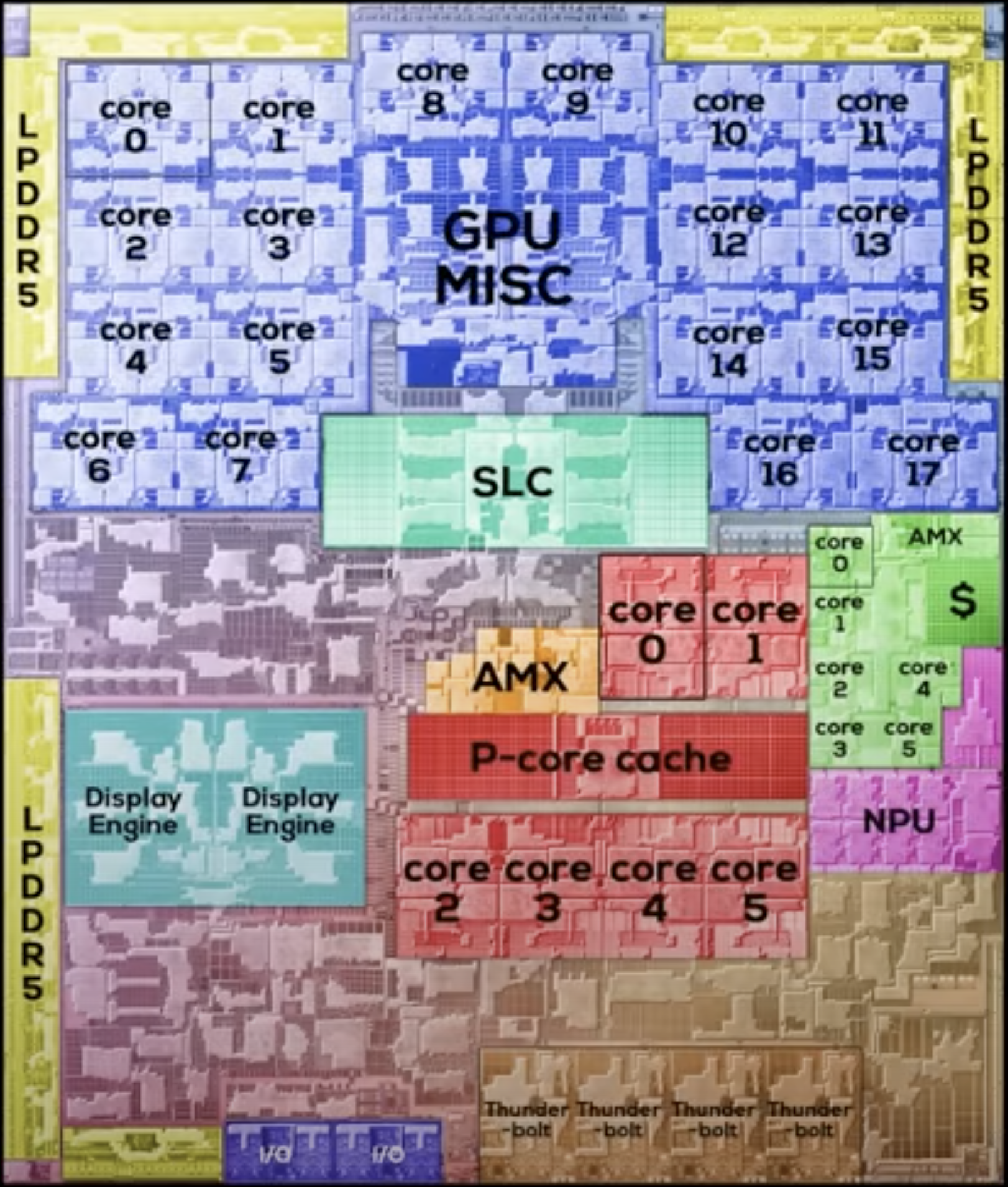

I'm wondering why, when M2/M3 Pro/Max's are driving a higher-bandwidth display (8k@60 or 4k@240), this reduces, by one, the total number of displays they can drive. That would tell us what these chips are doing in order to drive such displays.
Specifically consider the M2/M3 Pro's. Based on Apple's spec's, these can either drive two lower-bandwidth displays (2 x 6k@60 or 1 x 6k@60 + 1 x 4k@144), or a single higher-bandwidth display (8k@60 or 4k@240). [We see a similar one-display decrease when the M2 and M3 Max MBP's are driving a higher-bandwidth display.]
I pasted an annotated die shot of the M3 Pro below. You can see that chip has two external display engines, which is why it can drive two external displays. [It also has a smaller internal display engine for the laptop screen, which is not annotated.]
Why do the M2/M3 Pro's lose their ability to drive a 2nd external display when driving an 8k@60 or a 4k@240? These are the only two possibilities I can think of, but I have no idea if either one applies:
1) It's bridging the two external display engines together in order to drive that single display.
2) It needs to (and is somehow able to) internally reallocate PCIe lanes to the HDMI port when it drives a higher-bandwidth display, thus leaving it without enough I/O for a 2nd external monitor.
Maybe @joevt has some insight?
Unless someone tries it, we don't know for sure that it can't do more than one higher-bandwidth display. Apple said the Vega MPX module can't do three 6K displays but then someone tried it and it works fine.
https://forums.macrumors.com/threads/psa-pro-vega-ii-single-can-power-3x-xdr-displays.2225758/
https://support.apple.com/en-ca/101641
If there's a limit then it's either because Apple added a limit to the driver, or because the hardware is not capable. Why would Apple add a limit to the driver if the hardware is capable? Maybe the hardware is capable only in certain situations. Or maybe the performance drop or power requirements is unacceptable.
PCIe lanes has nothing to do with graphics.
#1 is a reasonable guess. If there's a hardware thingy that can handle x pixels per second and you want to do more pixels than that, then a GPU can use a second hardware thingy.
Here's something about Linux and Intel GPUs doing 8K:
https://lpc.events/event/5/contributions/317/attachments/435/689/XDC2019_8K_Trans_Port_Sync.pptx.pdf
I think there's a related YouTube video.
