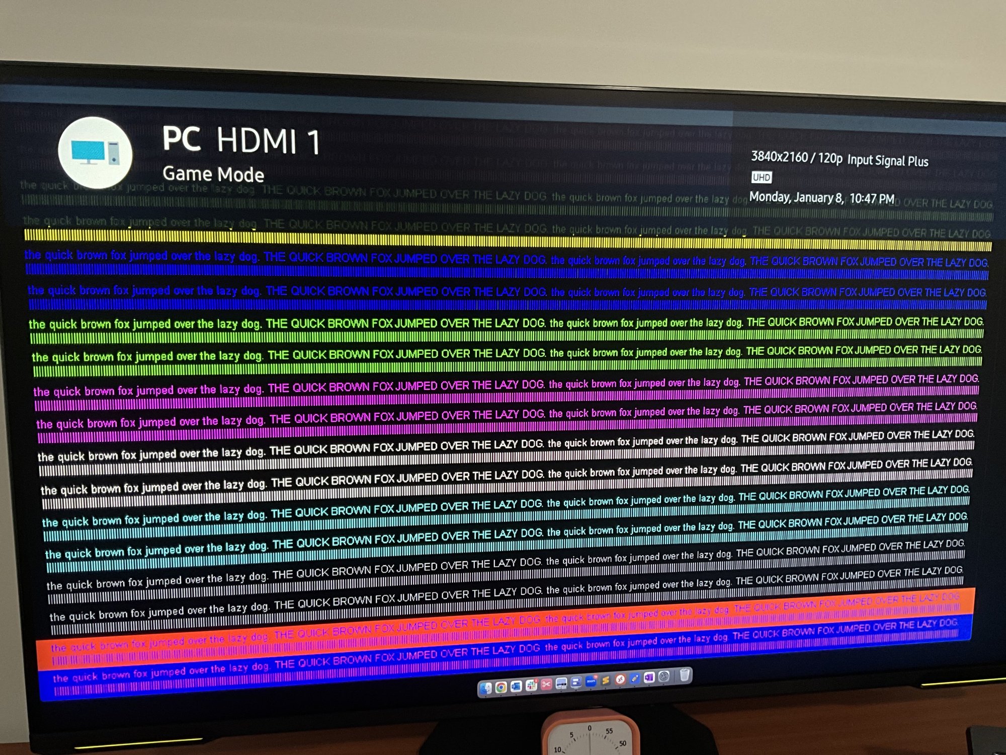

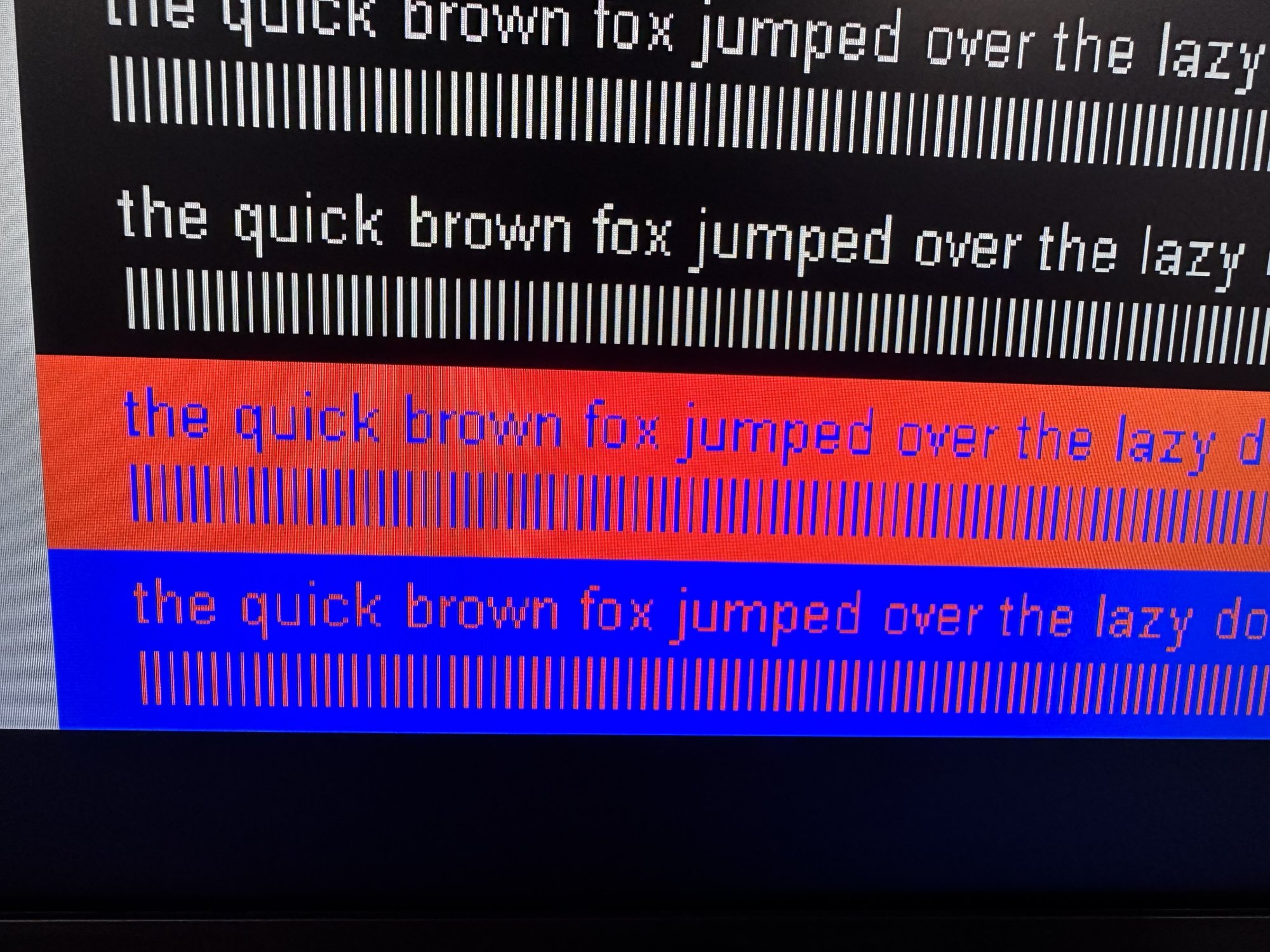

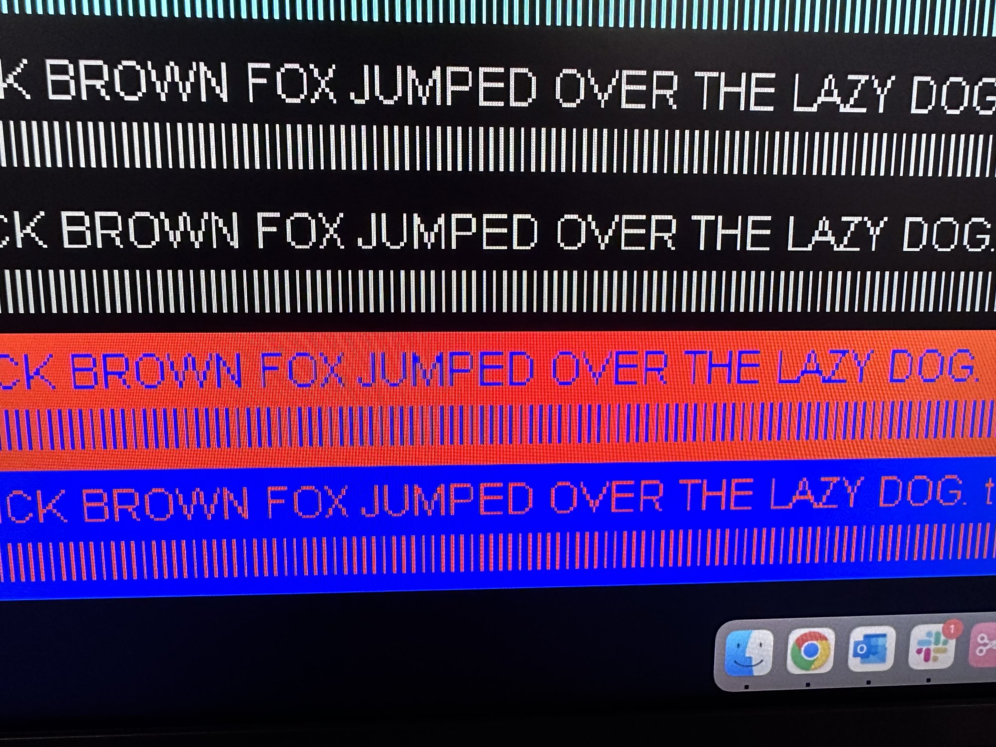

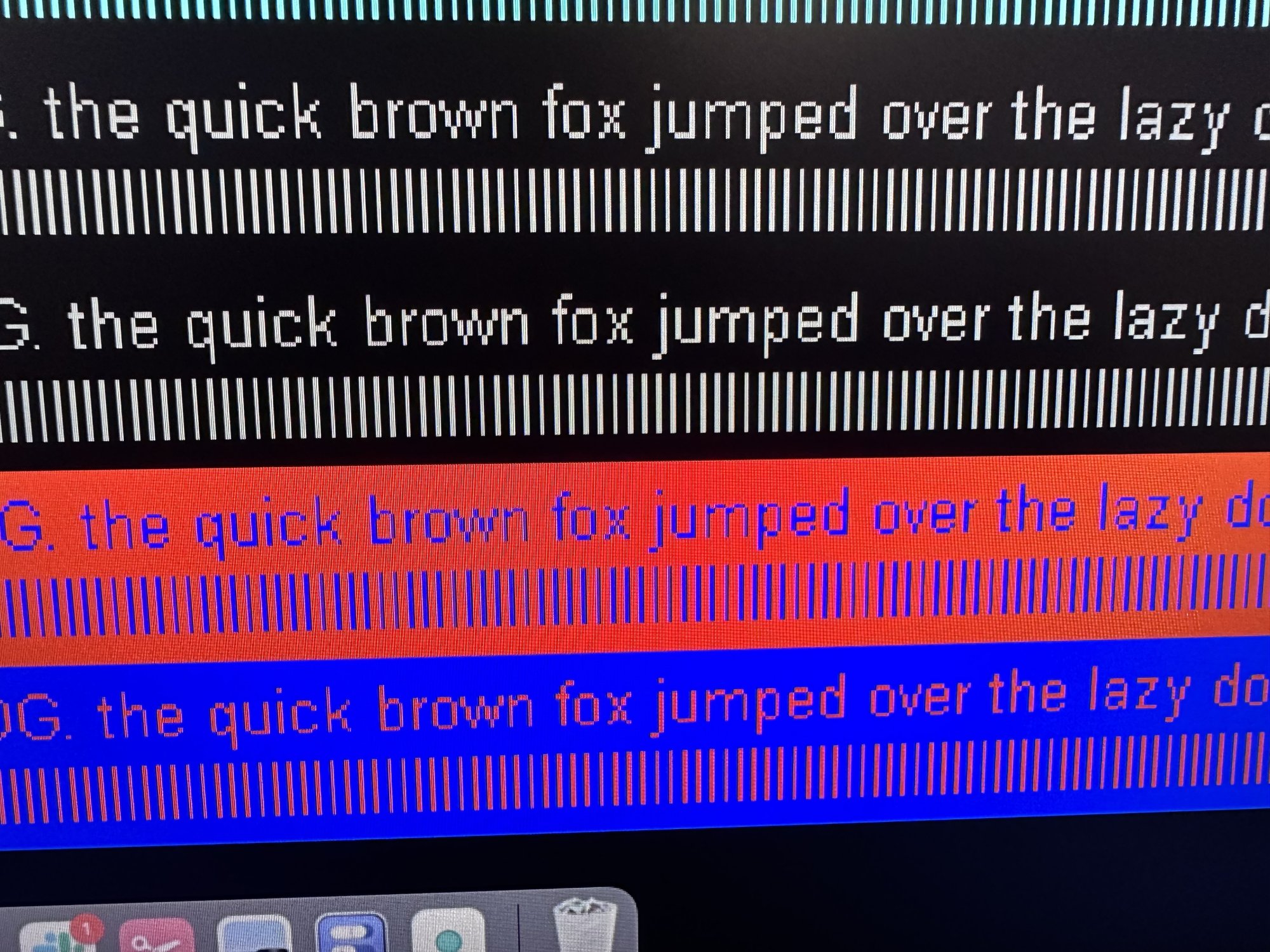

Thx, but this look like 4:2:2. This is what test and see also with the PD version. U can not reach RGB 4:4:4
Took some more photos , does this still look like 4:2:2 ? Sorry I am new to all this. What is PD Version ? I have the power connected to the USB C of the dongle. I am using the method here :

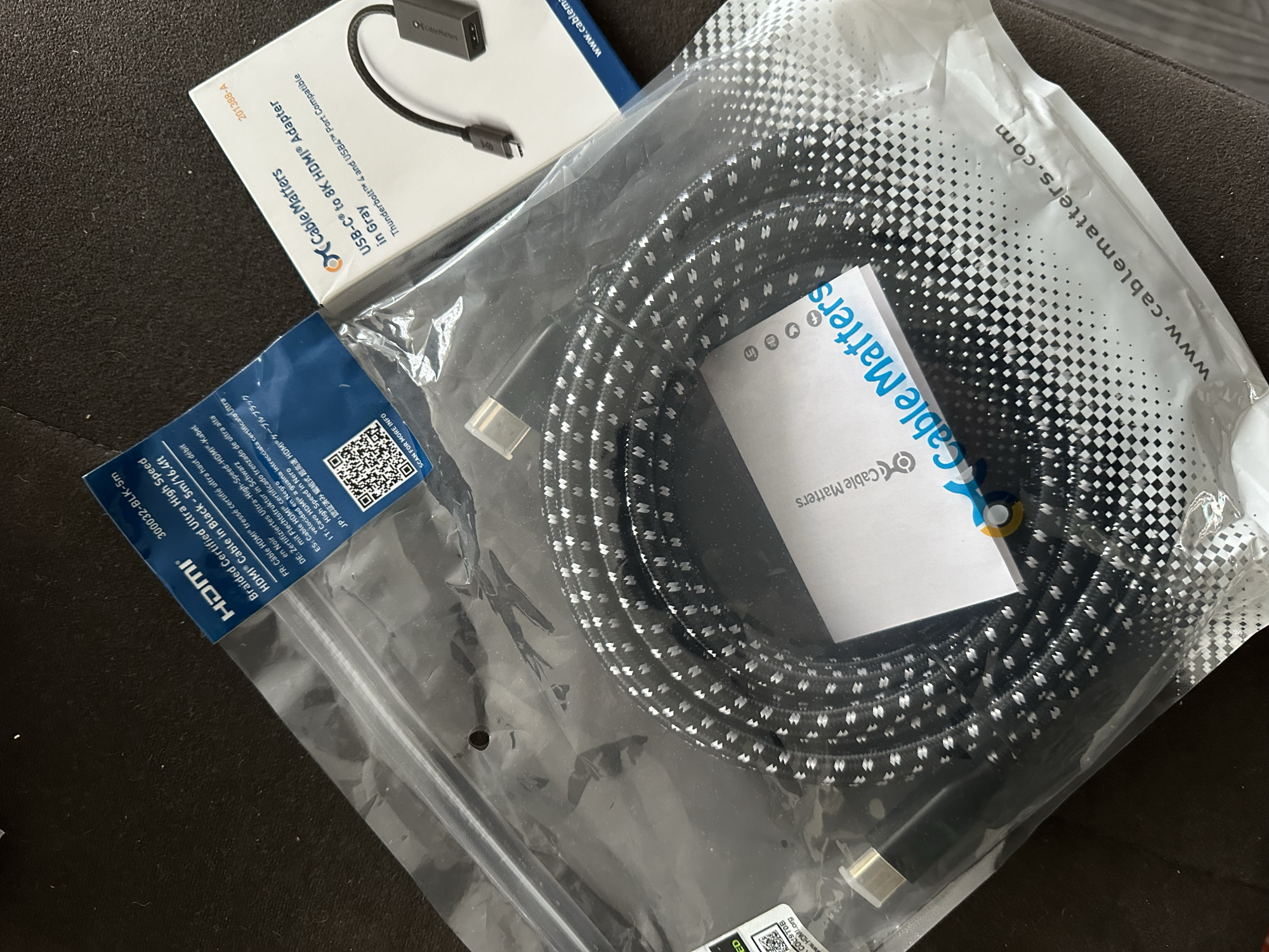

Have bought it USB-C to HDMI female adapter (201388-A) and HDM to HDM 5 meter cable (300032-BLK-5m).
Successfully flashed custom firmware (VMM7100_4kRGB120hz10b_V7_02_112.fullrom) from my macbook m1 through paralels. Not getting 120hz in 4k, only 60hz. What i am doing wrong?
@AironMan Let me know your thoughts , if you think its still not 4K 4:4:4 I will return this dongle. Thanks.
This looks like 4:4:4
Test with an short HDMI 2.1 Cable, if this also not work u have done something wrong.
