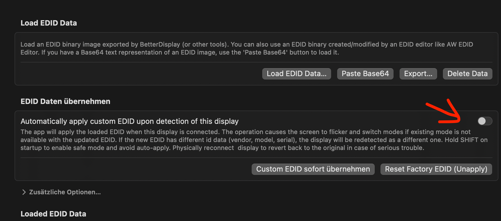

Guys, I've updated BetterDisplay (I own a Pro license) but every time I wake my Mac, it seems I have to upload and apply my altered EDID for 4k/120hz to show up. What gives? I use Configuration Protection but I feel like I am missing a very specific setting here...
U have to set "auto apply" on EDID settings.
Thank you, where would I find that setting exactly? The menu is quite extensive haha...

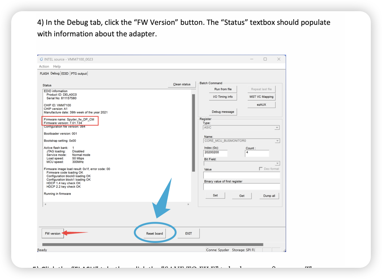

Hello, after flashing the firmware here, I wanted to check the information after flashing, but mistakenly clicked 'reset board'. After that, my USB-C to HDMI device stopped working. I tried to look up the manual for this software, but couldn't find any useful information.Do you know how to fix this issue and make it work properly?

I seem to have bricked my very expensive adapter with VMM7100... It's a ugreen adapter (https://www.lulian.cn/product/968-cn.html)
I flashed it on my windows laptop via a usb 3.1 port, using the USB C - HDMI VMM7100 file. But after that the adapter seems to not work anymore for video output.
Trying to open the VMM tool results in:
- Using the VMM flash tool provided, the error message is "can not find synaptics dp hub ic"
- Using the VMM tool from Microsoft store, the error message is "Spyder chip is not connected"
Hoping to get some help here as I paid quite a hefty sum for the adapter 🥲🥲🥲
Hey... You may need to flash the DP version.
Please use the HID version vmmtool on microstore app store.
Only that version don't show "can not find synaptics dp hub ic"
And only that version can load the FW information.
I bought an anker and flash DP firmware... Now I bring my bricked adapter back to live....
