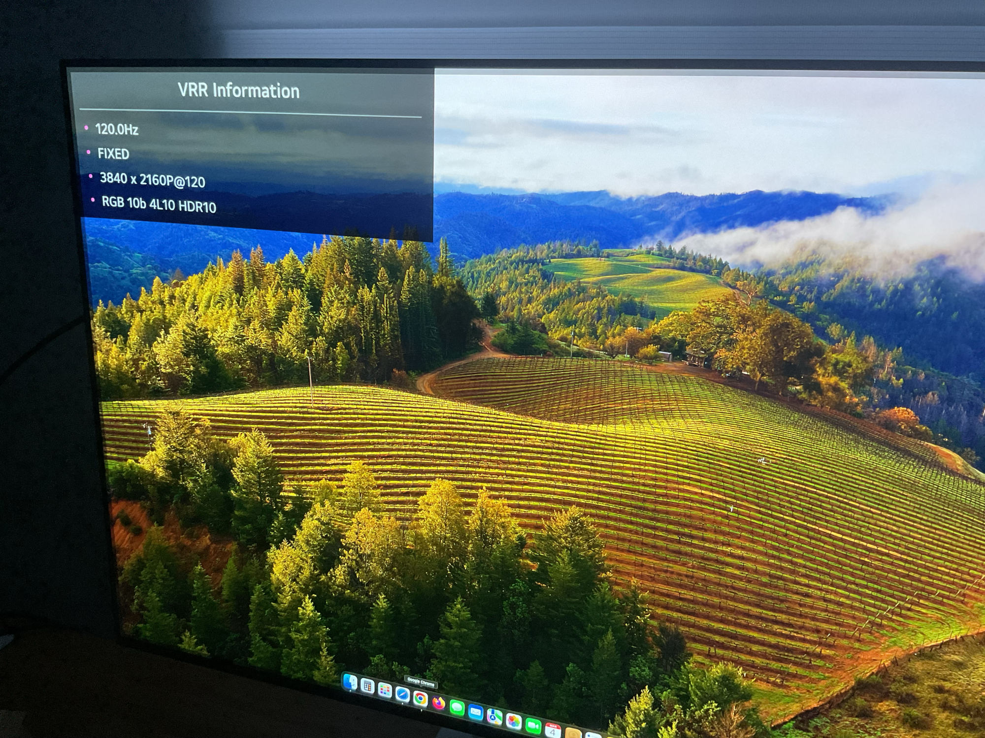

Hi every one, I figured how to get 4k 120 HDR10 with cable matters USB-C to HDMI 2.1 dongle (201388-A) directly connected to my MacBook Pro M3 Max and LG OLED C2 42". with this dongle even the tv turn OFF and ON automatically for sleep and wake like a normal computer display, before I had to use the tv remote to turn it ON and OFF during sleep and wake while using HDMI 2.1 from Mac to tv with no dongle and no dock station.
but unfortunately I couldn't get this dongle to work through Caldigit TS3.
Can someone confirm for me before buying Caldigit TS4 that is 100% working 4k 120 HDR10 with this dongle on my Mac and has no issues? and I wonder if the automatic wake and sleep will work as well with TS4?
Keep in mind I have a hard drive,Ethernet,Audio interface, web cam,iPad 10 and DSLR camera all connected to TS4!
I wonder if one thunderbolt 4 connected to my Mac can handle all of these devices!
Thanks

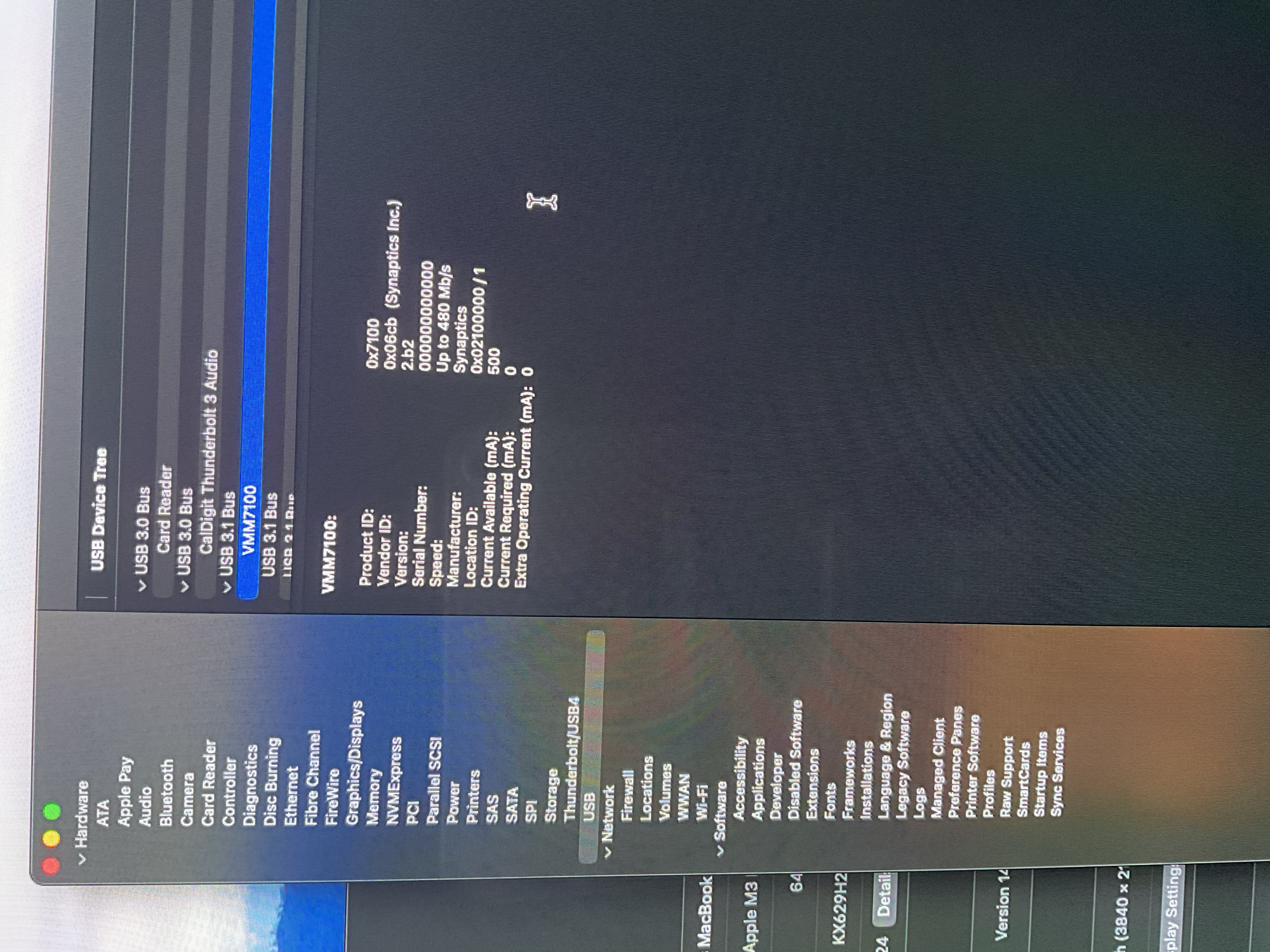

How does u enable DCC or CEC over HDMI ?
Strange, when I try it it says VMM USB chip is not connected, even though if I do the exact same thing with the 201388-A it lets me through. I should still be using the software from the microsoft store, correct?

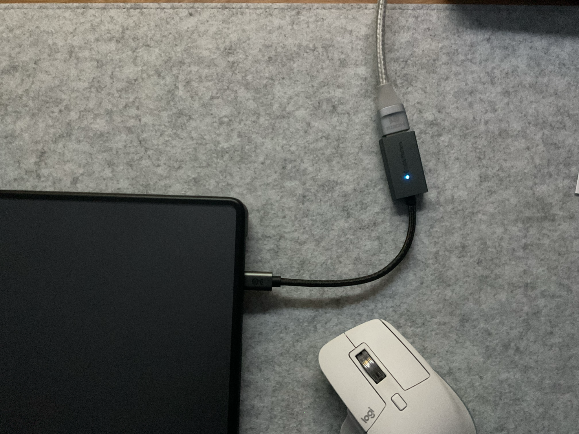

Did u connect an USB-C PD Cable to it ? The blue LED must be light on and a DP ALT HDMI Device must be connected.
Yes, both of these should not be the problem. I think my problem is passing through the usb to the VM. I can only select the "USB 10/100/1000 LAN" option, since that is the only one visible in parallels. Could that be the problem?

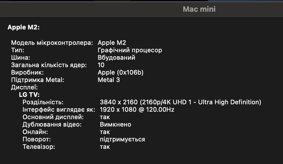

Hi to all!
I have LG oled 55B9PLA and Mac Mini 2014. In Mac OS Catalina I can chose scaled resolution: 1080p with 120Hz
Looks like this picture, but 120hz instead 60Hz:
I bought a mac mini M2 base last month, and with New Mac OS Ventura I don't see the same 1080p, only 1920x1080 with max 60hz refresh rate (picture for example):
I'm very sad about this. I dont feel big difference between mac mini 2014 120hz and M2 on 60hz...I'm use the same hdmi 2.0 cable for both, also tried cable from PS5. Everytime 60hz for Full HD is maximum. Can someone help me? I need only 1920x1080 with 120 hz.
update: better display help me

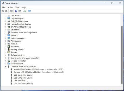

I do have the same issues w/ flashing the 2012310-BLK multiport adapter using macOS with Parallels Desktop and Windows 11.
Did exactly that.
Same for me!
Did you actually manage to flash it with parallels yourself or was that an assumption? Because I have still not managed to make it work and I tried really hard.
Did you have any success yet? Does anyone else have an idea or trick that we don't know?
Did exactly that.
Same for me!

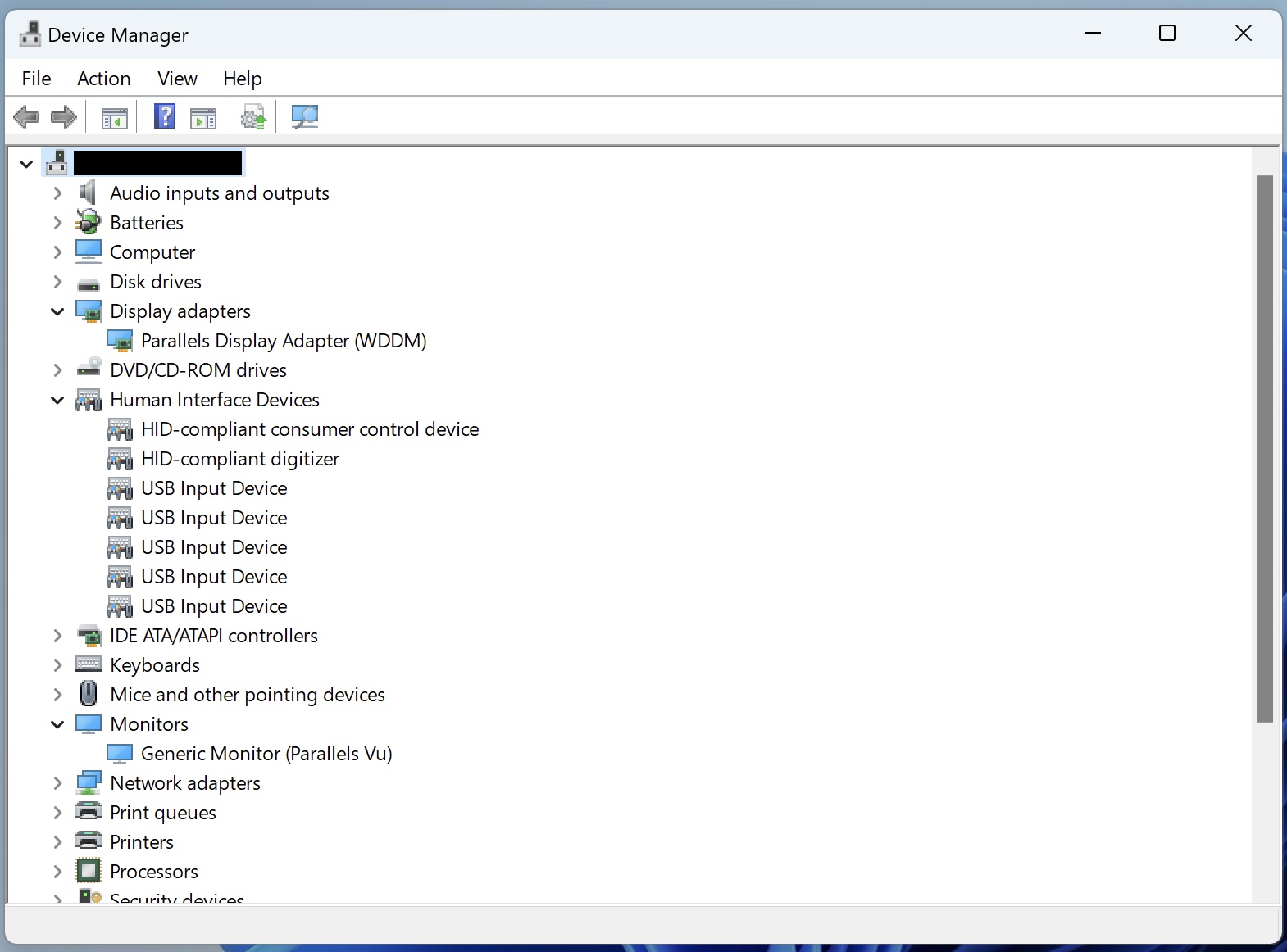

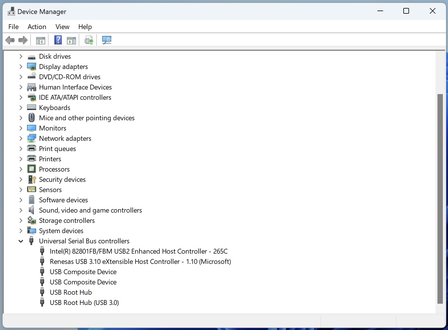

Looks like a driver is missing in parallels windows ? Can u take a look into device manager ?
I flash the adapter with an surface pro go
Hi to all!
Use the stock firmware. Dont use the custom firmware for the CM Adapter.
Here are two screenshots from the device manager.
Unfortunately, I don't have another device w/ usb-c video support. :/
