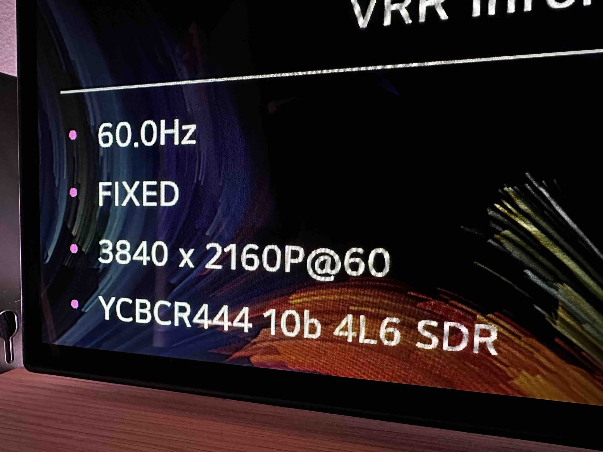

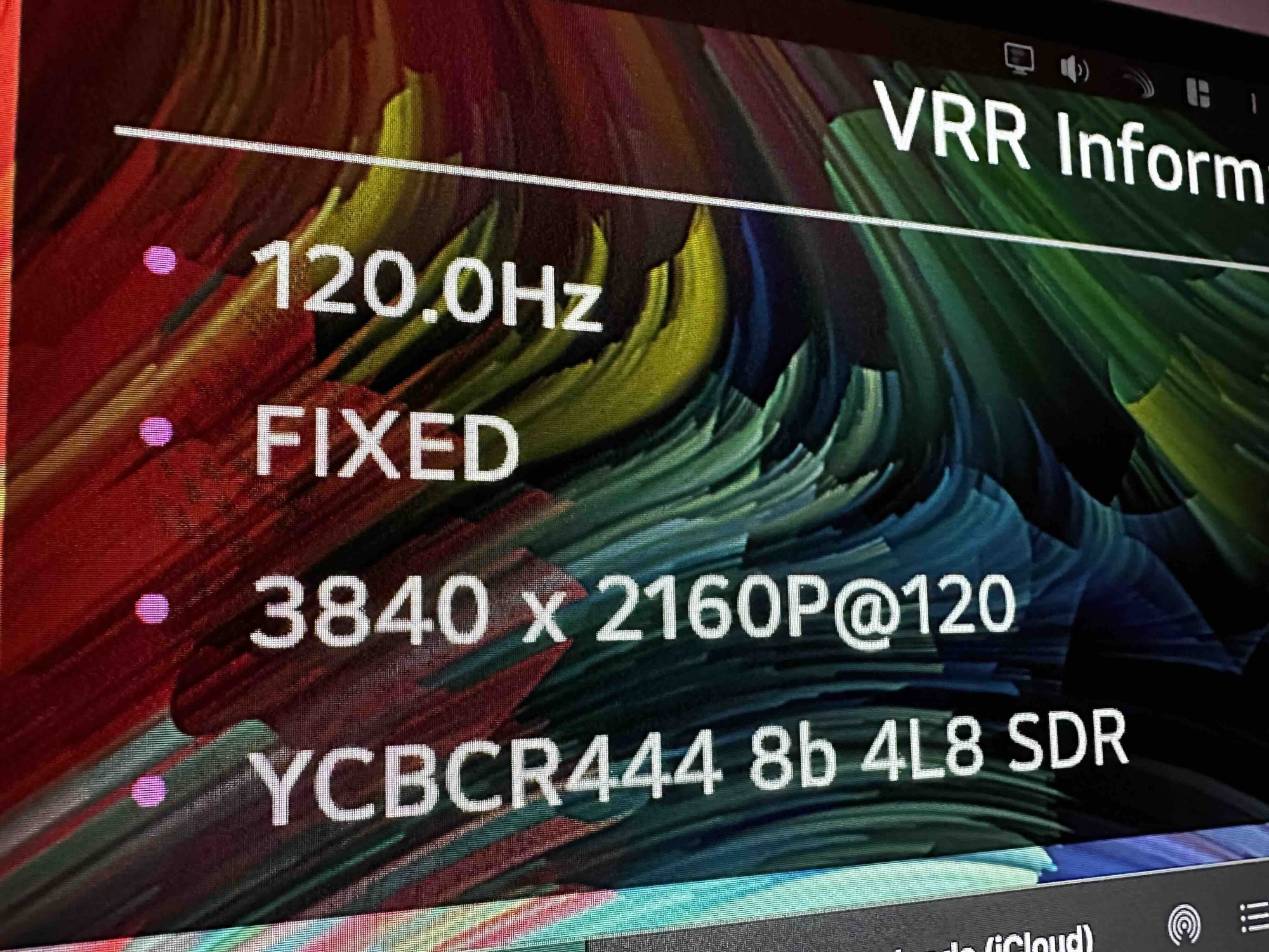

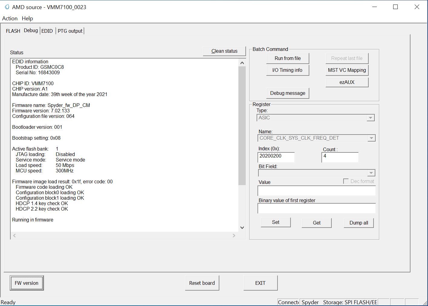

Through our continuous exchange, the very lovely people at Cable Matters have sent me a newer firmware (7.02.133) from the one they had initially sent me for my adapter (201428-GRY).
Either the newer firmware doesn't work any differently or I am missing a settings change on my system that is holding me back.
My TV only does 10b and HDR when in 60Hz, anything above that and the display reverts to 8b 🤷‍♂️

Don't use the newer Firmware it does not work correctly

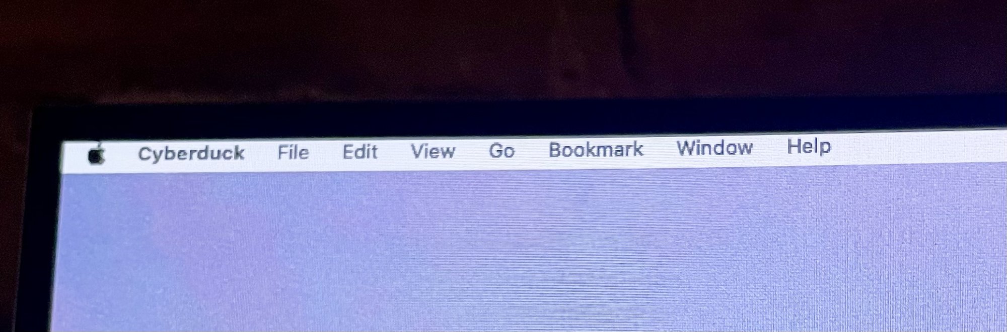

Is anyone else experiencing an overscan issue like this? I am using the 201388-A adapter on an M1 Max MBP with an LG C3 42"
Sorry for the bad quality, internal screenshots do not show the issue. Not the end of the world since I hide the menu bar but it is noticeable sometimes

On your TV go to All Settings> General> OLED Care> OLED Panel Care> Screen Move> (turn it OFF)

Also do this, Go to All Settenigs > Picture > Aspect Ratio > for user Selection (Original) and for Just Scan (ON)
