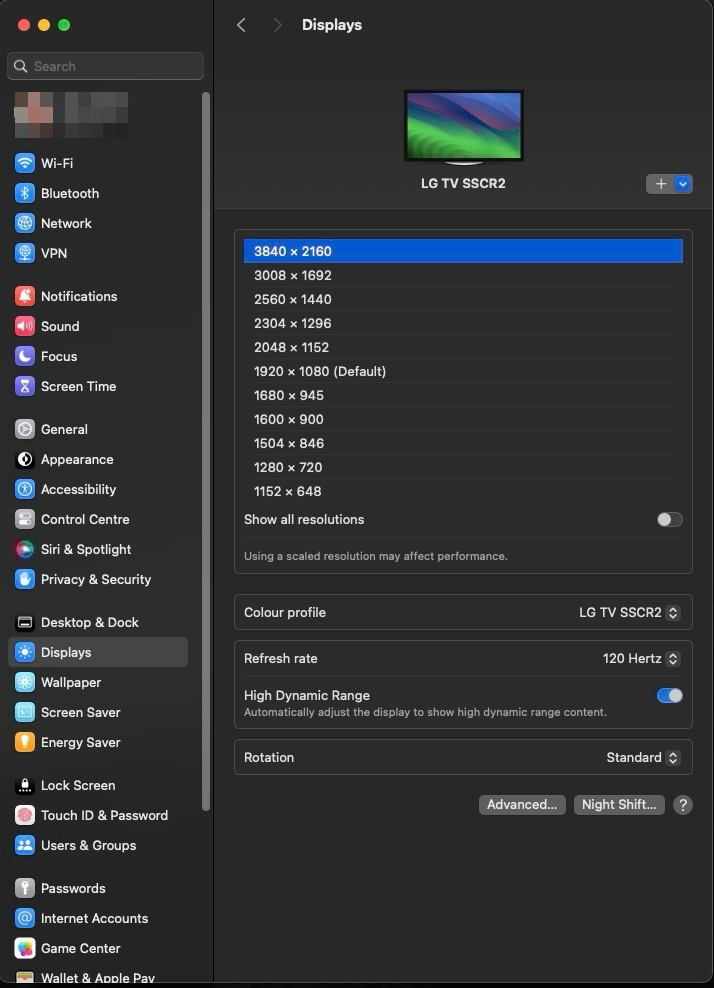

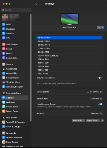

Configuration: Mac Mini M1 with Sonoma 14.6.1 --> Cable Matters reduction (201388-A) with flashed firmware --> ordinary cheap HDMI cable ver. 2.0 --> OLED LG42 C4 and I have 4K 120Hz with HDR??? I have Better Display installed but I don't know if it has anything to do with it.
