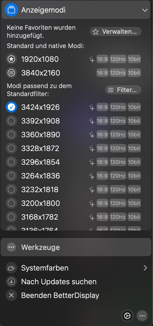

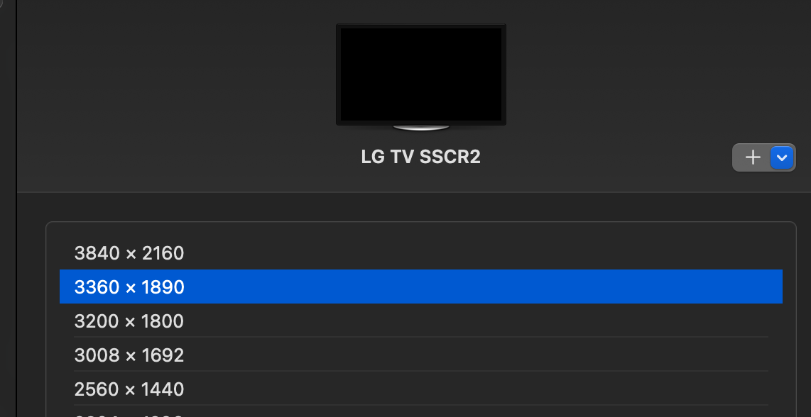

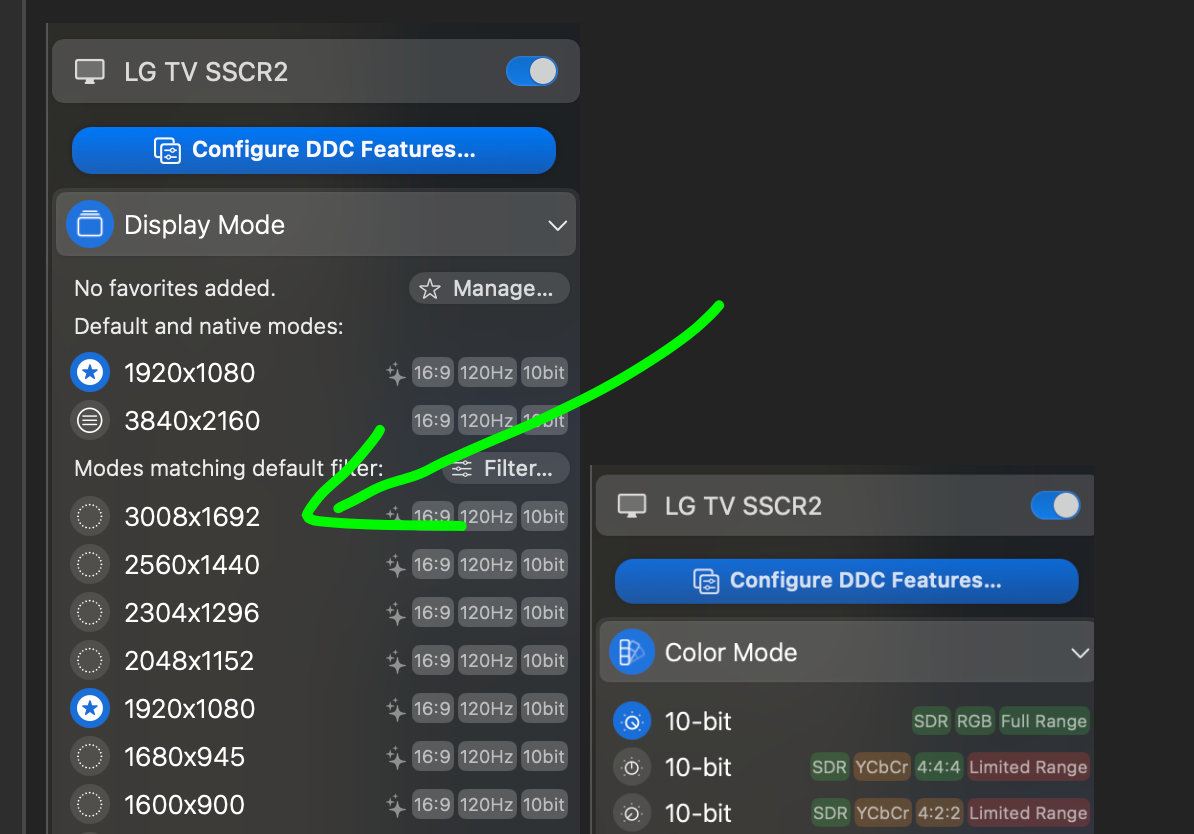

On my side MacOS 15 breaks 4k HiDPI with 120hz !!! Can anyone confirm that ?
@stevemr123 did u know that?
EDIT: On system settings there are 4k with HiDPI available but can not been selected. It automatically switch back to the 2nd one.
Yep, confirming same problem. A couple of other posts in here are saying the same thing.

I have the same problem. If I choose 200% scaling then HiDPI gets disabled and can't be turned back on.
The only way to get it back is to change refresh rate to 60HZ. Not even trying to enable HDR.
(MBP M1 Pro, VMM7100, LG C2, BetterDisplay Pro) I also use an Acasis TB dock, but same issue if connected directly.
For now just using 175% scaling, but missing the extra resolution.
Nothing changed besides updating to Sequoia. Avoid Sequoia if you rely on this. So frustrating.

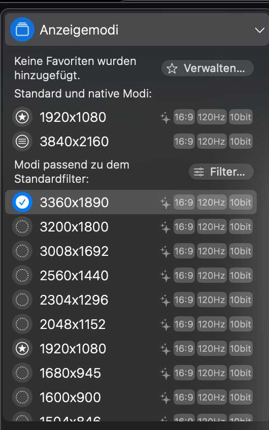

u can get a little more 178% when using fine scaling in BetterDisplay
Reactions: dinosauradventure

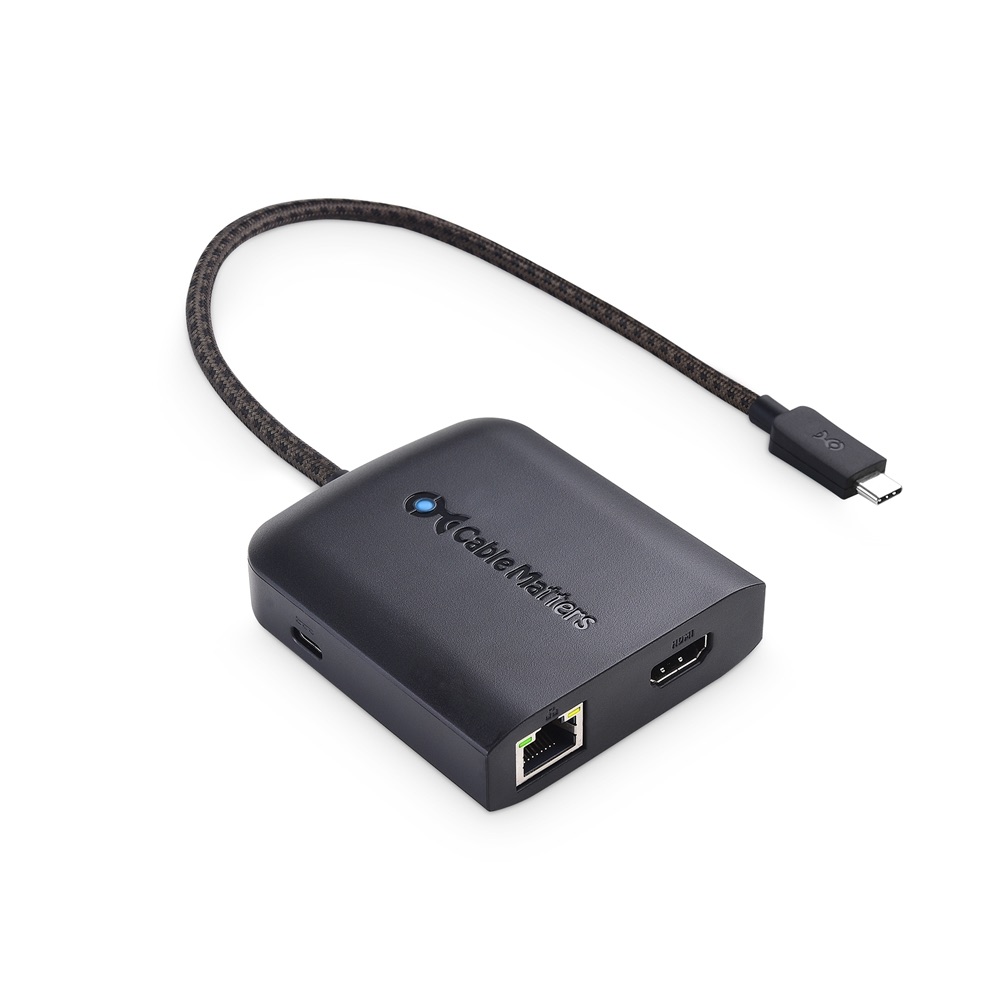

    We got an CableMatters Hub with USB-C PD, HDMI, 1Gbit Ethernet, 2x USB-A 3.0 that can be directly flashed to get 4k@120 YCBCR4:4:4 HDR. The Firmware ONLY FOR THIS MODEL are this one (CM Firmware 4k 120hz 4-4-4 HDR 201310) INFO: Flashing with parallels does not work with this adapter, u need a windows machine!
    Model-Number Cable Matters 201310-BLK
    (It can probably also work on another Adapters with Chip VMM6100 or VMM7100. No guarantee! U can test and report)
