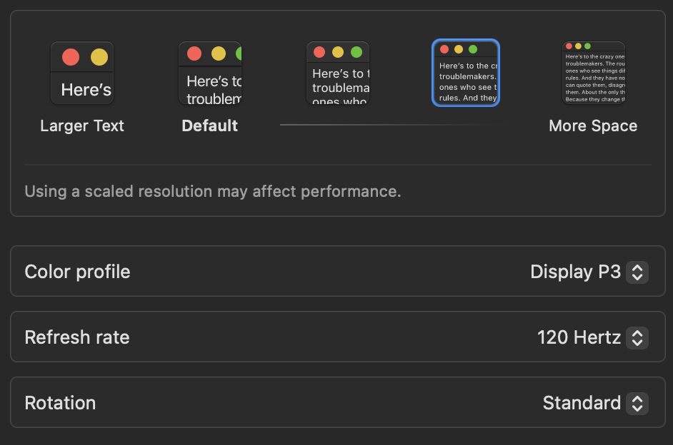

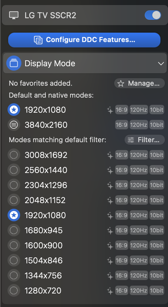

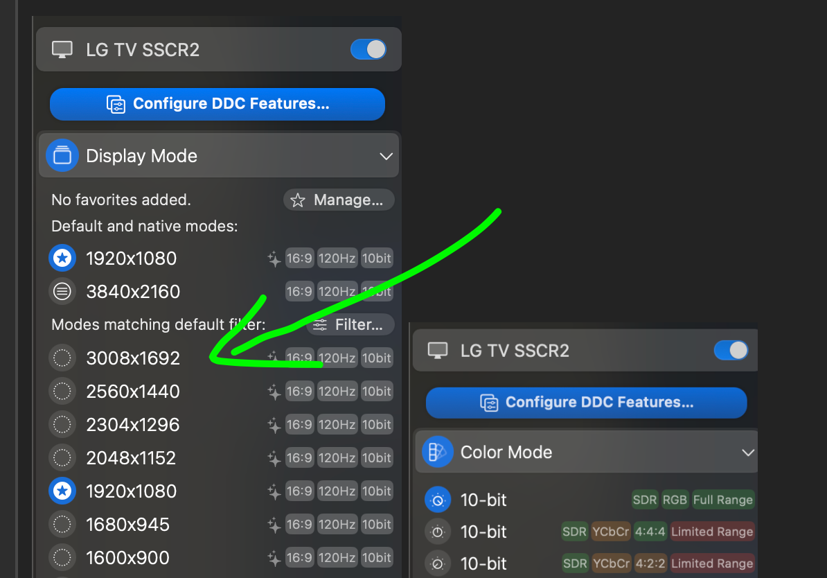

He's saying your screenshot shows the same problem. 3840x2160 is not available in HiDPI anymore under Sequoia.
but I can do 4k @ 120 hz hidpi on sequoia right now, check out my previous screenshots
(i just got an update notification btw, let's see if it fixes it or creates more problems it's just SF symbols)
okay now i realise what AironMan meant, i can't do hidpi at pure 4k but a little less than that
Only with the M3 models is it possible to achieve up to an 8K frame buffer, allowing for 4k@120Hz with HiDPI and HDR. Since macOS 14.1, Apple has limited M1 and M2 models, first by restricting HDR + HiDPI at 4k@120Hz, and now with macOS 15.0, we can’t even achieve 4k@120Hz with HiDPI anymore.

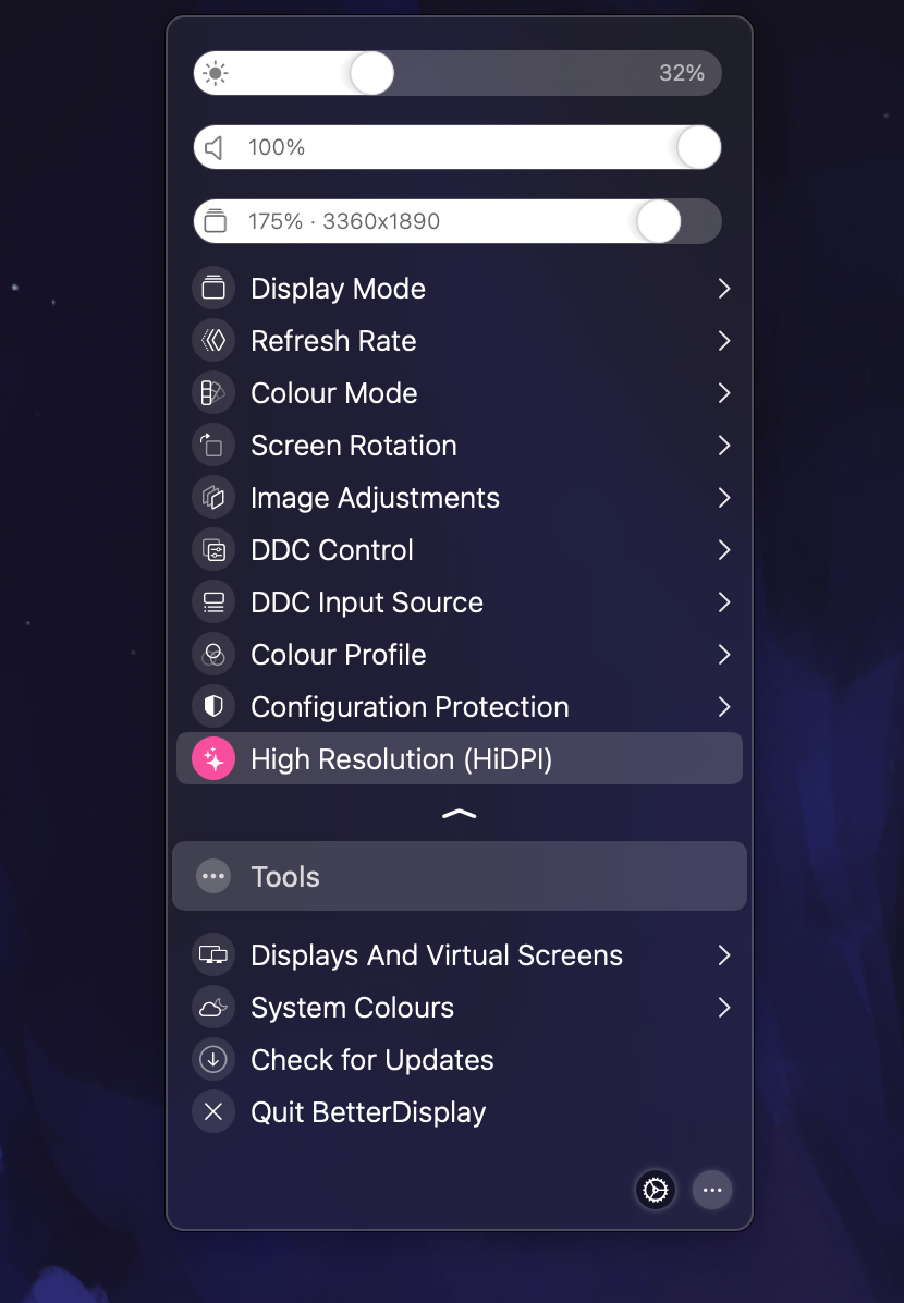

Okay so I spoke too soon. After testing this for a while, it starts to randomly stop waking up properly. At times it seemed to be triggered by flux, but then it still does that without flux running sometimes.
I just installed BetterDisplay, which seems to reset the adapter device on wake. It causes some annoying flashing of the display sometimes (because it's initialized properly sometimes, and then it gets reset), but it's better than having to unplug and plug it in again.
At this point I'm very happy it's working at all, so that will do for now. I'll update if the BetterDisplay method stops working.

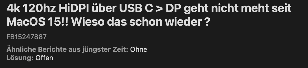

It is truly outrageous how Apple is handling my feedback. Not only do they completely ignore it, but they also claim that no similar reports of this issue have been made, which is an absolute lie and deceitful on their part. There are plenty of people experiencing this problem. Just within our forum, we can confirm that we’ve reported this issue many times, and I know from other sources that the problem is well-known. This is simply unacceptable behavior from Apple.
What’s happening here is deliberate cover-up, and older Mac devices are being purposefully crippled. One really has to question whether what Apple is doing is even legal. Can we take legal action against this? It seems like they’re pushing boundaries, and we should look into the possibility of legal recourse.
I want to express my frustration about how Apple is handling this. They’re not addressing the problem at all and are merely trying to cover it up, acting as if they don’t even know what’s going on. However, we in the forum can clearly point out that first, the HDR feature was disabled, and now the High-DPI function has also been removed—intentionally, but only for older devices, not for the latest models. This clearly shows what Apple is doing: deceiving us customers and putting up barriers to force us to buy newer devices.
Features that previously worked are now being eliminated with macOS updates, without any mention of these changes in the changelog. This is simply outrageous.
  • Please pull a request to Apple and credit my Apple ticket request (FB15247887) so they can see that we’re all raising the same issue since macOS 14.1 and macOS 15
The Problem:
macOS Sequoia 15.0 and newer breaks HiDPI with 4k@120hz 4:4:4 and beyond. The maximum possible is: 3424x1926 for 16:9. LowRes with 4k@120hz 4:4:4 is still possible. The reason: Apple limit the framebuffersize to 7K. M3 users are NOT effected.
macOS Sonoma 14.1 and newer breaks HDR with HiDPI 4k@120hz 4:4:4 and beyond. The reason: Apple change some pixel clock for HDR . M3 users are NOT affected.
