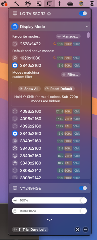

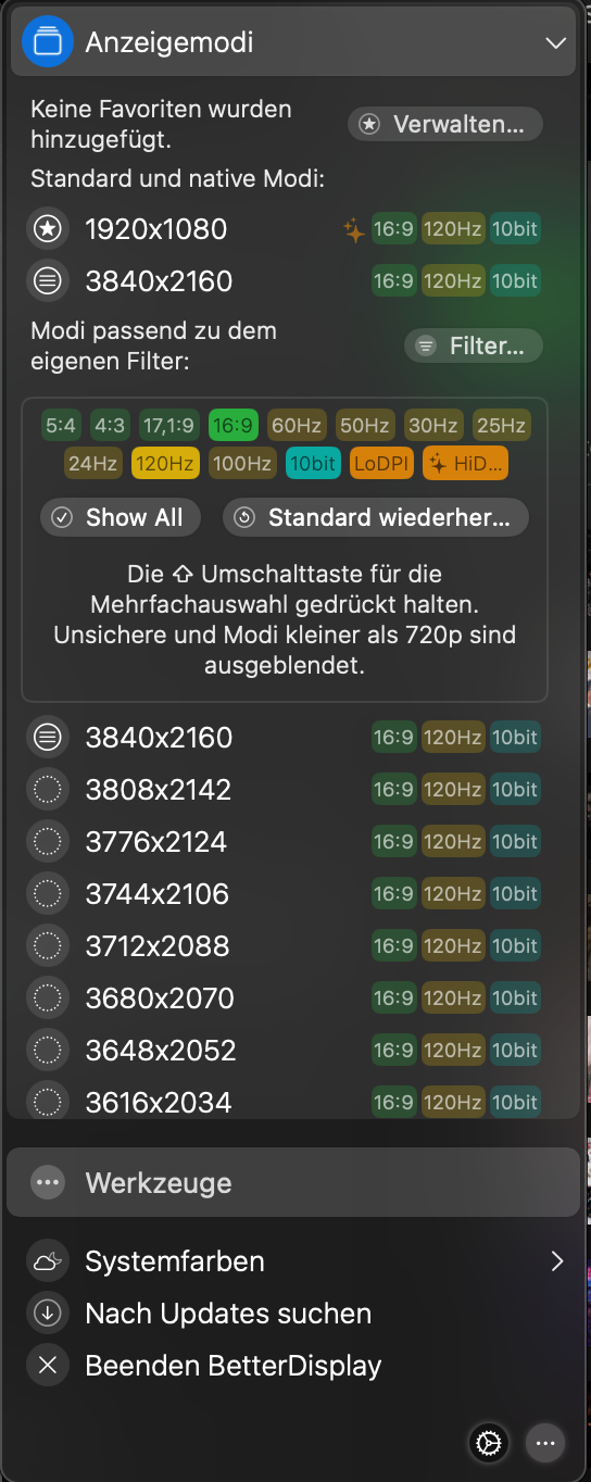

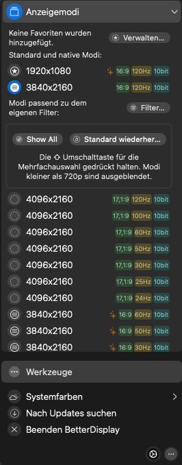

But can u list this "unexposed combination" also on the Display Mode List ? That will be fine also for restore it with config protection :)

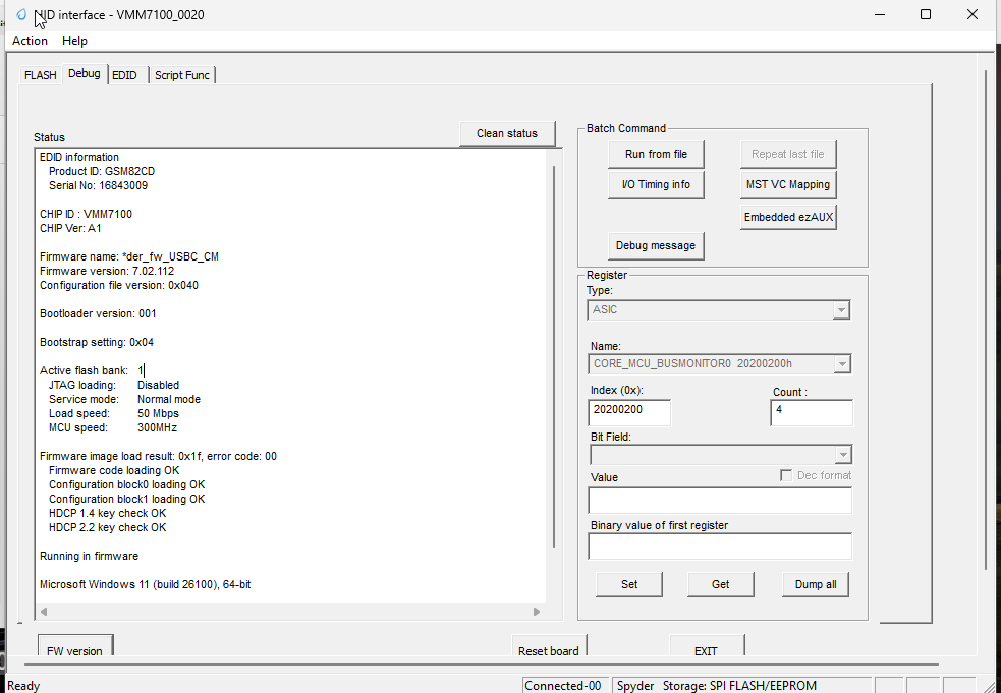

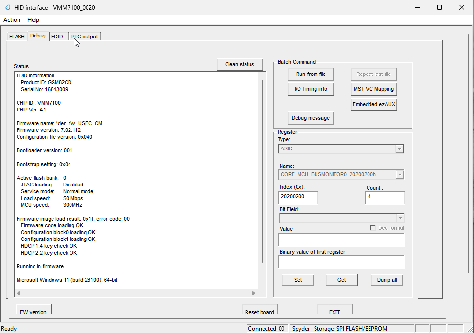

I have a 42" C4 and a 14" MBP M3 through a CalDigit TS4.
I am running Sequoia - 15.0.1 (24A348)
I have a secondary monitor that is a 1920x1080@144hz
  • I connect to the LG C4 from the TS4 dock via this cable which has the VMM7100 chipset
  • I connect to the secondary monitor over a DP>HDMI cable from the dock
After flashing the firmware of the cable it worked for a while, then stopped working. Now I can only achieve 60hz and for some reason I can't set my resolution to 160% scaling as I did before. Its made things worse and worst of all its very inconsistent, I have had it work maybe once more after hours of retrying and I have no idea what "fixed it".
Any help would be appreciated!

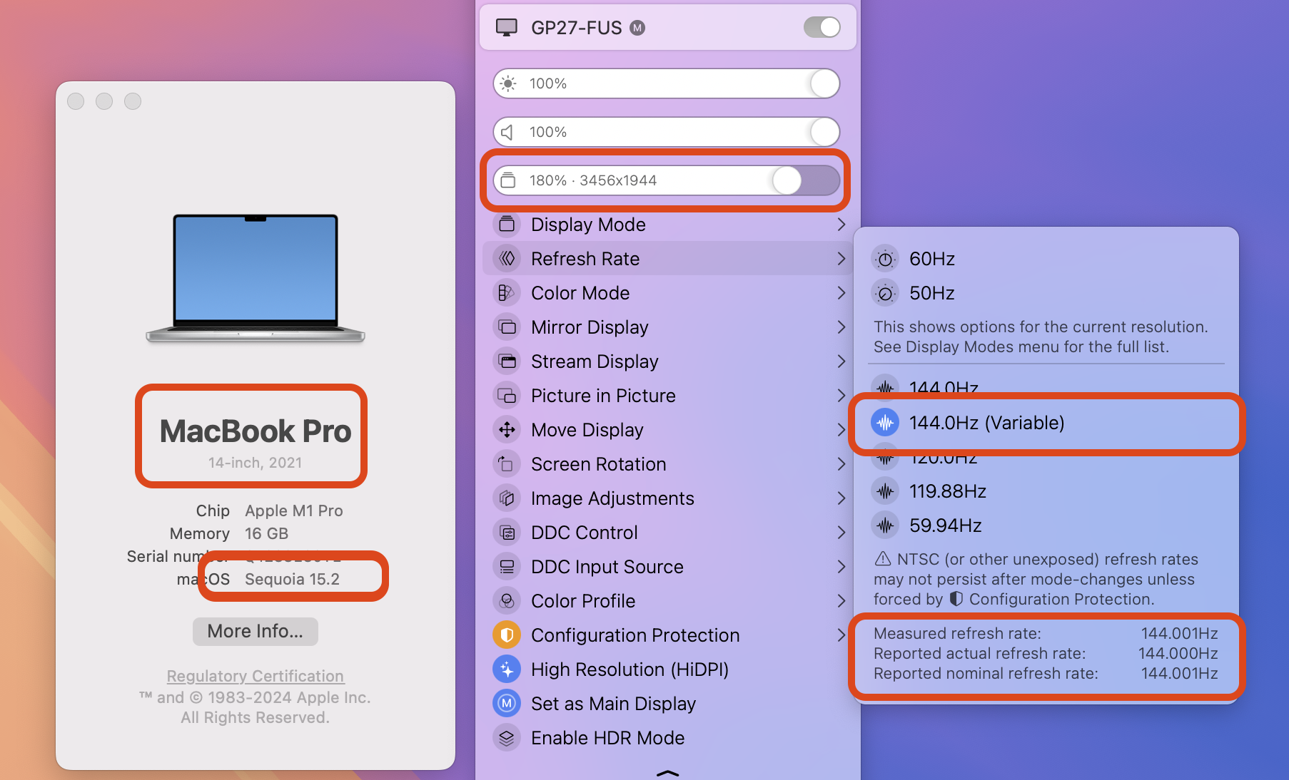

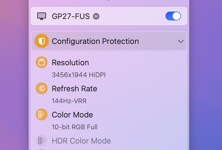

It appears this workaround stopped working on 15.2 dev beta 1

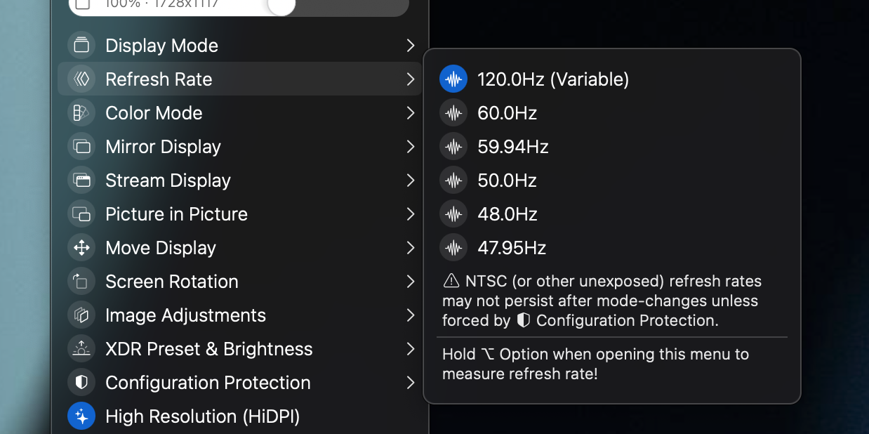

The workaround should work fine on 15.2 beta with BetterDisplay. Just tested with my old M1 Pro 14" MBP and a 4K high refresh rate display.
This is what I tried:
  1. Check the max. HiDPI resolution in the canonical resolution list for 120Hz which is 3072x1728.
  2. Switched to 60Hz and choose a higher resolution, namely 3456x1944 HiDPI.
  3. Switched to "unexposed" 120Hz, 144Hz and 144Hz variable modes.
  4. Tested all using the app's own vsync checker (hold OPTION while opening the Refresh Rate menu) on the display's OSD and UFO speed test to see if these are legit.
  5. Everything checks out OK (see all details on the screenshot below + the screenshot resolution shows it's a HiDPI rendered desktop).
So all in all, while for some reason macOS Sequoia does not list certain resolutions at higher refresh rates due to a software limitation, the hardware can still produce all the HiDPI resolutions with all the high refresh rates just fine. The trick is to first select the resolution using a lower refresh rate and then switch to an "unexposed" refresh rate using the app.
I understand that some reported that config protection for this mixed mode does not work properly in 3.1.2 - I'd probably need some more details on how to reproduce that as it seems to work fine here so I was not able to reproduce the issue yet.
Reactions: Zorast

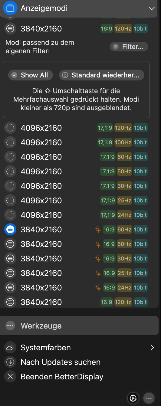

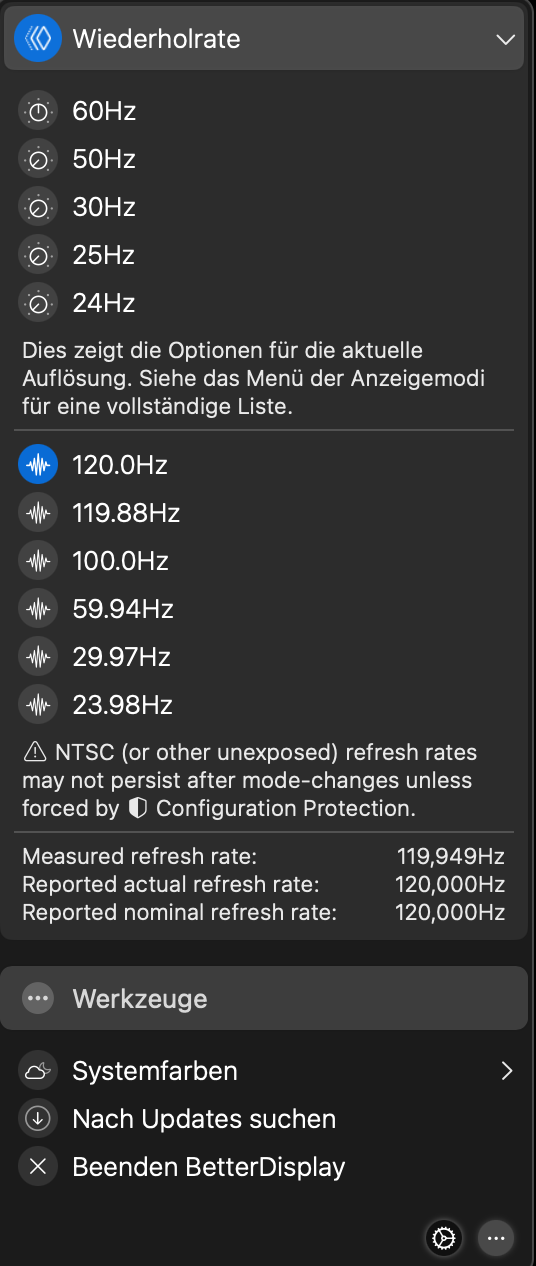

Yes look like the trick is so enable 60hz with HiDPI and then switch back to "unexposed frequencies" 120hz. Then its save the resolution also on Display Modes so it can handle better the restore config protection. Before we select the Resolution with macOS Settings, I think that was the problem here.

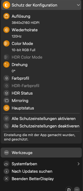

EDIT: Just testet, config protection does not set correctly the setting again. Looks like it will restore 3840x2160 120hz in normal Mode not in "unexposed frequencies" mode. U see, when using the trick, in Display Mode stays on 4k@60hz HiDPI. But when the config protection was in action it is on 4k@120hz native, because HiDPI is not present when it's not in "unexposed frequencies" Mode.
Yes look like the trick is so enable 60hz with HiDPI and then switch back to NTSC 120hz. Then its save the resolution also on Display Modes so it can handle better the restore config protection. Before we select the Resolution with macOS Settings, I think that was the problem here.
EDIT: Just testet, config protection does not set correctly the setting again. Looks like it will restore 3840x2160 120hz in normal Mode not in NTSC mode. U see, when using the trick, in Display Mode stays on 4k@60hz HiDPI. But when the config protection was in action it is on 4k@120hz native, because HiDPI is not present when its not in NTSC Mode.

Regarding the config protection issue - I will need to do a test again. I did not test it with 3840x2160 HiDPI but with a different 3456x1944 resolution. It is possible that since 3840x2160 is available with 120Hz but as LoDPI, config protection is satisfied with that instead of forcing HiDPI. Do you have this config protection issue if you try a slightly lower HiDPI resolution (note: I am not sure how useful it is to have the native resolution as HiDPI, I don't think it improves clarity much - beyond zooming and screenshots of course - as simply there are no extra pixels to show high resolution content, so all you achieve is a kind of supersampling effect).
Update: just re checked config protection with the mixed 3840x2160 HiDPI 120Hz mode on M1 Pro and indeed it does not seem to work as expected. I will look into this issue and hopefully improve the situation in a future update. Meanwhile as a workaround you can script the required changes (set the mode to 3840x2160 HiDPI 60Hz using the app's CLI and then switch the refresh rate to 120Hz using the app's CLI) to quickly restore the preferred configuration.
@AironMan - just a minor note: 'NTSC' is not the right term here - by NTSC refresh rate the app refers to those funny x/1.001 refresh rates (29.97 and 59.94 etc), these could be used when working with legacy NTSC (US video standard) video devices. The 120Hz, 144Hz etc is just simply "unexposed" refresh rate - meaning that for the given resolutions these refresh rate options are not enumerated by macOS in the display mode list, but are apparently still accessible with some low level hacking.

Hi - I am now running the exact adapter from the OP and have flashed it the same as before.
I am still getting 60hz only (though interestingly I am getting an option for HDR now).
Really nice @dinosauradventure, when using "other unexposed frequencies" 120hz I can reproduce 4K HiDPI. So confirm that this will work!
Steps:
1. BetterDisplay: Select 4k HiDPI @ 60hz
2. BetterDisplay: Use 120hz on BetterDisplay "other unexposed frequencies"
Info: BD config protection does not work correctly for now. It's better to disable it and then change every time to "unexposed frequencies" 120hz manually.
BUT: I warn u, apple will read this and "fix" this faster as u can see :mad:

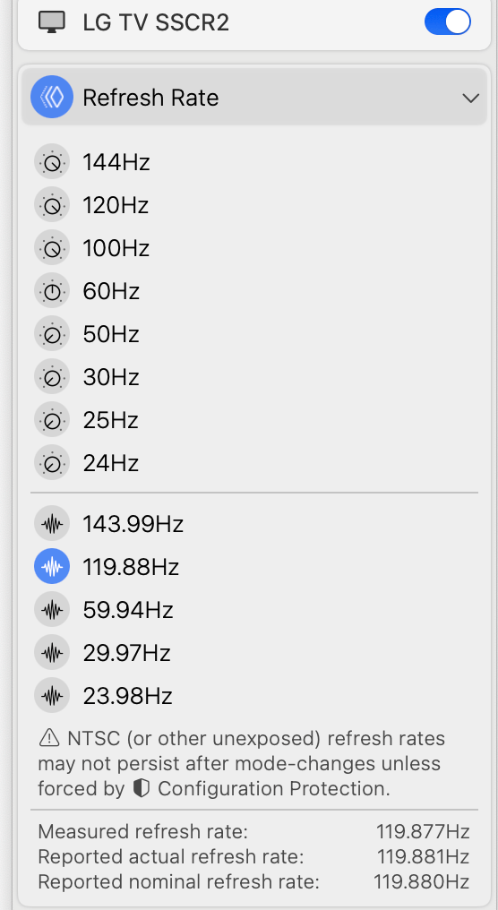

M1 MAX MacBook Pro & LG G4 55''
I don't see 120Hz option in hiden option of BetterDisplay, so I choose 119.88Hz. I think maybe it's same😂
Although the display output can reach 4K@119.88Hz, 12-bit RGB Full Range HDR (using BetterDisplay settings), the cable is running in 4L12 mode in this setup. As long as the cable is working in 4L12 mode, when connecting a Mac to the TV and then connecting the TV to the soundbar through HDMI eARC, the sound from the soundbar intermittently cuts out.
However, if I switch BetterDisplay back to the previous 4L6 output, i.e., 4K@60Hz, 12-bit RGB Full Range HDR, the soundbar works fine with this setup, and the issue doesn’t occur.
Has anyone else experienced this problem?

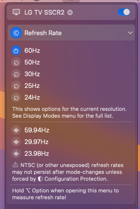

BetterDisplay normally shows options in the "unexposed" list that are not available for the normal display modes. However if you hold SHIFT while you open the Refresh Rate menu, it will only show "unexposed" (low level switch) refresh rates - meaning that for each option the app will switch refresh rates using a low-level method, not via normal mode change.
You can discern the difference in the icon as well (the waveform icon will show a low level refresh rate switch). This is how this looks for example on a built-in XDR display:
