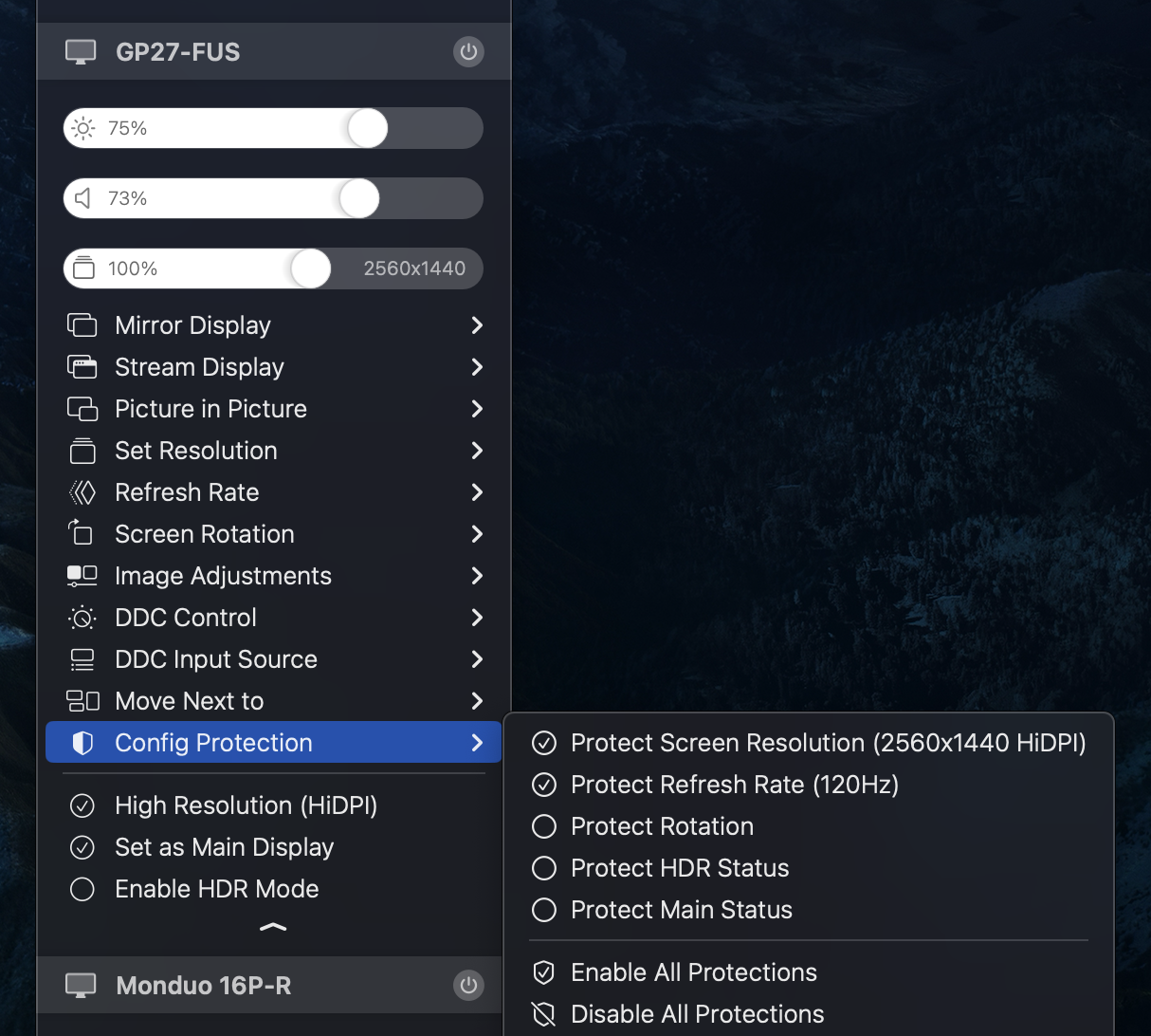

Hi all, we tweaked the config protection setting in BetterDisplay with @AironMan testing it with his C2 so 4K@120Hz is restored even without alternate serial number with the right config protection settings (set the protected resolution to the desired one and refresh rate to 120Hz). The feature is available in the latest beta. This somewhat simplifies things as creating an alternate identity for the modded EDID is not needed as long as the config protection is active.
Seems to work perfectly!
