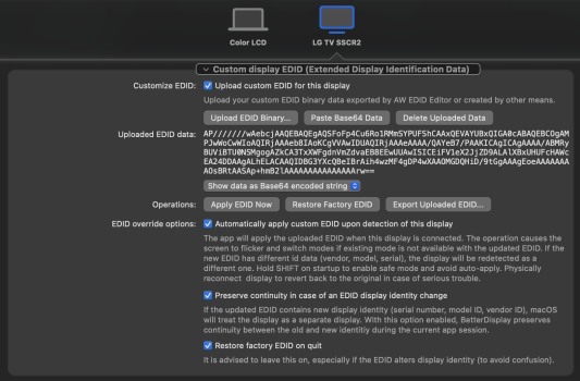

For those that not work correctly, plz send information about ure Adapter, screenshot from BetterDisplay Display informations (First 3 Sections), VmmDPTool Firmware Info and upload ure original and modified EDID plz. Thanks.

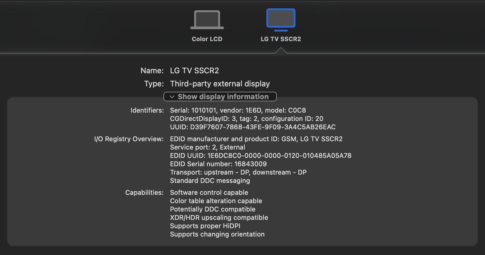

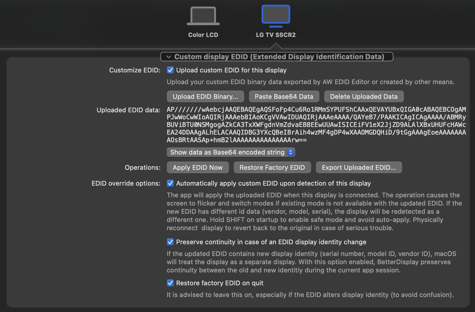

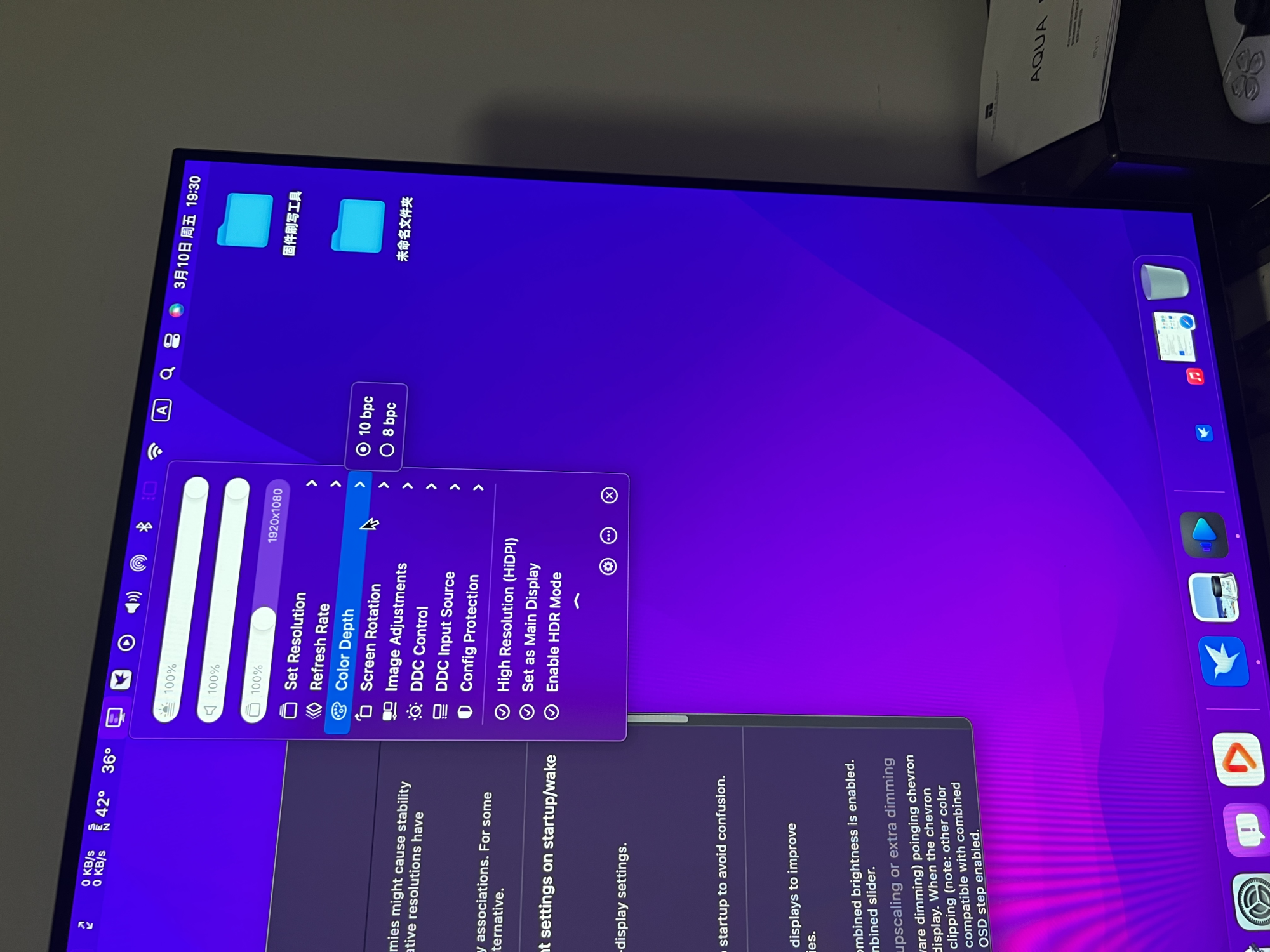

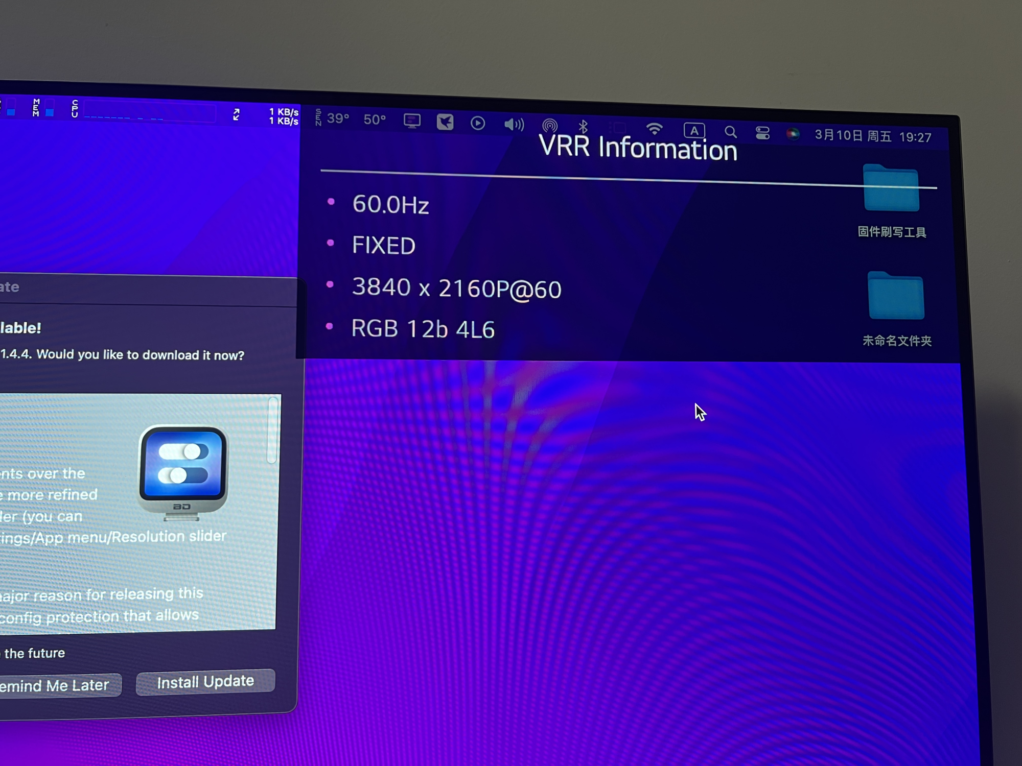

Please refer to captured images i uploaded, not sure what are first 3 sections you are asking
I'm using Cable Matters USB-C to 8K HDMI adaptor with VMM6100 model, i've updated firmware with this posting

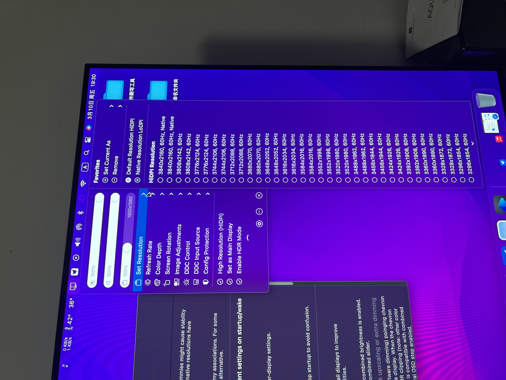

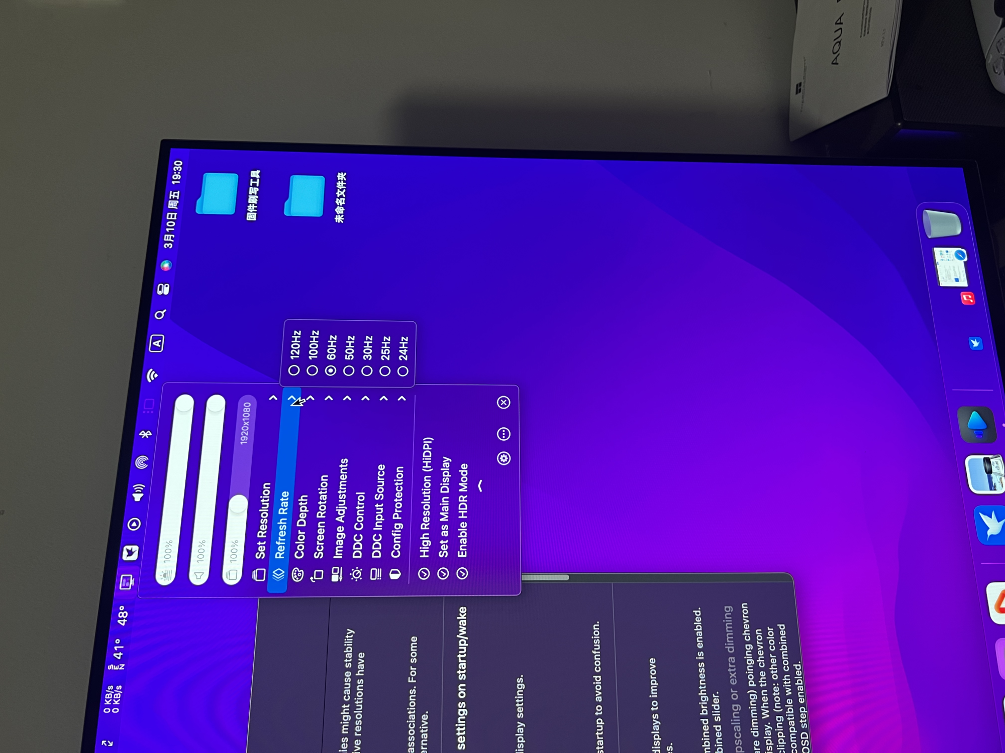

Thanks for ur wonderful job, that I have already made my m1 MacBook air work with rgb10 120hz using MOShou c-008 adapter. And I have another desktop using i7 13600kf and amd rx6600, which installed windows11 and ventura 13.2.1. And when use a hdmi2.1 cable i can only get rgb8bit 60hz or ycbcr 420 120hz on macos,cuz Apple only receive hdmi2.0 signal otherwise the Windows can run as rgb10 120hz hdr full hdmi2.1. So i bought a moshou c-002 adapter which is dp1.4 to hdmi2.1 and also vmm6100 chip. I followed the step as the post said, renew the firmware ,edit the edid bin, and at last I canonly get 4k ycbcr420 12bit hdr or 4k rgb12bit 60hz hdr on macos. While using the adapter i can get full 4k 120hz rgb10bit hdr on Windows.my monitor is lgc2 42. I think the reason is usb c has 40gb while the dp1.4 has only32gb broadwide so the firmware should different, but since Windows11 can run full rgb10 120hz using the dp1.4 adapter ,the broadwide is enough for dp1.4 while the dsc is on if the firmware can be edit correctly on macos i guess?
Looks like DP > HDMI 2.1 works different. We have to test more Adapters to know which one works.

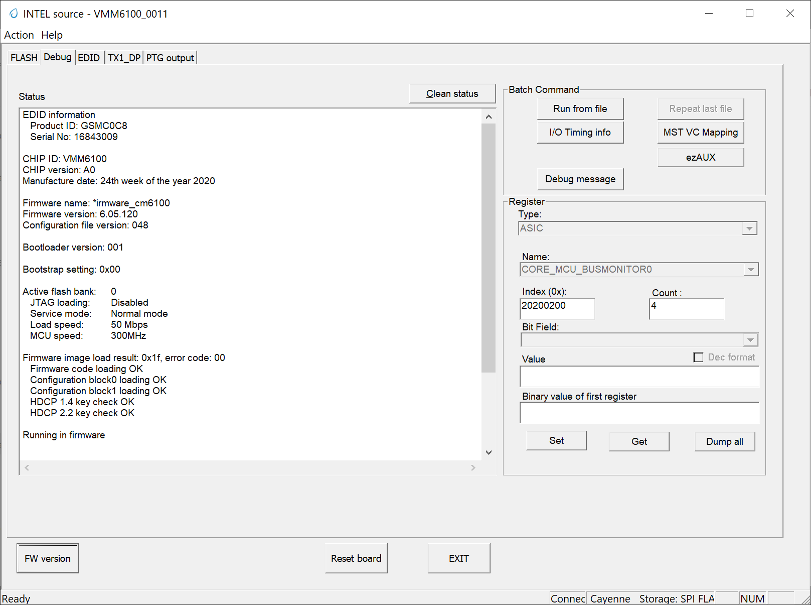

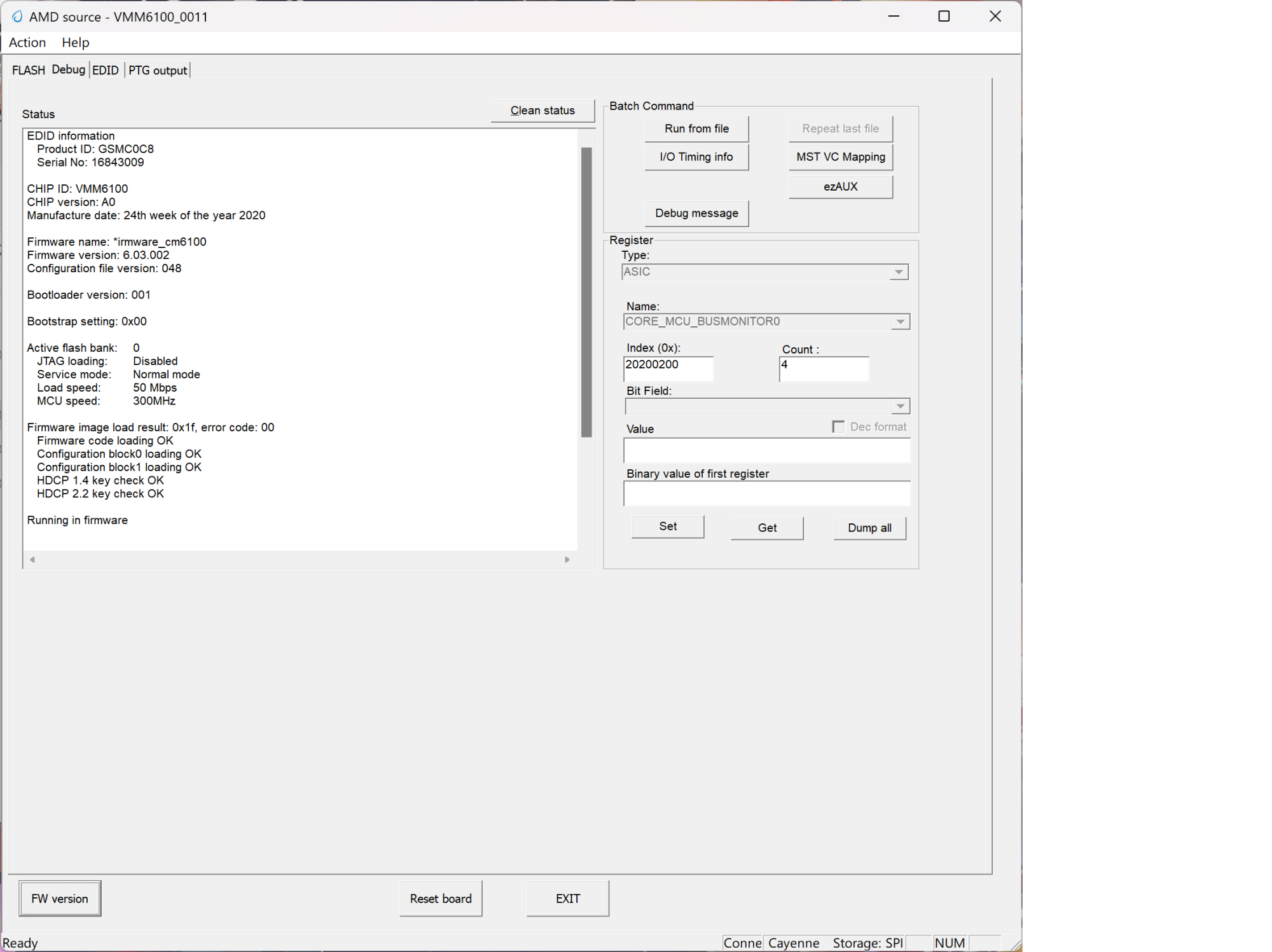

And plz upload the Picture from Firmware Info in VMMTool showing
The information showed in vmmtool and better display like this. and the adapter is moshou dp-002 dp1.4 to hdmi2.1.
