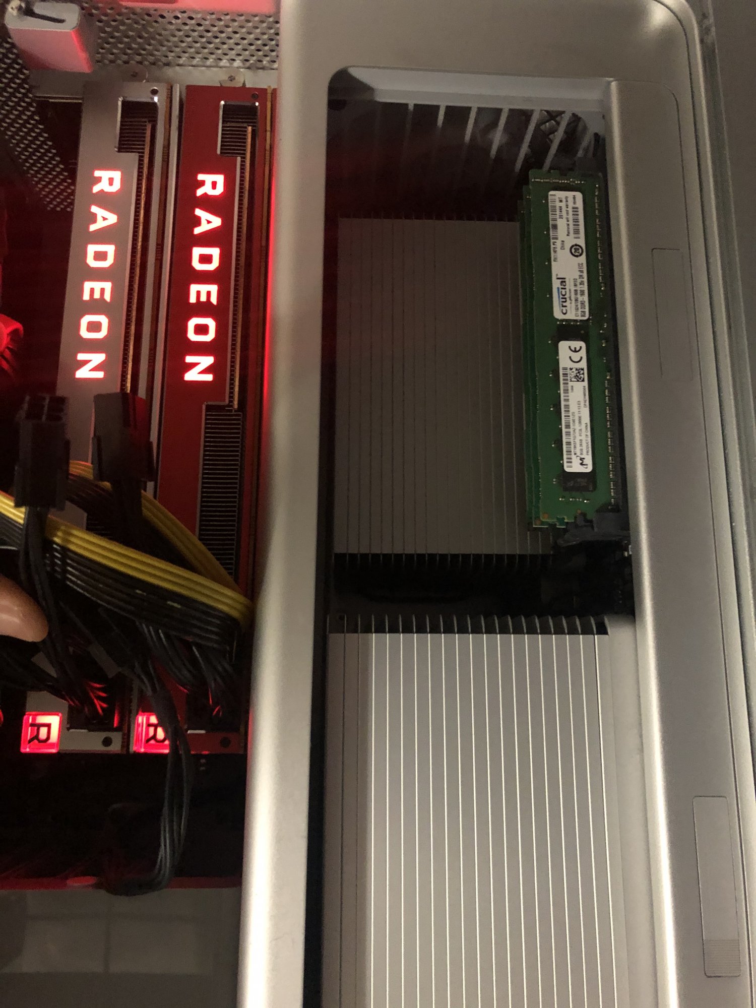

Hi guys, i registered an account just to let you guys know about my setup. I put 2 Radeon VII in my Mac Pro 12 core 2010 Mojave and it works like a charm! i did a lixlas mod then split it in to 4 8pins connectors. The Mac Pro PSU is 980w so it has enough power for 2 Radeon to run. the only thing is the fan is covered by the other card so i might want to put them in waterblock.
good luck to you whom want to do the same setup.
How hard can you run those till the bottom one throttles?
That lower card won't like running like that long term!
