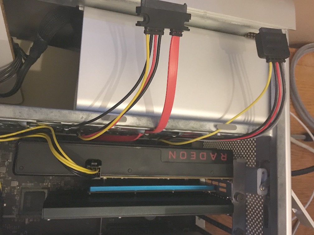

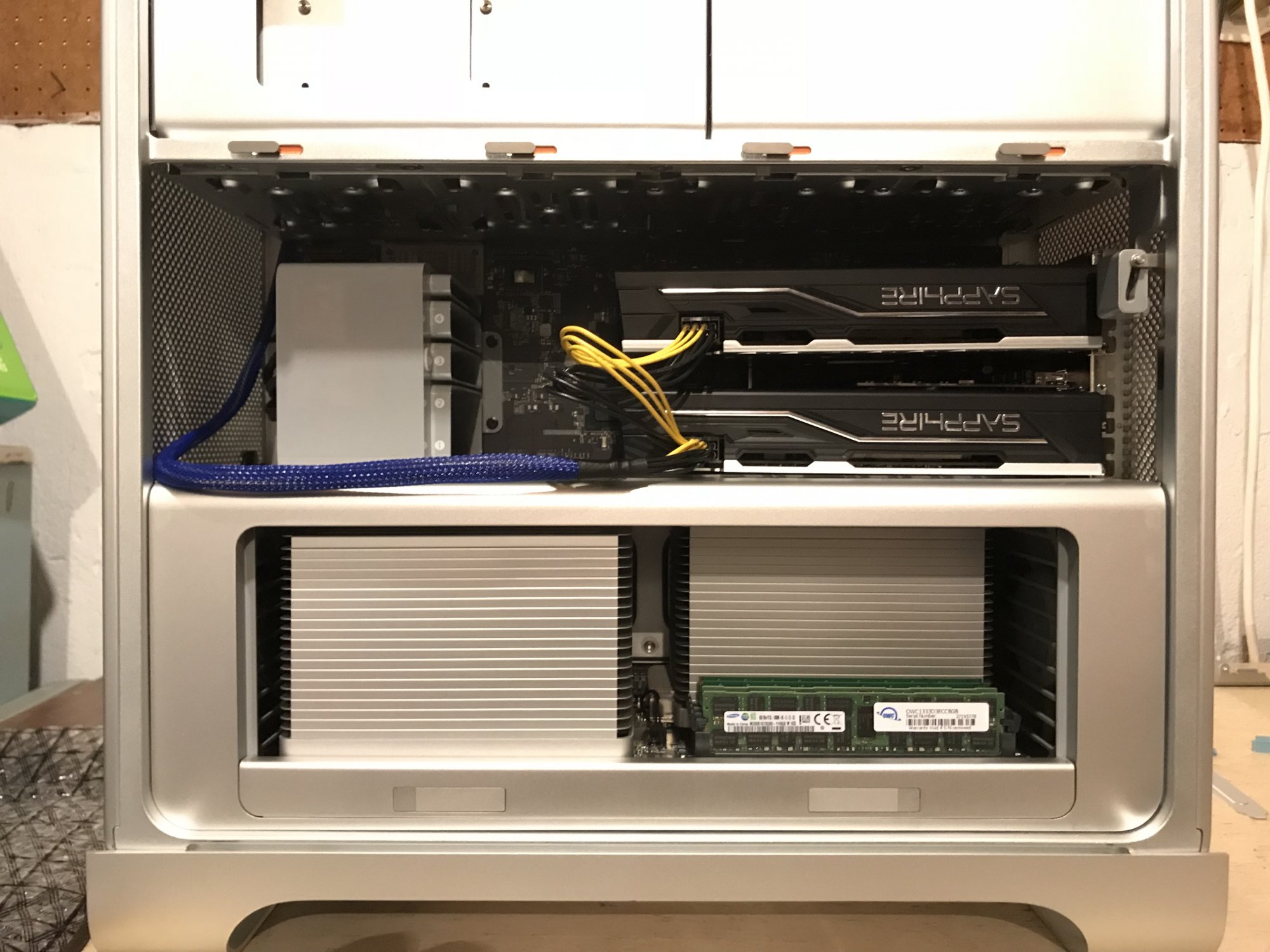

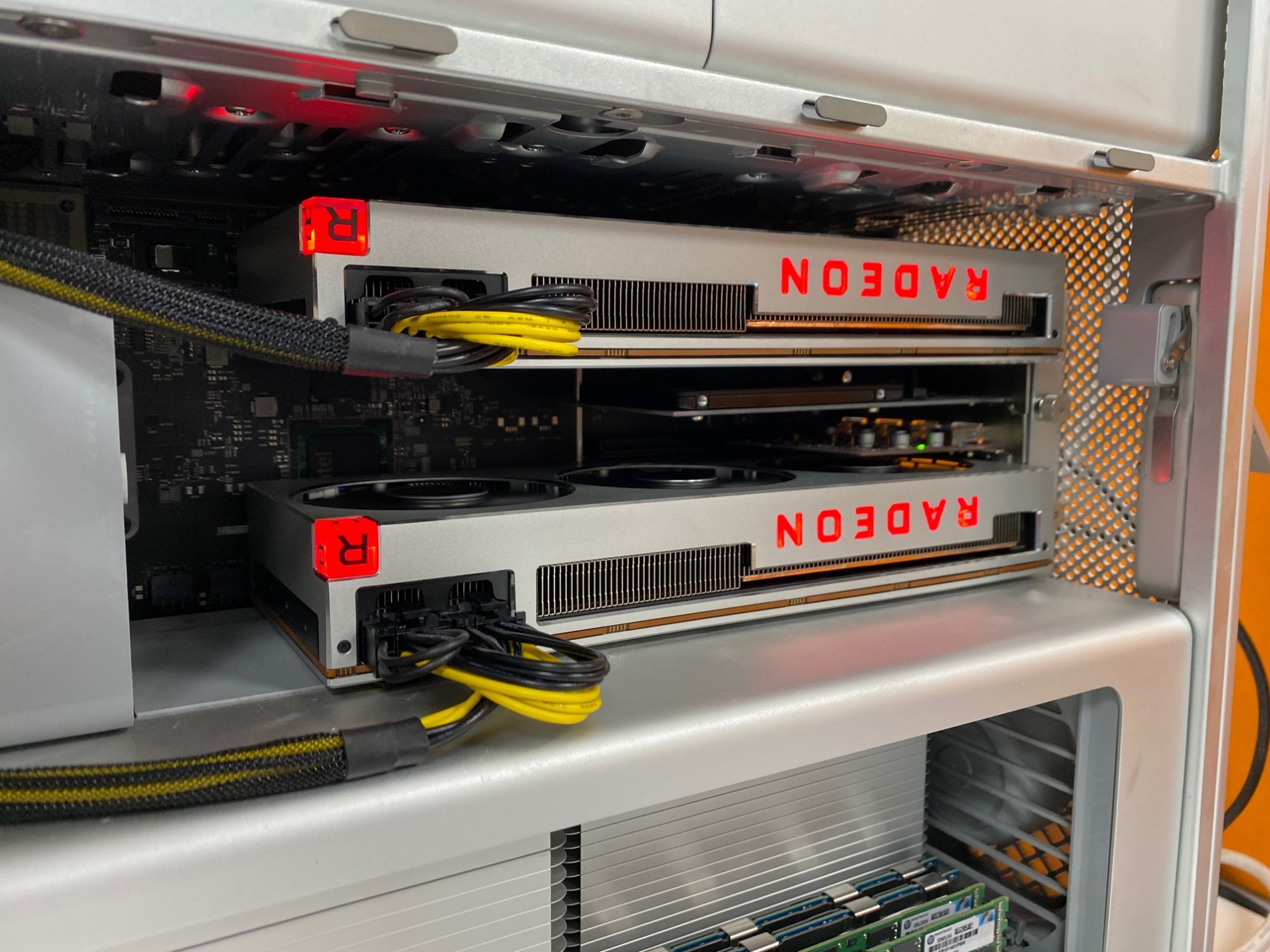

Hi guys, i registered an account just to let you guys know about my setup. I put 2 Radeon VII in my Mac Pro 12 core 2010 Mojave and it works like a charm! i did a lixlas mod then split it in to 4 8pins connectors. The Mac Pro PSU is 980w so it has enough power for 2 Radeon to run. the only thing is the fan is covered by the other card so i might want to put them in waterblock.
good luck to you whom want to do the same setup.

That lower card won't like running like that long term!
Configure it the same as I have done mine, there is zero difference using a 4x slot over a 16x slot for most apps, try it and see for yourself.
If you use a pair of long nosed pliers, you can easily bend the little metal tab at the top of slot 4 out of the way.

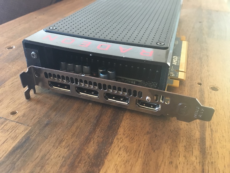

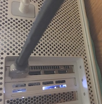

Hi @IanK MacPro -- it's very encouraging to see another cMP 5,1 build that embraces the use of Slot 4 for GPU installations. I have attached a couple of images depicting my approach to Slot 4 installation with a professionally machined GPU bracket to ensure both the appearance AND the function of the GPU was not compromised in any way. See my pictures.
Having said that I'm interested in your approach because it seems slightly different but equally clean and functional. Can you take a picture from the rear so I can see if your installation looks "flush"? I've got a number of new GPUs and I dont want to go back to the industrial metal cutting workshop if your approach/solution is as neat as it looks!!
Thanks in advance
PS - your PIXLAS mod cabling effort/arrangement is easily amongst the best I've seen. Was this careful assembly of multiple component parts OR were you able to purchase the materials in a [pre-packaged] kit..? if so - where (please)..?

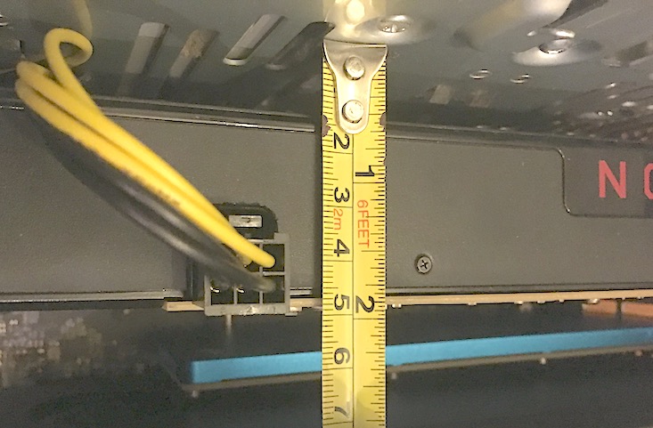

-- 15mm clearance
-- One method of preserving full access to backplane SATA II ports

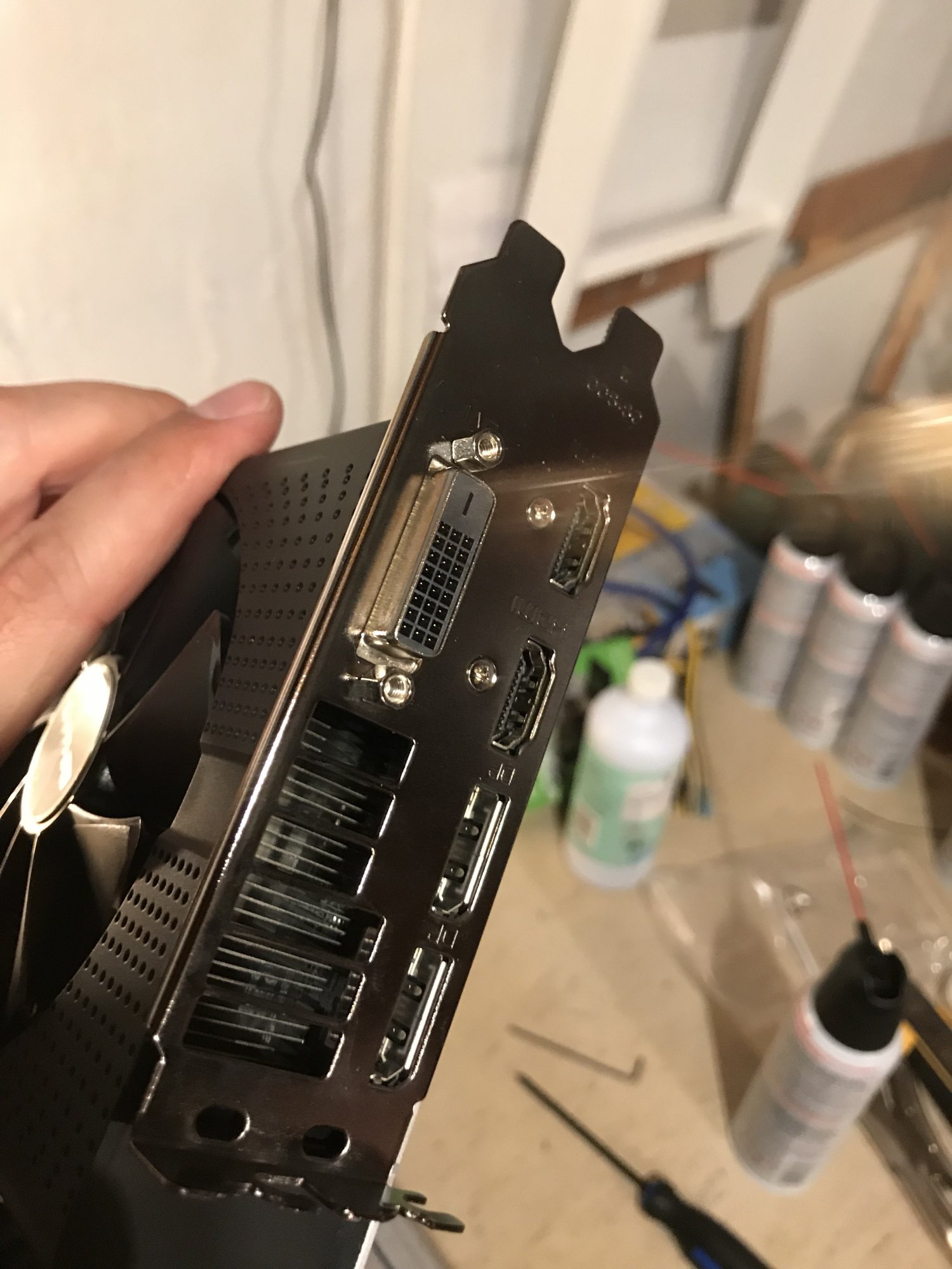

Yesterday i did the pixlas mod and wanted to install a second RX580 in my cMP. I wanted to have one GPU in slot 1 and one in slot 4 but unfortunately for slot 4 the DVI port on the GPU block the access of the PCI-e slot.
Is it feasible to remove this DVI port? If so is it complicated? A no go? What things i need to be careful about?

@tsialex i know that you post that i need to have the exact same GPU model (which i did) but i see that Sapphire sells a RX580 model without the DVI port, they call it “lite”. Other then that the GPU seems to be exactly the same.
I was thinking that i could sell the second one i bought with the DVI port and buy that “lite” version. That way i will be able to make it fit into the slot 4 without the needs to modify the backplate of the cMP which i don’t really wanna do.
What do you think? Should this model work (no dvi) with the DVI model?
Thanks.

Yes the card without the DVI port will take 2 slots also. But it seems that it would fit in slot 4 if it dont a slight modification cpuld make it fit but if i keep the card with the DVI port and want it to fit slot 4 a bigger modif is needed which probably incolve cuting the case. I don’t wanna do this.
Noobraino
macrumors member
May 25, 2020
33
1
Because it is a 2 slots cards, so the DP and HDMI ports fits into the last available access lane in the back of the MacPro (slots 4) but the DVI port is over these connections so it bump into the frame of the cMP (internaly) so i’m obviously not able to make it connect into the PCI-E lane.
