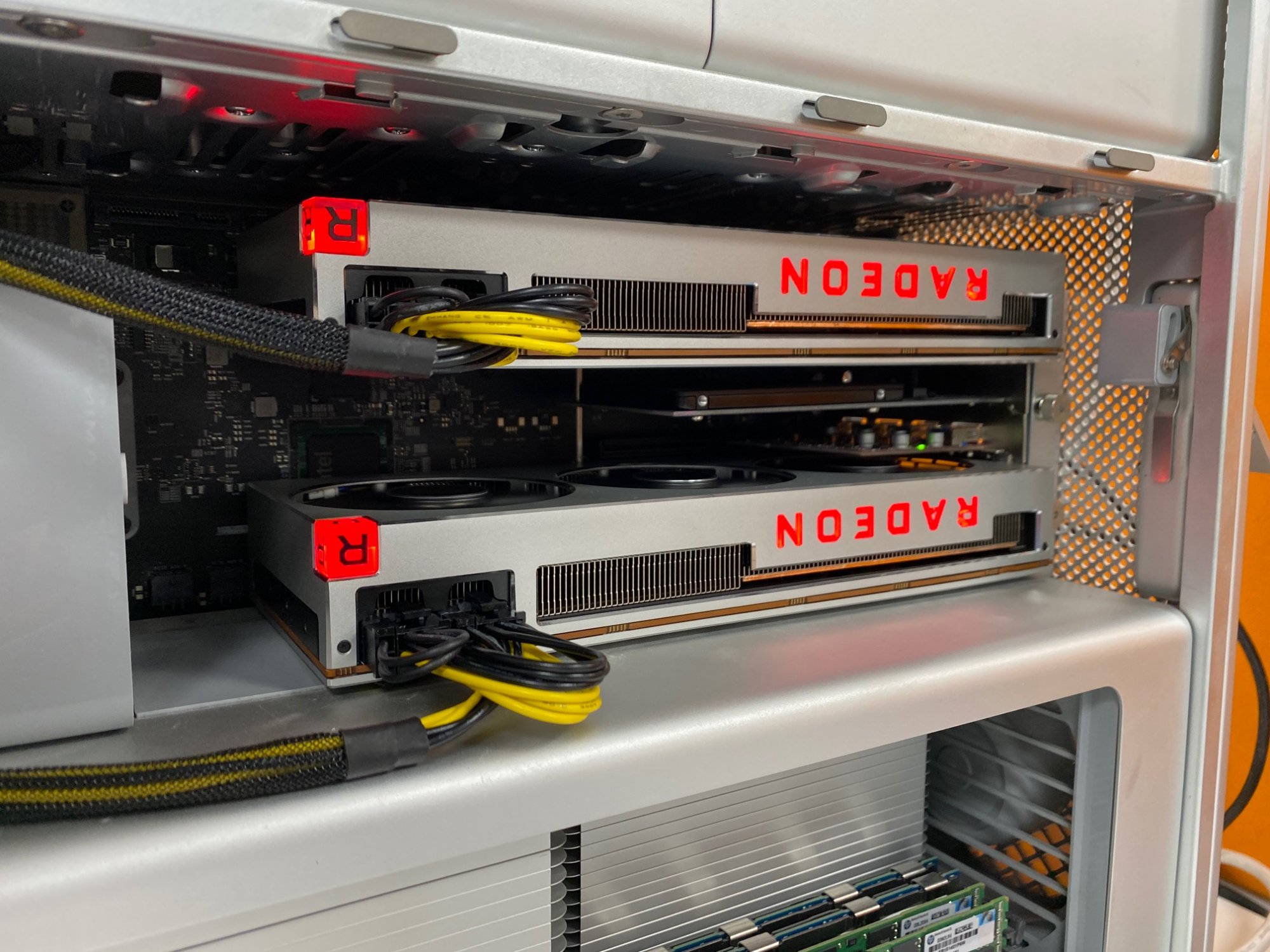

Alright, Radeon VII don’t go for less then ~1200$ CAD so i will probably go an other way. I already own a Sapphire Pulse RX5700 XT and i’m happy so far with it, content creation wise should i sell my 2 Sapphire Radeon RX580 and go for the same RX5700 XT or a Vega Frontier will be better? I know the later one is already 3 years old but they seems to go very cheap nowadays.
Will you not encounter the same problem trying to get it into slot 4?
Nah i won’t go for 2 cards in the same cMP if i sell the 2 RX580 for a Frontier or RX5700 XT.
But to answer your question, hypothetically if i would go for 2 GPU in the same cMP it would be much easier with these 2 reference models because they are smaller and have no DVI port.
So i would just need to bend a little piece of aluminium on the back of the cMP to make the card fits into slot 4.
Exactly like this:
Alright so i bought a new RX 5700 XT.
Now since i have 2, i’ll still want to test one of my cMP with both in it, just for the kick of it and some benchmarks.
I’ll have to make a double Pixlas Mod since the other cMP i got has a Dual 8 pins Pixlas Mod which will not be enough to power 2 (6+8 pins) cards.
Is a double Pixlas Mod is kindn of the same as a single, i just double the T-Taps on the PSU?
What should i be aware of?
Thanks guys.

I'd double the T-splitters so: 2 cables going down each with 2X 6+2 pins.
Note that you may get problems passing 2 Pixlas cables + 1 SATA cable through the hole in the bottom of the optical drive bay...
I assume you will have to leave off the aluminium cover in the bay due to the bulky clutter of cables and perhaps the optical drive sled may not slide all the way in ...

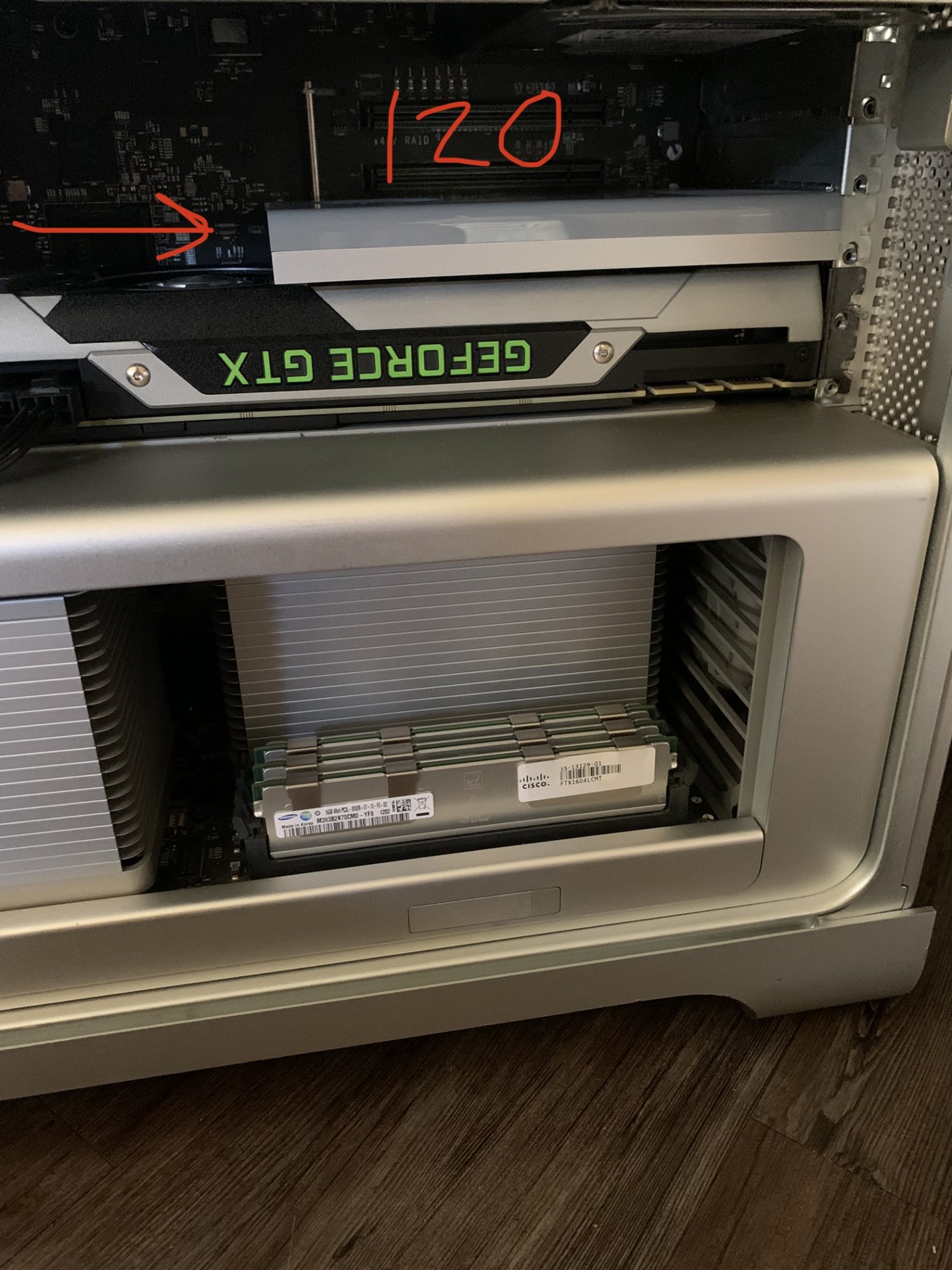

Hello, I do video editing. I have a similar combo (GTX980 slot 1/GT120 slot 2). How do I know which card is being used for what? In davinci, Premier and AE I can assign GPU but not in FCP7. In the software where I cant select the GPU, how do I know which GPU is being used on that software? I can do the opencore and all that but I like the GT120 because of the minidisplay port I can use directly to my Apple cinema display without frankeinsteining adaptors. Another weird thing is that in ABOUT THIS MAC, I can see the 120 but not the 980. However if I further click on “system report” I can see both cards in the list. I surely dont want to be using the 120 in FCP or Premier. This is my first time using dual cards. What card is doing what? Is PCI 1 the main? Or is PCI 1 exactly the same as 2? I know 3&4 are x4 so those are different. Or are they? Why are some of you installing a GPU on a x4 slot? Does that mean I could install the 120 in slot 3 for a bit of airflow to 980? The way I have it is not covering the fan though.

Is there a benefit in running both styles / vintage cards? Typically like cards offer better performance in applications that utilize such hardware, though my understanding of how the 5,1 handles Multi GPU generations is quite limited.
I only use the 120 for that minidisplay port that works great with my Apple Cinema Display. So that would be one benefit. Also, When I restart the computer having only the 980 installed, I don’t get the boot screen it looks like the Nvidia web driver resets to macOS driver. So with the 120 installed on top of 980, I always get that boot. I just want to know which card is doing what but for some reason, nobody seems to know this answer. Ive tried all kinds of facebook groups and forum searches. Its a complete mystery. I hope someone on here has an answer.
1. Which card is doing what if the software doesnt allow GPU selection?
2. why is the 980 not showing in “about this mac” but it does shows in “system report” list.
3. Are PCI SLOT 1, exact same as PCI SLOT 2? or does mac default to either as a priority?
4. Can I install the 120 in slot 3 being a x4 PCI?
1) Depends on the software. Therefore, no one can answer your question apart from the developer.
But in general. If the software can utilise multiple GPU, then all GPU are in use. Otherwise, the GPU that connected to the monitor which displaying the software is in use.
2) Because you installed both GPU, and GT120 is higher priority
3) Same. In your case, no.
4) Can
Not necessarily, some apps will happily use different cards but FCP only likes perfectly matched pairs of GPUs.
When I had a W5700X and 5700 XT in my 7,1 it was one or the other.
FCP can use multiple uneven GPU, I tested that myself.
