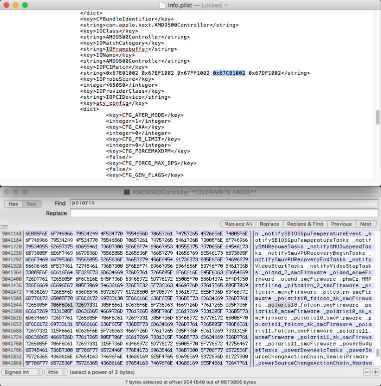

Guys, I have a question for you all. Is it possible, that even there are Ellesmere traces in the system KEXT, the reason why the GPUs are not working is because they are not exactly the same thing what Apple can put in the computers?

This is the screen cap of info.plist and controller file inside AMD9500Controller.kext. I have been curious of what 67C0 might be. It's a Polaris 10/Ellesmere card but higher end than RX 470/480 (67DF).
Two possibilities - 67C0 could be a dual GPU or GDDR5X variant, most likely named RX 490.
I read an article a while back which mentioned earlier in development, AMD didn't finalize the Ellesmere name to Polaris 10 and in general was referred to as Baffin XT. Apple probably didn't bother to change this.
Baffin = Polaris 11 = 67E0, 67EF/RX 460, 67FF ==> for MBP
Ellesmere = Polaris 10 = 67C0, 67DF/RX 470/RX 480 ==> for Mac Pro/iMac
Apple did that before, but in some other way: device IDs of 7xxx cards were recognized by 10.9.x as Dxxx cards until nMP release. Dxxx cards share device IDs (and GPUs) with some of 7xxx cards but drivers are recognizing each series differently.
BTW, AMD9500Controller at current (released) development stage (10.12.1 Dev Beta 3) doesn't contain any nMP-specific framebuffer personality (6x mDP + HDMI). But AMD9000Controller does. 2 complete and 1 incomplete personalities since 1st Sierra beta. This could mean something or nothing.
