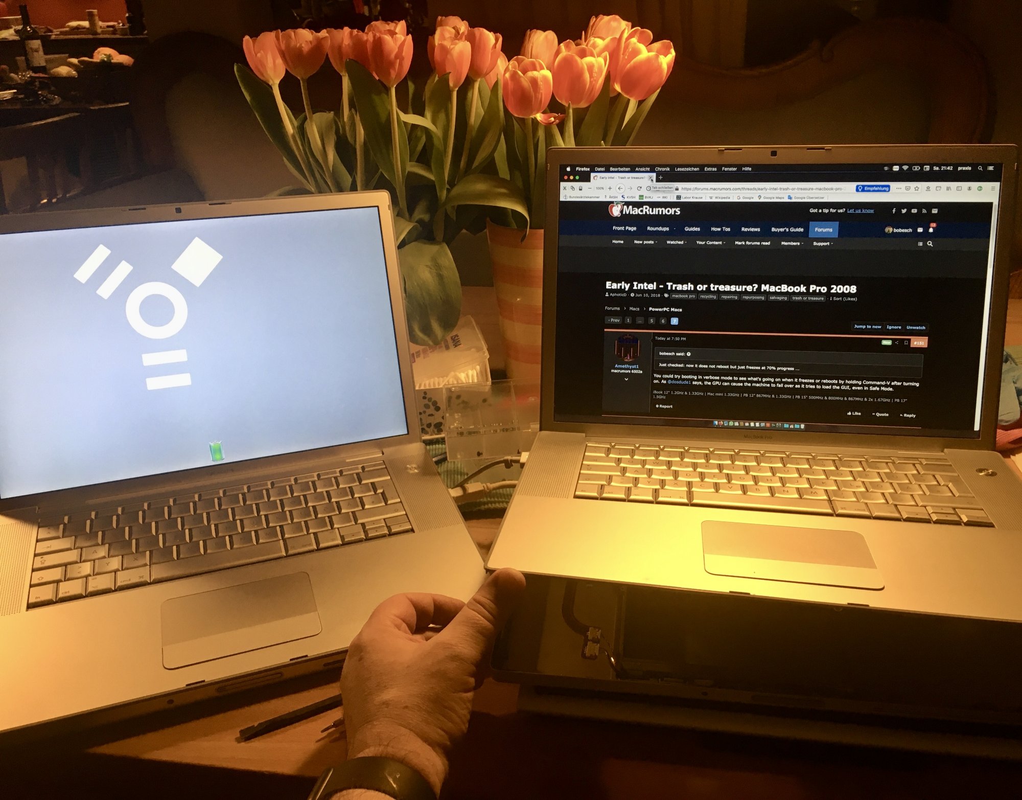

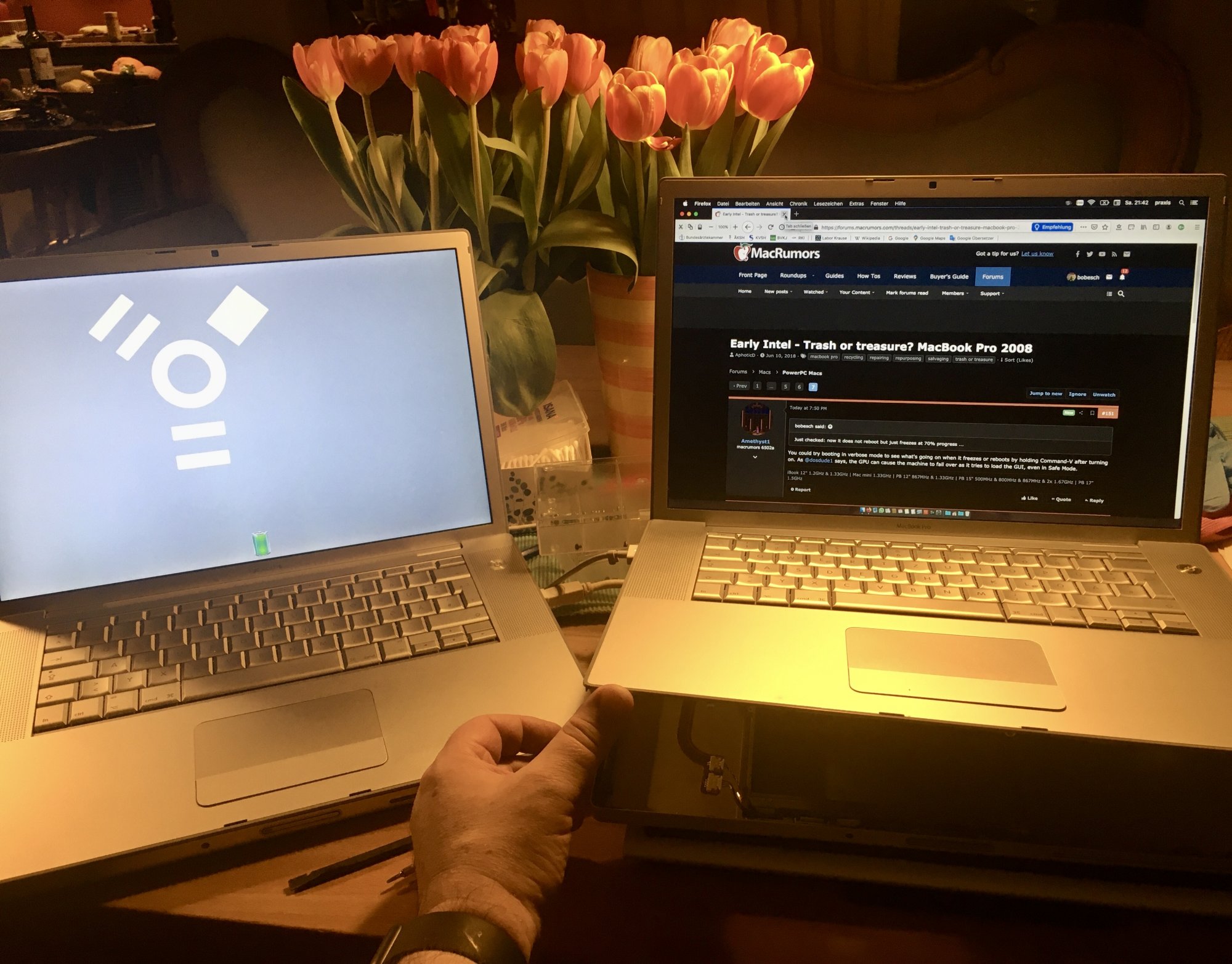

Just checked: now it does not reboot but just freezes at 70% progress ...
You could try booting in verbose mode to see what's going on when it freezes or reboots by holding Command-V after turning on. As @dosdude1 says, the GPU can cause the machine to fall over as it tries to load the GUI, even in Safe Mode.
@dosdude1 & @Amethyst1 : thanks for your help!
And thanks for encouraging me to go after the GPU !!!
I know, my choosen workaround 👨‍🍳 is just a temporary fix, but it did work and it's for personal use only ...
Well I'm typing this on the fixed MBP4,1 A1260 just now 😊
and I'm happy to have another option for an additional Mobile/Home-Office workspace.
Thanks a lot guys and stay healthy!
