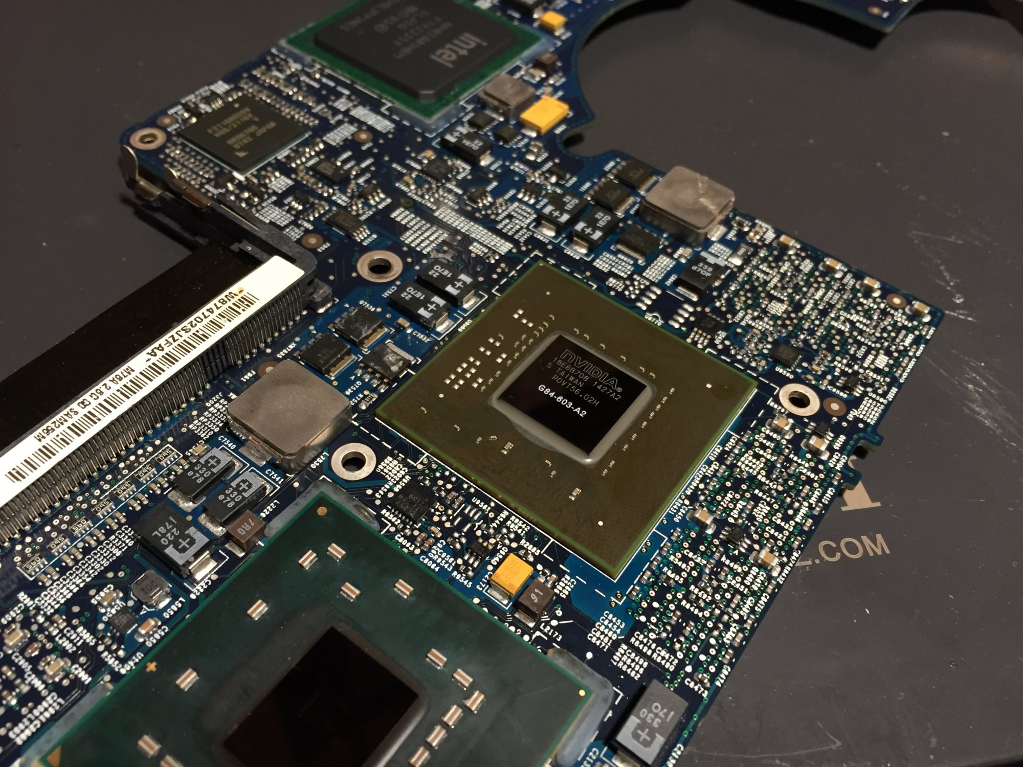

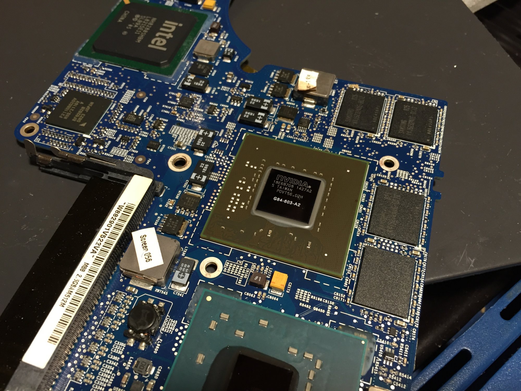

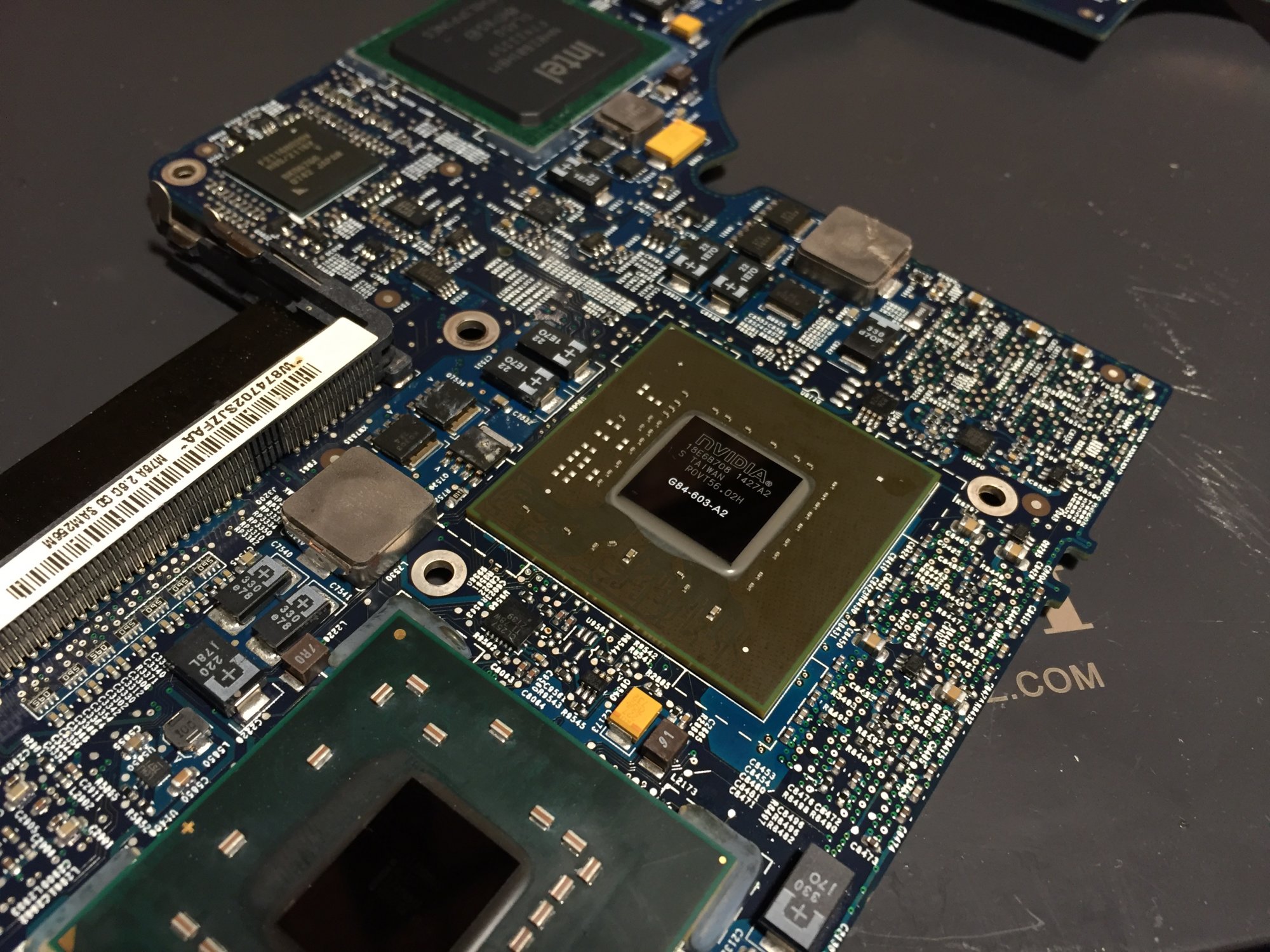

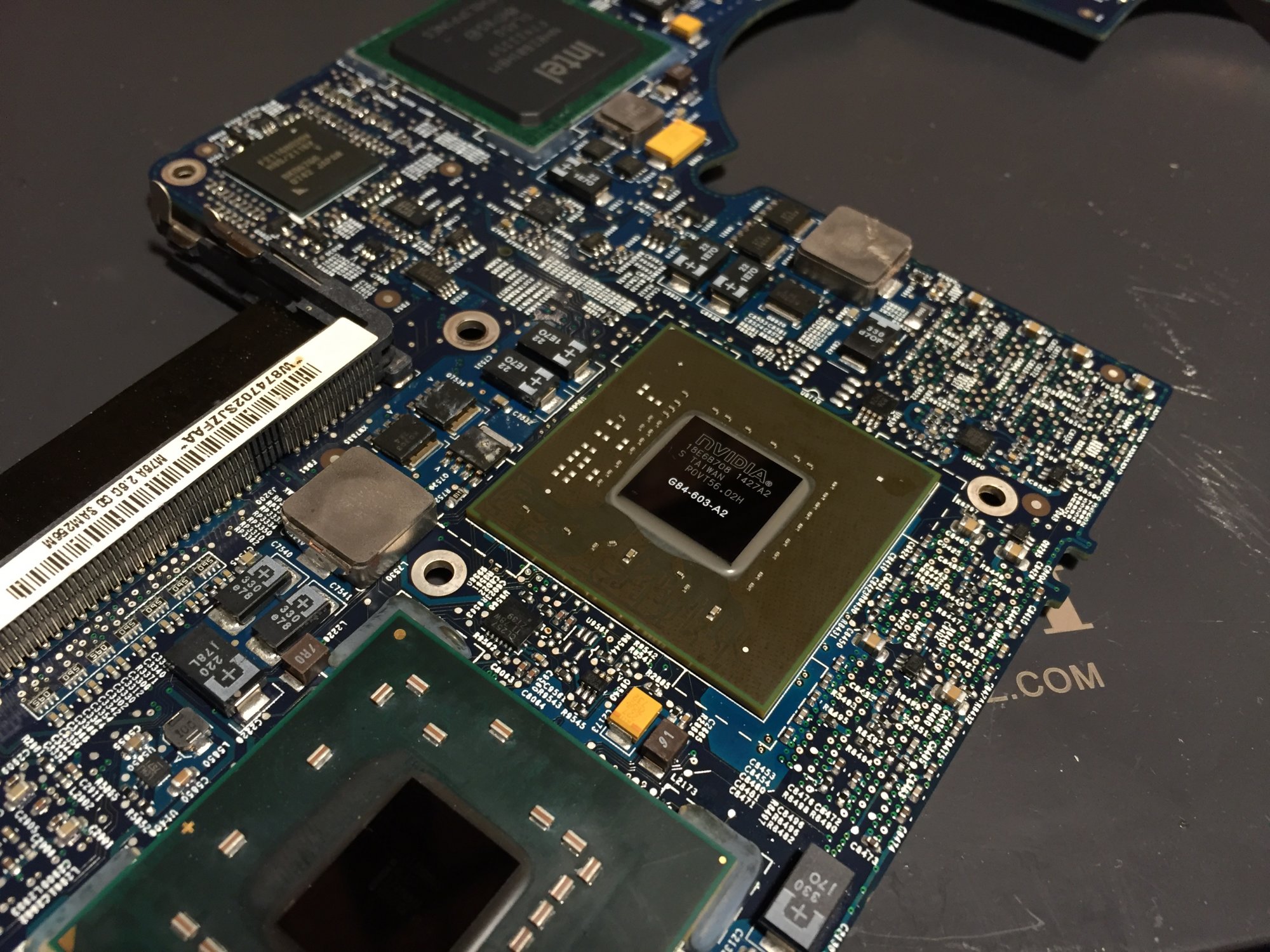

Just resurrected two more machines! One 2007 and one 2008. Both 17".

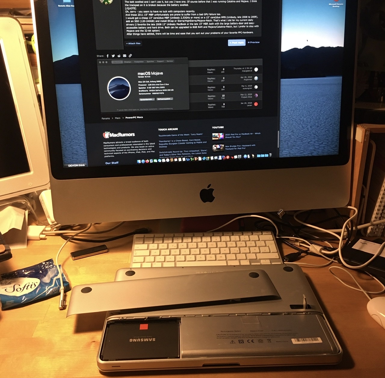

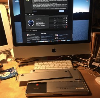

The batt swelled and I can’t use it, but yes I have one. Of course before that I was running Catalina and Mojave. I think the trackpad on it is broken because the battery swelled.
Oh, sorry - you seem to have no luck with computers recently.
And those 2011 15" MBP unfortunately are prone to suffer from a bad GPU failure too.
I would get a cheap 13" core2duo MBP (Unibody 2,53GHz or more) or a 15" core2duo MPB (Unibody, late 2008 to 2009), add an SSD (120-240GB) and install ElCap or Sierra/HighSierra/Mojave-Patch. That's what I did for my current daily drivers (I favorite the late 2008 13" Unibody MacBook or the late 15" MBP, both with the large battery-door and easy-accessible battery and hard drive. Both can be upgraded to 8GB RAM and Mojave/Catalina-Patch, but I prefer to stay with Mojave and the 32-bit option)
You can also disable the faulty GPU and run on the integrated HD3000. You lose the ability to connect an external monitor but... my point is - the 15" 2011 MBP's quad-core i7 runs circles around any Core 2 Duo. No need to waste spend money on a C2D MBP if there's a much faster one around already - assuming that one is working or can be repaired. 🙂

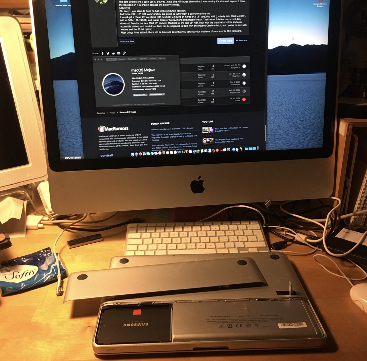

I have a 15" mid-2012 i7-quad for heavy duty tasks (batch-scan/OCR; video-editing) - but nearly all of my regular tasks can be done on a Core2Duo. The late2008 13" MacBook Unibody is meant for a mission critical home-office job, where I don't dare to have an A1260 suddenly fail.
Unfortunately two 24" white iMacs failed during the last 12 months and need service. They were on duty nearly 24/7 for about 3 years ...
I hope, I'm able to fix them, but if the job needs soldering, replacing bad caps etc. they'll have to wait, until I have more time and finally skills and equipment.
So that cheap late-2008 24" 2,66GHz c2duo iMac (8GB RAM/250GB SSD) is filling the gap as my main workstation in the office. It carries a few DEVONthink databases, that are shared within the network through Bonjour/Safari.

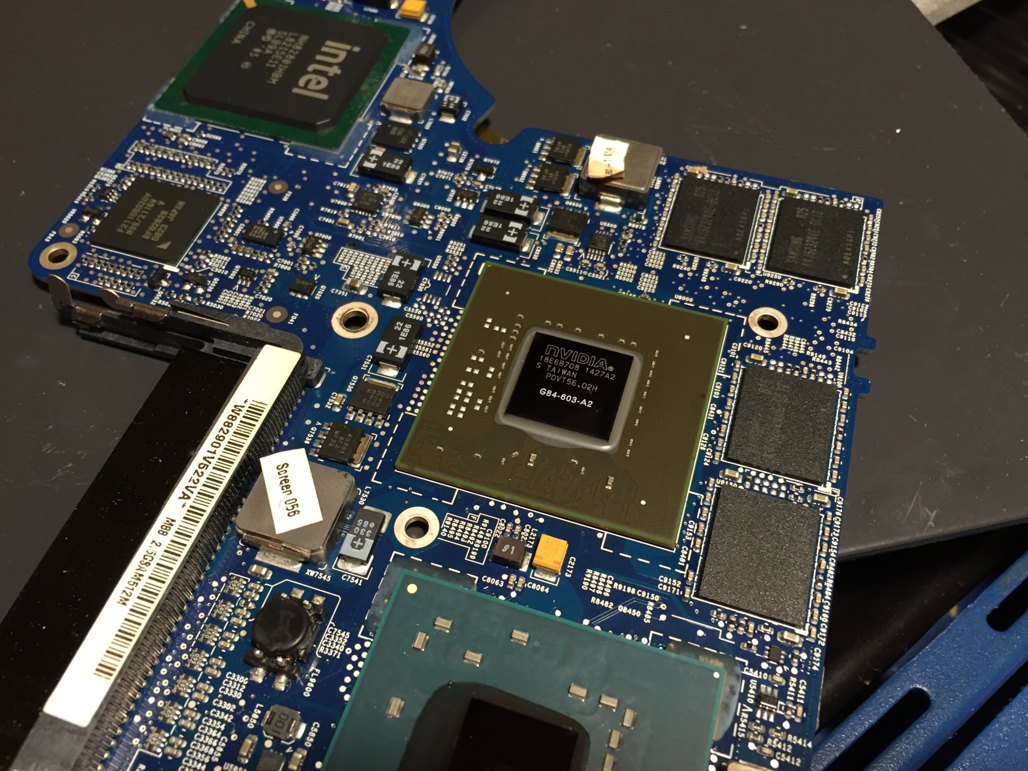

Ahh man the GPUs on those 24" white imacs are pricey. The repair takes some time and space but overall is straight forward. Once I repaired my well loved 24, I have been gun shy about bringing it back to DD duties because of the GPUs fragility. I like the intel AIOs but man they all seem to fry themselves eventually regardless of maintenance. I also had a PSU fail on another but that was an easy and cheap[er] fix as I didn't have to remove the logic board to get to it. I've slowly shifted back to towers anymore - if for no other reason, they're dead simple to work on and parts seem to be cheaper. I wish you the best of luck resurrecting your 24" white imac @bobesch.
With all of the GPU related issues we see with early intel stuff, my aluminum 2008 MacBook is still chugging along like a champ (lol knock on wood). I have been very happy with that machine as I got it for $500 in 2009 from my wife's friend @ Uni. Aside from munching batteries like no one's business, it has been a very stout design.
