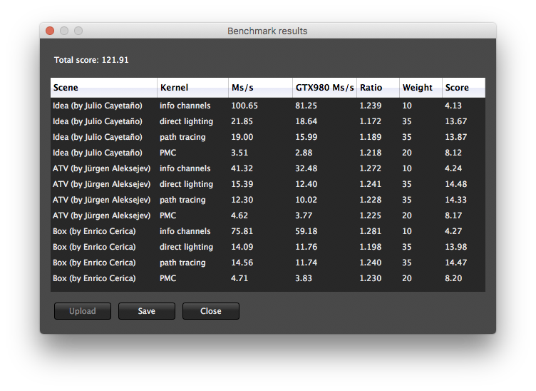

The results of the GTX 980 Ti Hybrid attached to nMP (average is approx. 125) in OctaneBench:

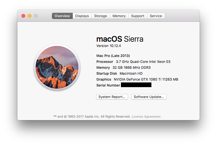

And here it is! It really was very simple, the only head-scratching part was the DP port I plugged my cable into didn't become active, so I plugged the cable into a different port on the card and boom, works.
Time to run some benchmarks, methinks.

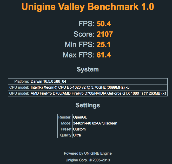

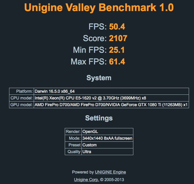

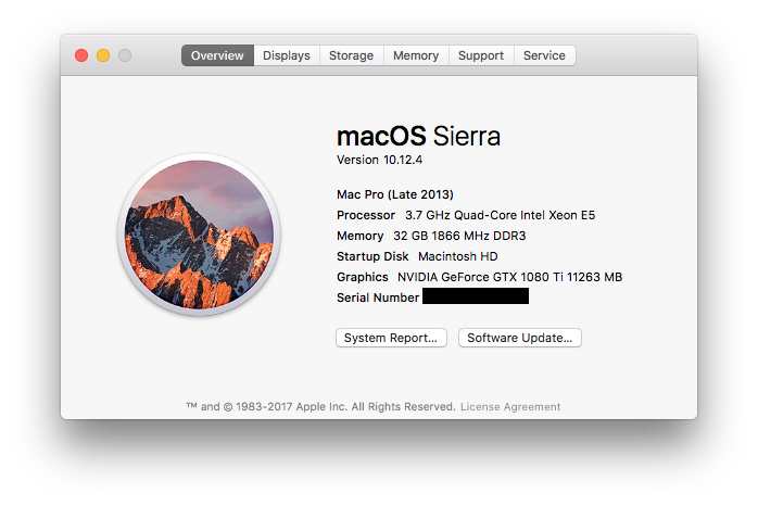

EDIT!!!: I messed up and had v-sync enabled in Valley. See my post later in this thread for the better results.
Pretty awesome so far. :) I don't have the paid version of Geekbench so I can't test Metal with that and OpenCL chokes with the web driver (Known issue).
