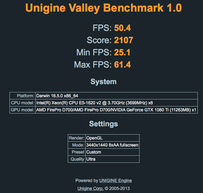

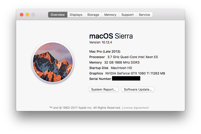

And here it is! It really was very simple, the only head-scratching part was the DP port I plugged my cable into didn't become active, so I plugged the cable into a different port on the card and boom, works.
Time to run some benchmarks, methinks.
[doublepost=1494910657][/doublepost]Pretty awesome so far. :) I don't have the paid version of Geekbench so I can't test Metal with that and OpenCL chokes with the web driver (Known issue).

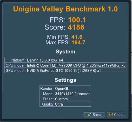

Just wanted to do a native 1080Ti v eGPU 1080Ti comparison.
I believe I got the same settings in Valley.

Oh also this card is the nVidia (not 3rd party) 1080 Ti Founders Edition. All stock clocks and BIOS atm.

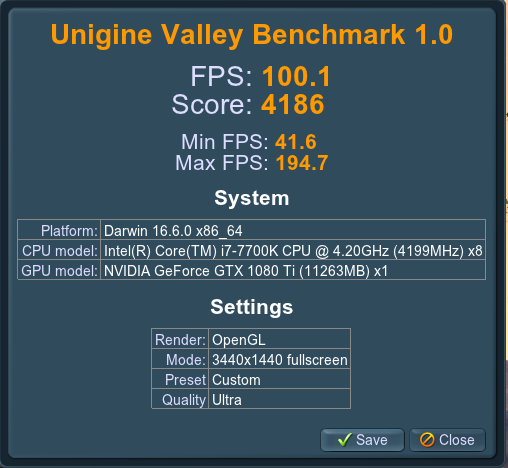

I was going to say that's a crazy difference...then I noticed that you had AA turned off whereas I ran with 8xAA. Would you mind running with the same settings only add 8xAA as well? Then the settings should be the same. :)

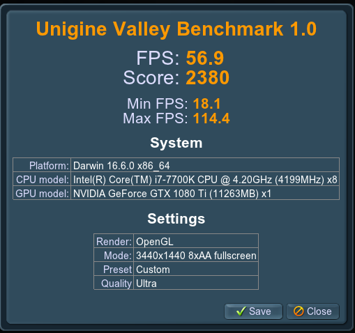

Ahhhh I missed a setting. Yes let me go back and redo
[doublepost=1495213552][/doublepost]Ok. This one is a bit closer.
Not sure why my minimums took such a hit. May rerun it later on a 2nd time to see if there are any changes.
