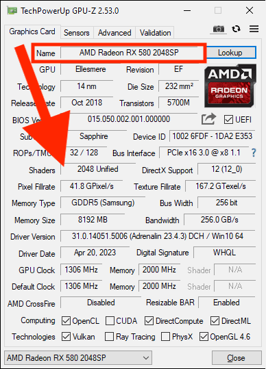

This does not make sense since EnableGop and MacVidCards only block pre-boot configuration support, the GPU works after macOS loads the drivers.
Maybe you have defective GPUs or you have RX 580 2048SPs that are not compatible with macOS. These are in reality RX 570 GPUs which the GPU firmware was factory modified for the Chinese market.
Now with AliExpress, these 2048SPs GPUs are everywhere and macOS DOES NOT support it, macOS release won't matter - it's not supported, period.
See a Sapphire RX 580 2048SPs, that does not work with macOS:

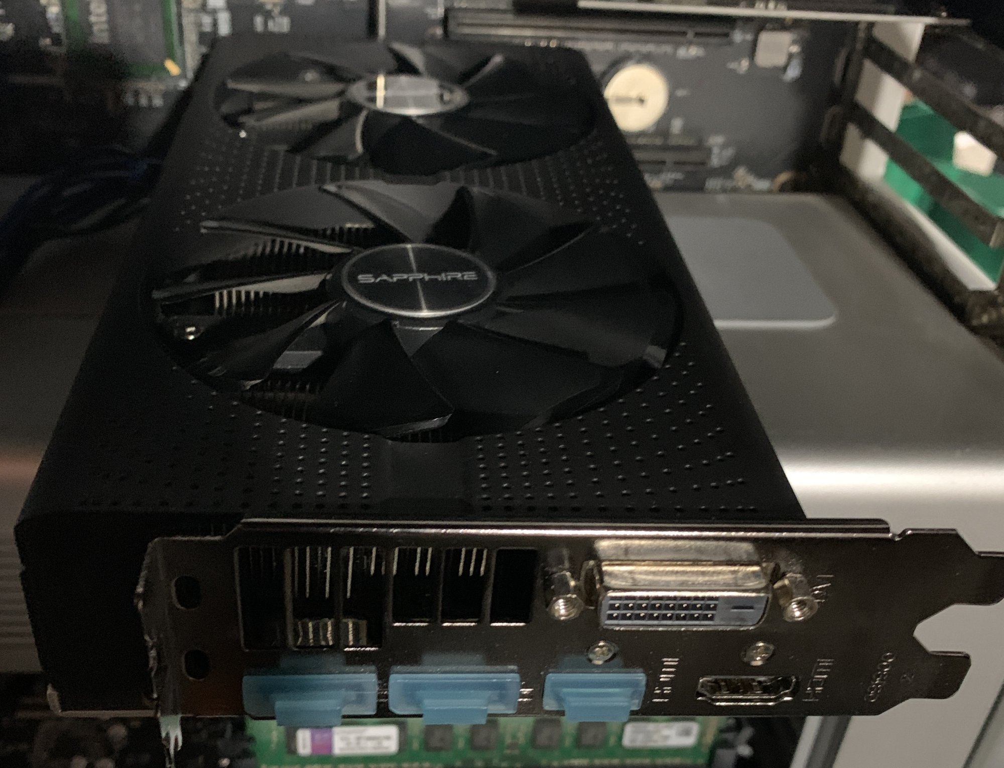

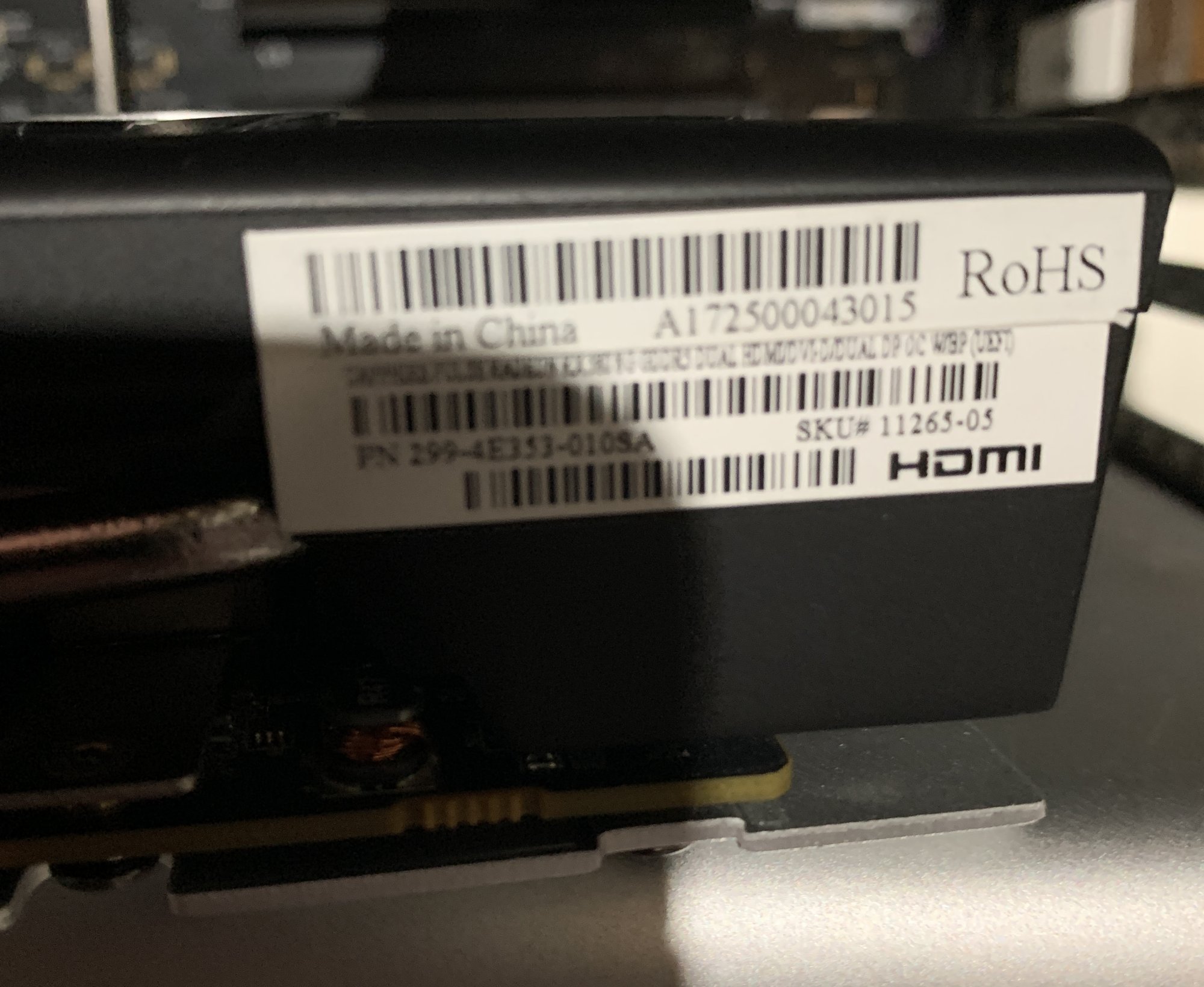

Update:
Well turns out I can only boot into Mojave and HS... Look like the VBIOS on the 2 PC RX580 cards are only semi-compatible with my setup.
I tried to boot into windows 10 but no go there and I dont have a windows machine.
Here's a pic of one of the cards.
Do you think I can flash these cards?
Thanks for your and everyones help here!
tsialex
Contributor
Jun 13, 2016
13,461
13,613
Update:
I tried to boot into windows 10 but no go there.
Sapphire part number 11265-05 is for the real Sapphire Pulse RX 580 2304SPs, 0x67df 0x00e7, if the GPU firmware is unmodified, works fine with macOS.
If it's not working, or the GPU is defective or someone flashed a mining firmware. Try to re-flash it with the correct GPU firmware from TechPowerUp.
If you can't boot Windows, use a PC that have integrated GPU or try to boot Linux. There are previous posts here with everything outlined already.
BTW, do you have BootPicker if the card is installed to a Mac Pro with EnableGop injected?
