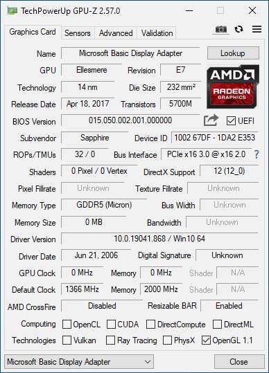

One more clue showing that the card have a mining firmware.
Yes, but only with Windows or Linux.
Oh boy.. I need to know what bios to flash on my RX580 card.. Heres a pic
Thanks Alex
Thanks Alex
No one can guess that for you based on just this screenshot, you have to investigate.
You can wholesale test each one of the GPU firmwares available on TechPowerUp and find one that works with your card, or you can remove the heatsink and and see the exact VRAM chip the card has and then narrow it down to the dumps with the same VRAM maker, this will greatly minimize the number of tests you gonna need to do and you can also clean/repaste/change thermal pads/etc your GPU.
Btw do not assume that since your card heatsink have a label with the part number that your card is that exact one unless the tamperproof label over the screws are immaculate. People who have crypto mining rigs frequently change heatsinks between cards. Do not assume anything, double check everything.
This thread already have all the info on previous posts, just browse it. Doing this is a lot of work, but is the price you pay to buy a second hand GPU.

No one can say that for you, you have to investigate. You can test each one of the GPU firmwares avaliable TechPowerUp and find one that works with your card, or you can remove the heatsink and and see the exact VRAM chip the card has and then narrow it down to the dumps with the same VRAM model.
This thread have all the info in previous posts already, just browse it until you find it. Doing this is a lot of work, but is the price you pay to buy a second hand GPU.

UPDATE:
Alex!
Holly Crap I did it! I flash the bios on these cards using a cMP 5,1!!!
The only bios that would take was: Sapphire.RX580.8192.171120.rom
1. I put the RX580 in the 5,1 and I use an original apple AMD card to boot into windows to do this!
2. I took a second cMP and used it to power the apple amd card!.
3. The bios was wrong and now enableGOP works with both RX580 cards!!!
4. Sonoma and Windows 11 ALL working great!! Thanks!!
Note: This was the only bios that would take for my cards
Reactions: tsialex and Bmju

UPDATE:
Alex!
