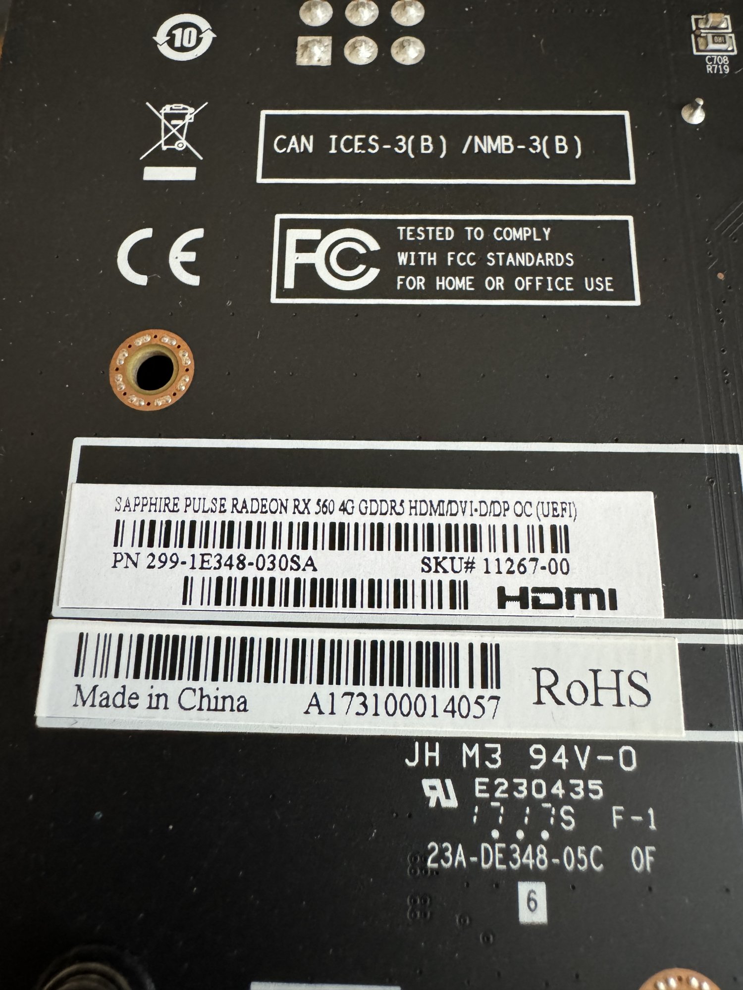

Please post the maker and model of your RX 560, so people will find it when searching for similar issues. Even better if you could take a photo of the label with PN/SKU/firmware version.
Sapphire RX 560 4GB
