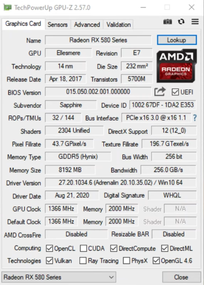

Thank you for the answer.
I did note install opencore.

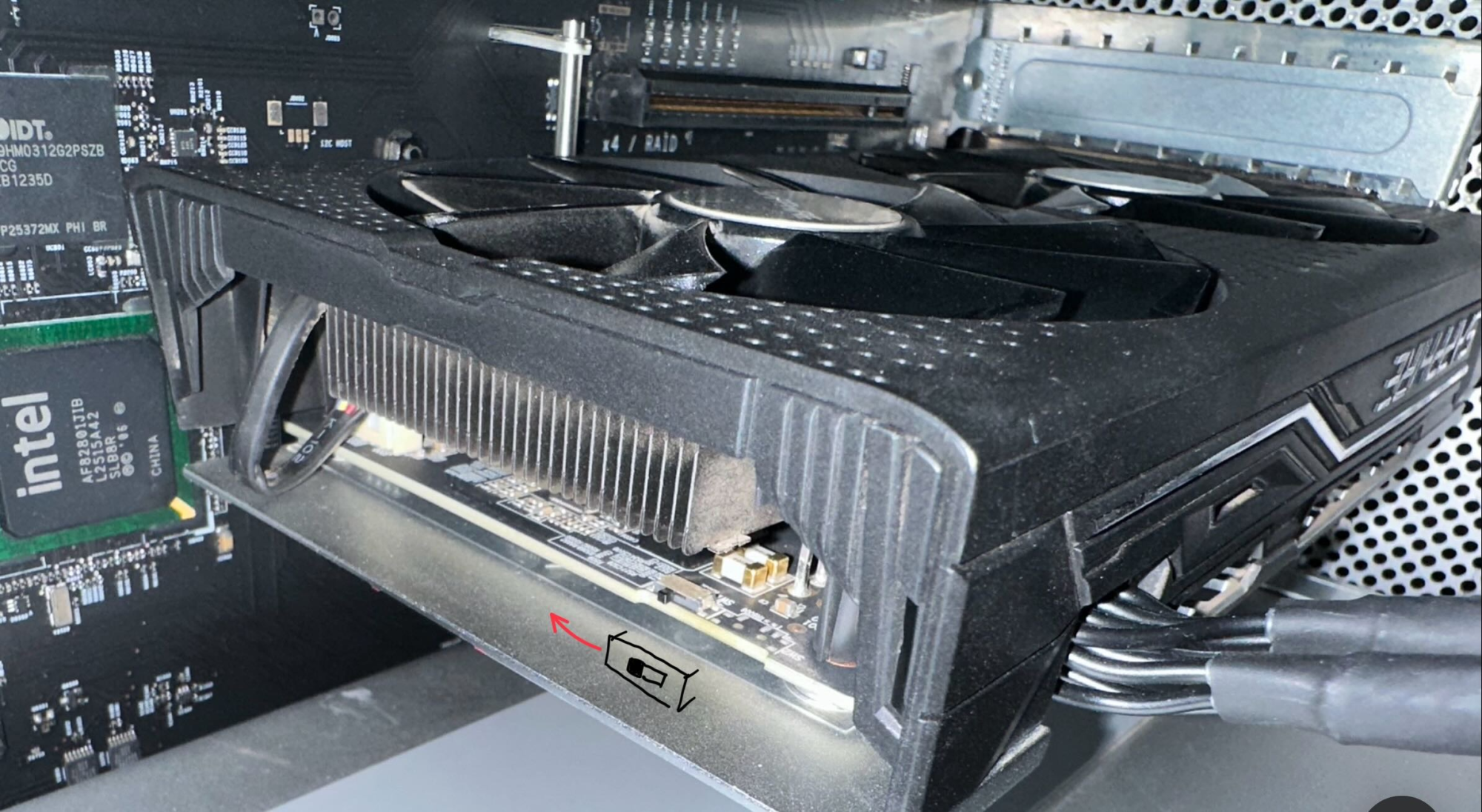

I followed the steps while the switch was set to left position, Show you in the picture.
I checked with GPUZ on Windows and got the results as shown.
I think I have it set in gamming mode. because the result is displayed as UEFI
I still don't see "Native Pre-Boot Graphics Screen", I understand that this is GOP, right?
Please give me some advice.

seems you have it in gaming position.
As said, get your GPU bios sorted, I guess it was modded.
I dont think the GPU-Z tool has a data point for Gop validity.

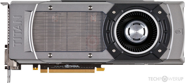

Hi.
Anyone was successful with geforce titan?
Patching working(tested on rx 580)
But not bootscreen
Tested on rx 470, 580, working
But not on titan
Hi.
But not bootscreen
But not on titan
Remember that Kepler GPUs were released a year before UEFI 2.3.1c being ratified and the factory flashed GPU firmware were not even UEFI compatible, requiring firmware updates. Most eVGA Kepler cards are like that, even the GTX 680 Mac Edition is not UEFI GOP compatible.
Besides some OEM GPUs, only some very later made NVIDIA Kepler and most Maxwell are really UEFI GOP compatible and a lot of the cards of this era require adding a GOP module to the GPU firmware.
Check if you have the most recent GPU firmware for your card before anything.
Reactions: 0134168
I done this on beginning, still no go
Rom to big or out of range when flashing
Patcher don't show any errors
