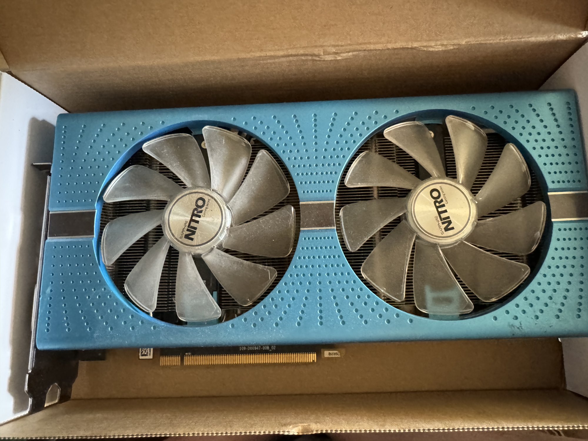

Dear @tsialex , once again, for a change, you were right. Although I dont understand.
I had in that mac two graphics cards, a Vega 64 , and another RX 570. And I switched then often and no problem. Simply, Ioften appears a windows saying about reinstall root patches. If not, i uninstall them , switch card, an boot always.
Withbthis model , imposible. I tried simple switch. Then uninstalling root patches. Nothing.
The only way is yours. Belive me I was sceptic. But a clen install worked like charm. So weird. Then I uninstall root patches, used Migration asistant and all as before but with thw new card. Both DVI´s are 2x, so no adapters needed for my two HD Cinema 30"
Why a RX570 is fine to switch and not the other
Buy the way , for those who are wondering why change a RX 570 for another one....__::
Well, this model I had is not stabdard size, about 4mm thicker, So I lost a PCI port. No way.
This new one is standard size.
So, if you need all your PCIe slots, dont buy this one.
Thank you so much for your help, @tsialex
