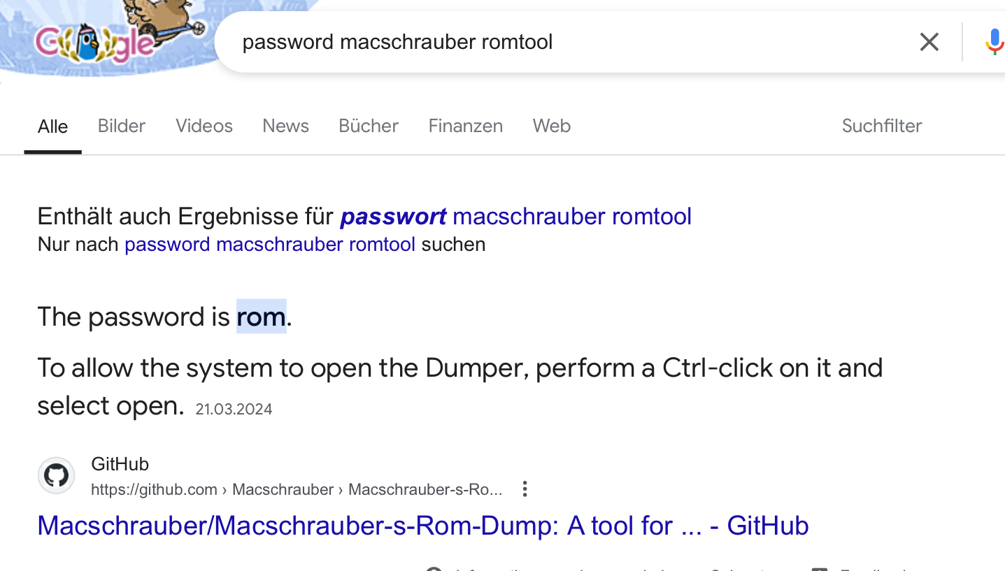

  1. ROMTool (credit to dosdude. Password to unzip is rom)

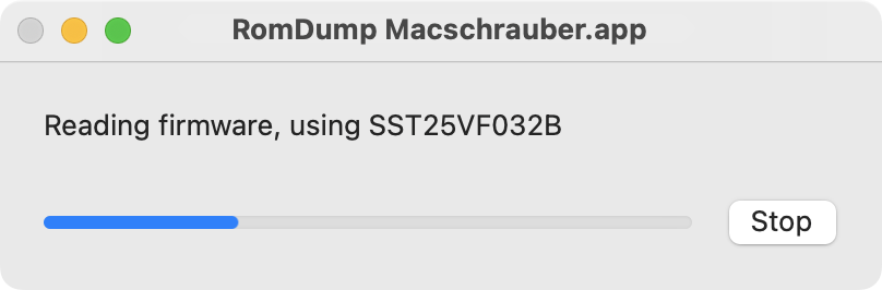

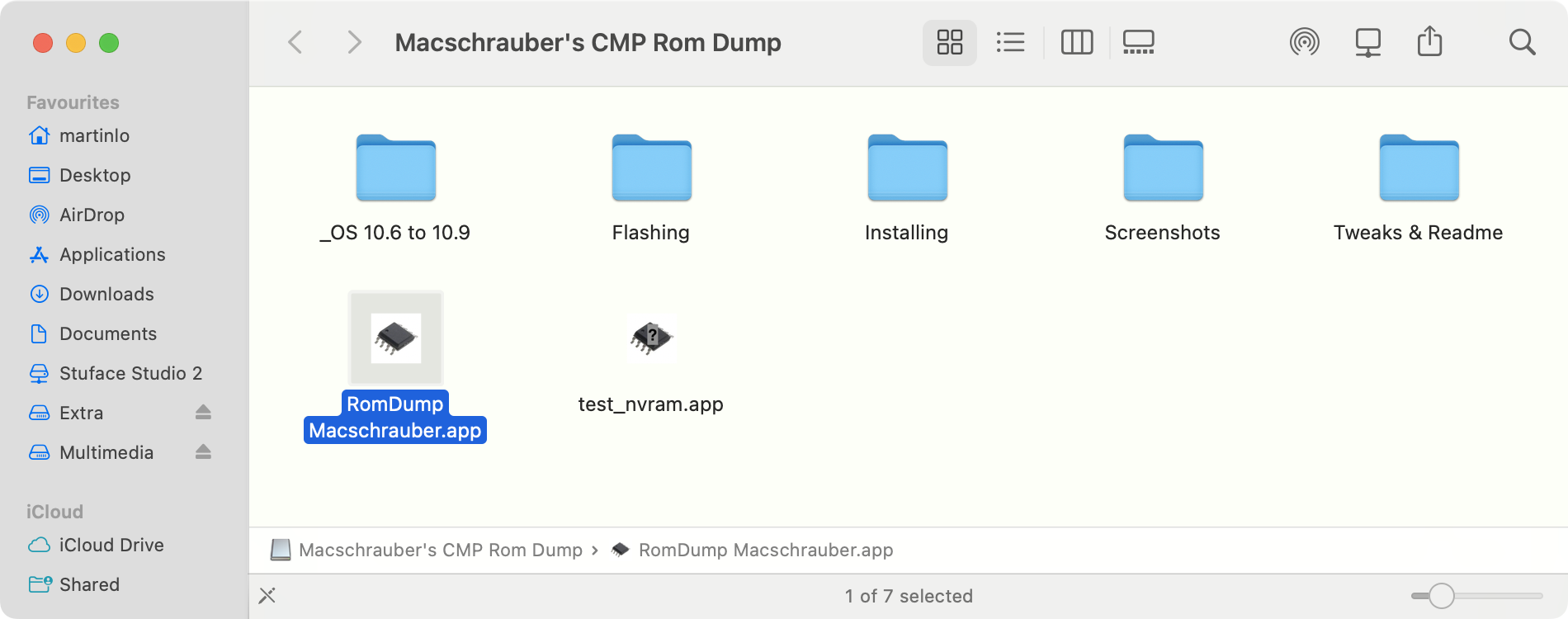

Prepare your Mac Pro 5,1's ROM image. Ideally, you already has a clean / reconstructed 144.0.0.0.0 ROM image to start with. Then you can skip this section, and jump to section C below. Otherwise, there are few ways to dump the existing ROM, but the recommended way in this post is to use RomDump Macschrauber.

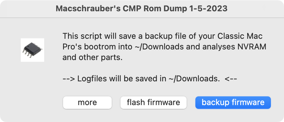

  1. When you open the DMG file, you should see something like this. All we need is just run the app.View attachment 2196376
  2. When you run the app, you should see something like this, the default option should be backup firmware, just press "Enter" to continue

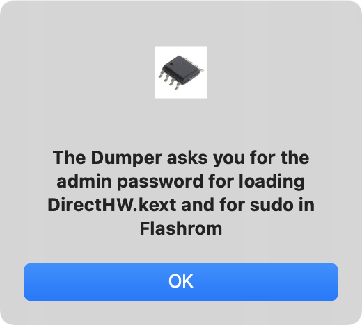

  3. It will show you a window about require admin password, please follow the onsreen instruction and enter your admin password. Depends on your Gatekeeper setting. macOS may ask you to restart your cMP.

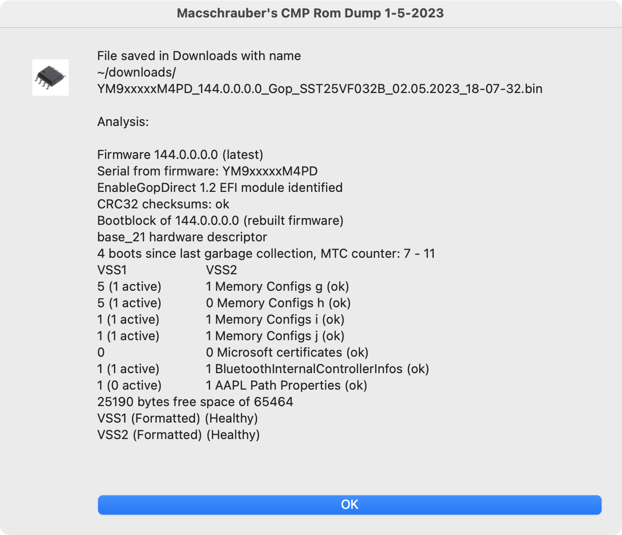

  4. Then RomDump will read the ROM image from the chip, and save it in your Download folder
  5. Once it's done, you should see something like this
  6. As you can see, the file name is XXXXXXXXXXXX_144.0.0.0.0_Gop_SST25VF032B_DD.DD.DDDD_TT-TT-TT.bin in my case. Your dump will have a different name (XXXXXXXXXXXX is the full serial number of your Mac, DD.DD.DDDD is the date, TT-TT-TT is the time).
    In finder, right click the bin file, and select "Get Info", check the file size, it MUST be 4,194,304 bytes. If not, something is wrong. Stop here.
    Apart from that, please take some time to read the report.
    The firmware MUST be 144.0.0.0.0. If NOT, stop here, update your cMP's BootROM first.
    There should be zero Microsoft certificates. If NOT, stop here, fix the bootROM first. My suggestion is to request help in this thread.
    Similarly, check the BootROM's free space. In my case, 25190 avail. If that's lower than 20000, please perform a 4x NVRAM reset, then re-do step B1-B5 to dump the ROM, and check again. If the free space still low, then something is wrong, please go to this thread and ask for help.

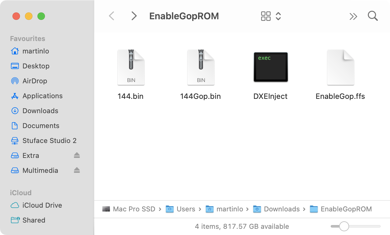

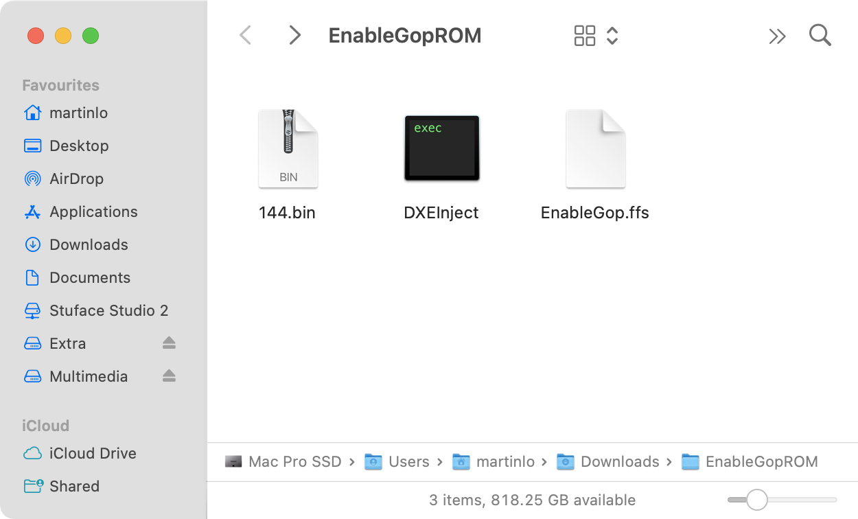

  1. In Finder, we open a new folder inside the download folder, and name it EnableGopROM
  2. Move your 144.0.0.0.0 ROM image (e.g. the bin file dump from step B5) into the EnableGopROM folder
  3. Rename the bin file to 144.bin
  4. Move DXEInject to the EnableGopROM folder
  5. Move EnableGop.ffs (or EnableGopDirect.ffs if required) to the EnableGopROM folder
  6. The result should looks like this

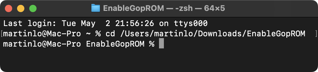

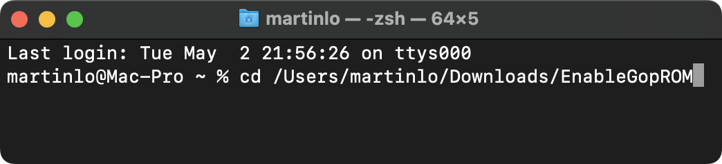

  7. Open Terminal
  8. enter "cd " (cd with a space)
  9. drag the EnableGopROM folder into the terminal window
  10. It should looks like this
  11. Press enter
  12. Enter the following command into terminal (please enter the exact file name of EnableGop.ffs, e.g. including the version number if EnableGop.ffs is updated)
    Code:
    ./DXEInject 144.bin 144Gop.bin EnableGop.ffs
  13. Nothing will return in terminal. However, if you check your EnableGopROM folder now, you will see the new 144Gop.bin file is created

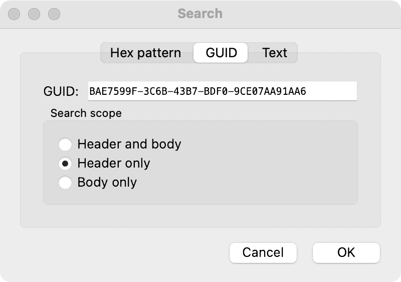

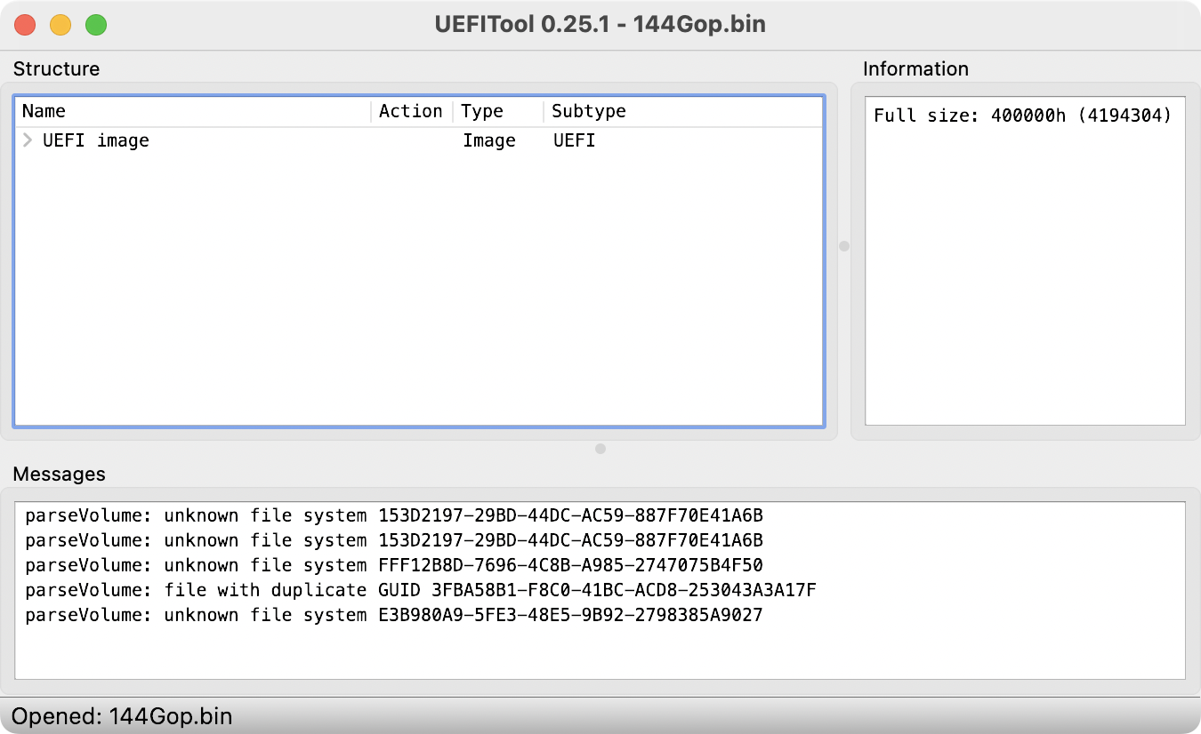

Now we can varify if the 144Gop.bin is created correctly

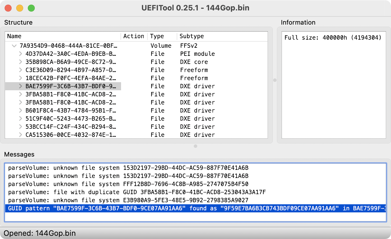

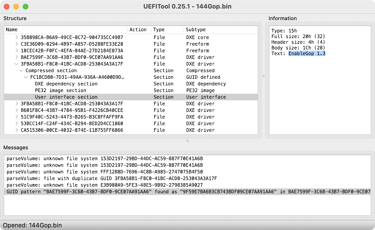

  1. Open the UEFITool
  2. Drag the 144Gop.bin into the UEFITool window
  3. Press Command + F to bring up the search window
  4. Choose GUID
  5. Choose Header only
  6. enter BAE7599F-3C6B-43B7-BDF0-9CE07AA91AA6
  7. press OK
  8. Double-click on the search result (the blue line in the screen capture)
  9. As you can see from the above screen capture, the BAE7599F... entry will be highlighted automatically. This is NOT what we want. Instead, we expend the one BELOW it (3FBA58B1....), then you should able to see the User interface section. Click this line, and you should able to see the EnableGop version in the right hand side window. [The link in this post already updated to EnableGop 1.4]
  10. This is the first check. And now we can close UEFITool, and go for the second check

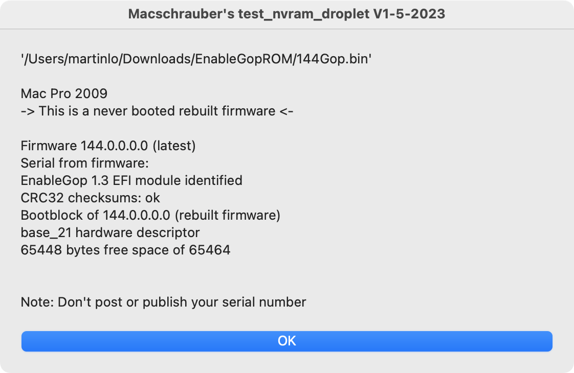

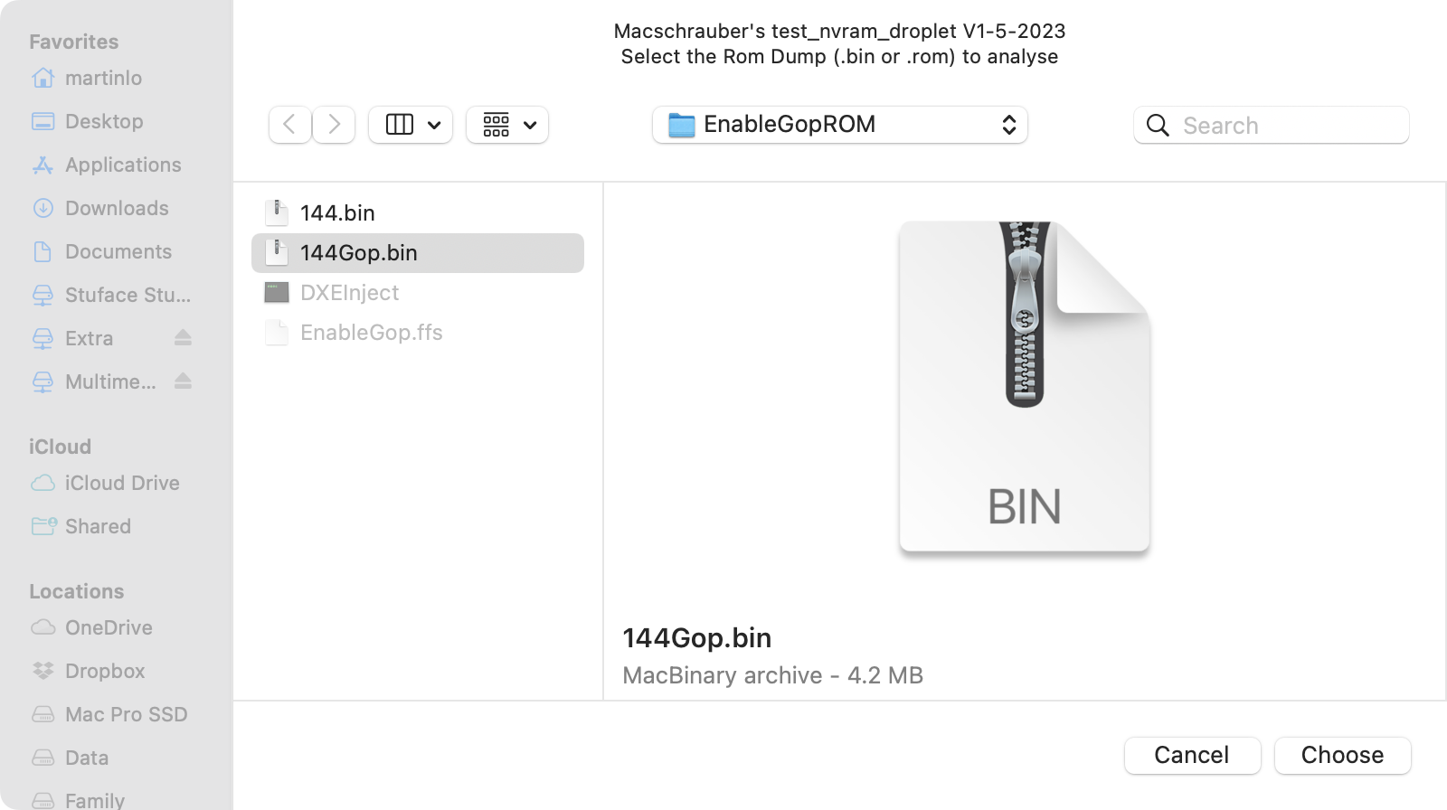

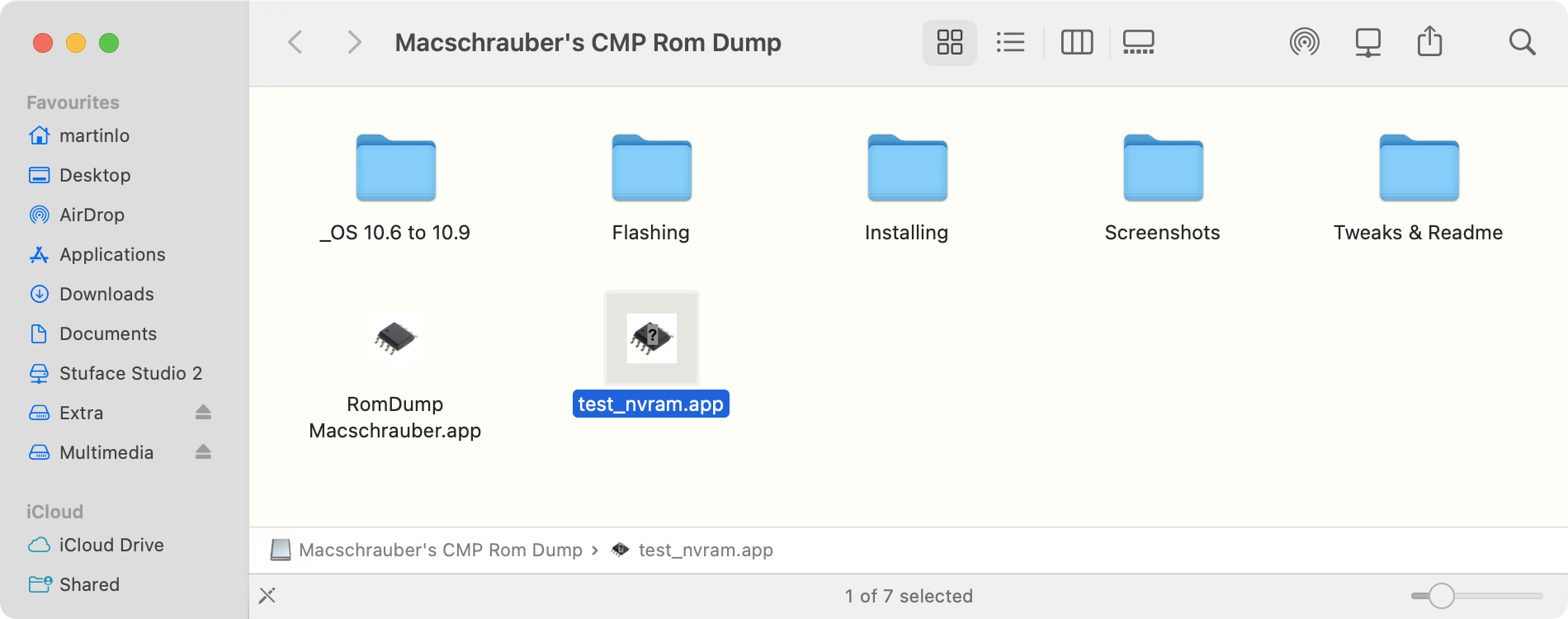

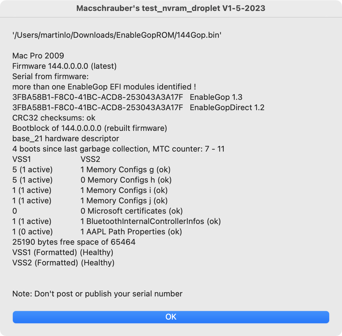

  11. Go back to the Macschrauber's CMP Rom Dump dmg, double click the test_nvram.app
  12. Drag 144Gop.bin into the window
  13. Click Choose, wait for a few seconds, then you should see the result
  14. In the above example, I inject the EnableGop 1.3 on top of my existing ROM dump that already has EnableGopDirect 1.2. Therefore, both entries show up. But in your case, there should be one and only one entry related to EnableGop(Direct). If not, delete the 144Gop.bin, do NOT use it. And start from the beginning again. If you start from a clean / reconstructed ROM, the final result should looks like this
  15. Last but not least, check the 144Gop.bin file size in Finder, it MUST be exactly 4,194,304 bytes
  16. With this triple checks, the 144Gop.bin should be safe to use.

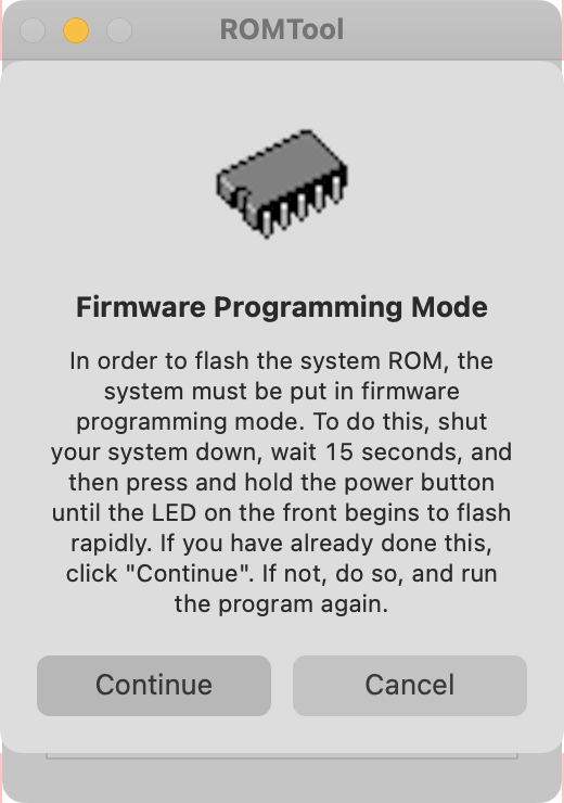

  2. Press and HOLD power button to turn on the Mac. Do NOT release the power button until the long beep (after the normal start up chime) is finished.
  3. Once the beep sound completed, you can release the power button, and let the cMP boot back to normal desktop again.

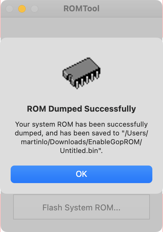

  4. Open ROMTool (RomDump Macschrauber should able to do the same thing. But we use ROMTool here).
  5. Select Dump System ROM, enter password as per on screen instruction, and save your existing ROM image (as backup)

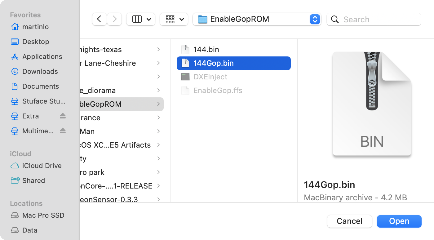

  6. Select Flash System ROM
  7. Drag 144Gop.bin into the window
  8. Click Open
  9. It will ask you to put the Mac into firmware flashing mode, which should be done already
  10. Click Continue, and enter admin password as per onscreen instrcution, let it finish the job. Do NOT use your computer to do anything, do not browse the web, do not play video / music. Please just don't do anything and wait for a few seconds.
  11. Once it's done. Do NOT reboot your Mac. It's our last chance to fix the problem if we did anything wrong.

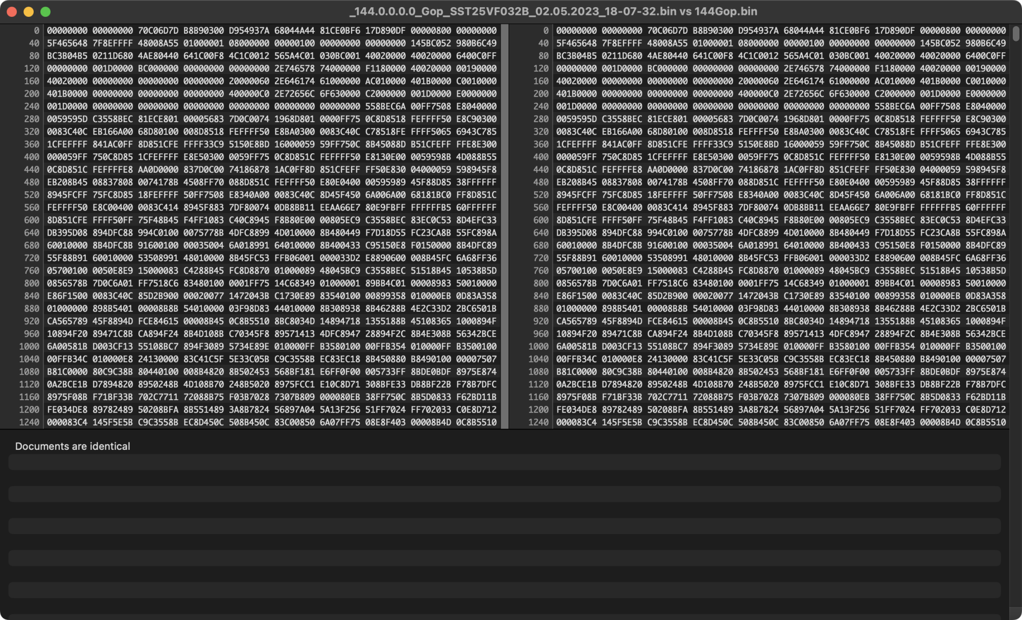

  1. Re-do steps B1-B5. Now, you should see EnableGop(Direct) is detected in step B5

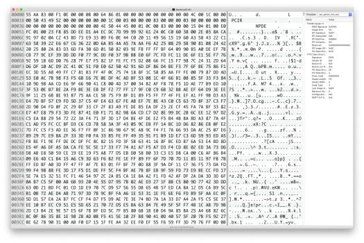

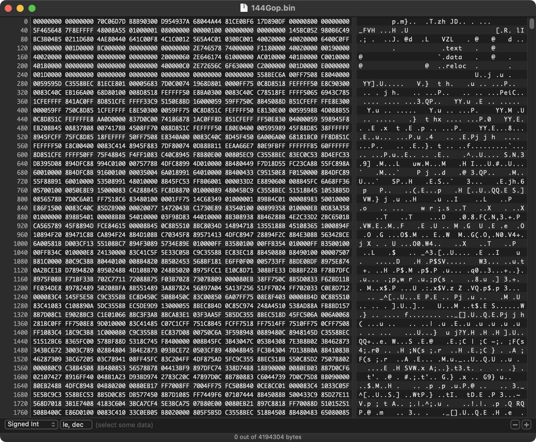

  2. Open Hex Freind
  3. drag 144Gop.bin into the window
  4. Press Command + O
  5. Drag the latest dump from step F1 into the window
  6. Click Open
  7. Press Command + Shift + D
  8. You should see "Documents are identical"
  9. This should be good enough to confirm the ROM is correctly flashed
  10. If any of the steps above shows abnormal result (e.g. no EnableGop detected in step F1, or the documents are not identical in step F8), do NOT reboot. But flash the Untitled.bin (from step E5) back into the cMP. This is the last known good bootable ROM.
    [N.B. If you flash Untitled.bin back into the cMP, please use RomDump Macschrauber to dump the ROM, and use Hex Friend to compare this dump vs Untitled.bin. They should be identical]
    Never ever shutdown / reboot your Mac until you get this "Documents are identical". This is your final safety net.

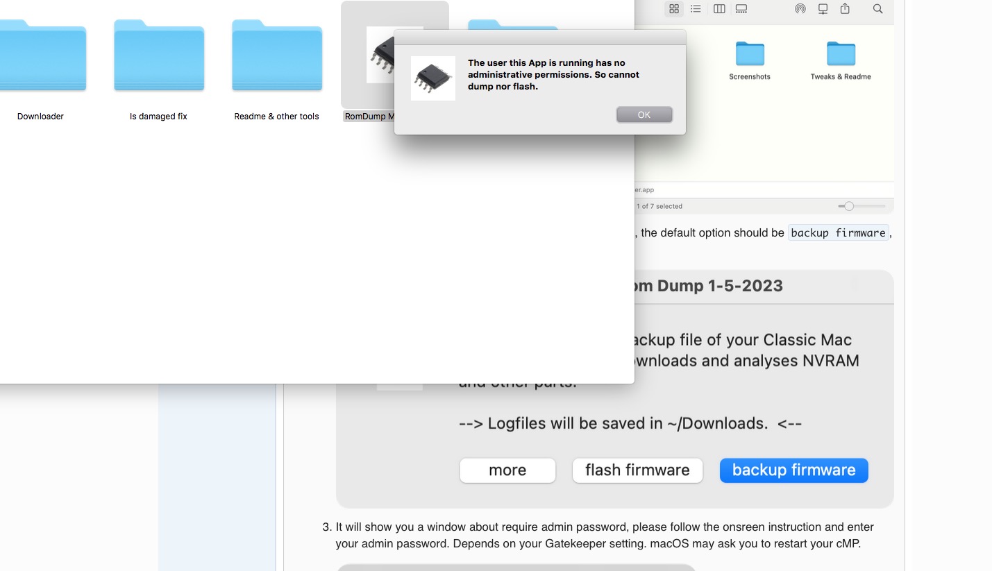

Hi guys
@Macschrauber @h9826790
I get this when I try to dump the rom with macschrauber romdump...
Any advice?
My SIP is disabled and user root is active as well on my mac. I'm the admin of course...
The user this App is running has no administrative permissions. So cannot dump nor flash.

Yes, double check if your user has the needed privileges.
we got that sorted. @vworks had somehow managed to get a user name with a space character in. I dont knew that this is even possible. So that needs quoting, what I added for the next release.

the Dumper https://github.com/Macschrauber/Macschrauber-s-Rom-Dump
and
DosDudes DXEInject DXEInject.zip
is what one can use, to do the Mac Pro firmware.
and
Thank you -- both for the info and for your amazing tool! Before you replied, I worked through the steps to add EnableGOP to my MP5,1, and when I got to the flashing stage I saw that Rom Dump could do it, so I just did it there, instead of using ROMTool. Everything worked great, and for the first time in years my old Mac Pro has a boot screen. :)

I'm going to flash a new ROM provided by tsialex tsialex which includes the latest EnableGOP.
I can't use Macschrauber's dump tool though, as when I try to unzip it, a password windows pops up and a password is requested, and I cannot find out how to get one.
Cheers
MP
Will remove all my drives etc and then make a duplicate of my current drive (Mojave) and will use Superduper to do that. I think I'll put the drive into the DVD connection to start with. Then I'll copy that drive to a 1TB one, and put it on a shelf. I don't know which OSs are on which drives at the moment. Will be fun finding out. Some software I lost with Mojave will be useful.
Thanks.
I have no intention of changing the card's BIOS. EnableGOP effectively provides what is needed anyway, and leaves the door open to changing the GPU (most of them) without a headache. The 5770 GPU is really no longer a safety item now.
I may look at the card and check if its starts though after finding the switch. My understanding though was that to change the card BIOS, I'd need two cards in the machine and to do so under Windows. No need for that with EnableGOP but I was unsure if my RX580 was operating in its full capacity. I presume it always has been.
Cheers
MP
First google hit:
It is all written:
Use my Github Downloader to obtain a copy with no quarantine flag set:
You may need to right-click on the App and select open.
The password is rom. The problem is that included Flashrom and sometimes DirectHW.kext triggers malware protection. This is the reason I (and before, Dosdude) needed to encrypt the tool, to get it over.
