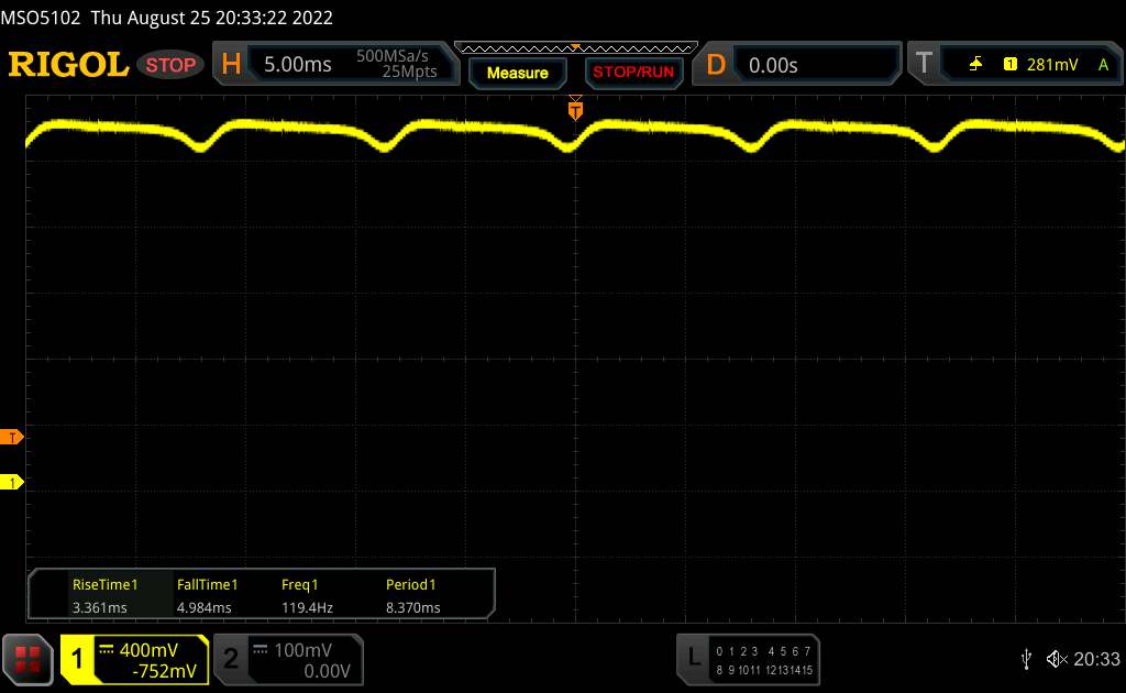

Look at the new profile of the new Zenfone 9 for example, which is DC dimmed and I still could not use:
THe flicker is constant at 120hz, which means I did not have raging headaches straight away but only dizziness and brain fog when I tried the phone (or maybe I did not try it long enough for those crazy headaches). That did not make it usable and eventually I returned it.

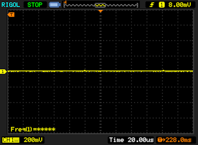

What we want is something like the iphone 8 plus, which does not flicker ever never forever:

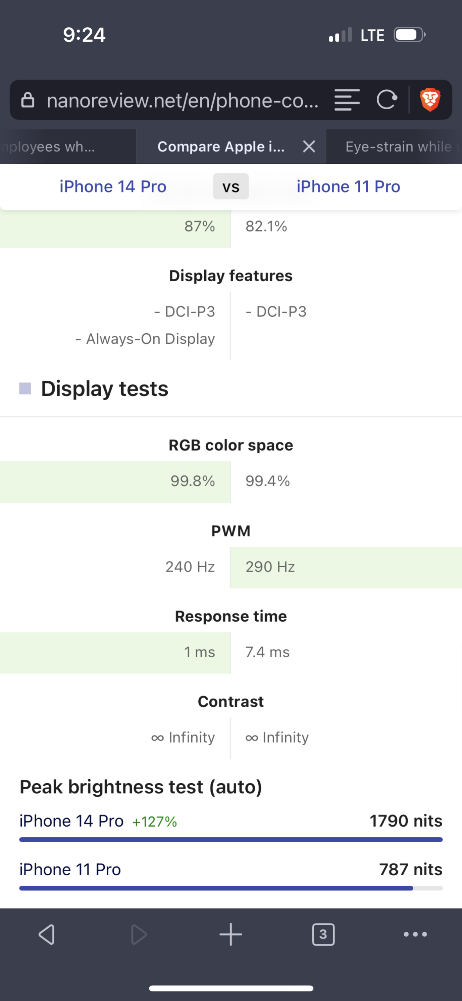

As you may have seen, their source for the PWM info is notebookcheck
I think accurately measuring flicker is becoming harder and harder. These phones have variable refresh rates, variable brightness rates, temporal dithering etc. anyones guess how that all shows up on a measurement device. Like does the 14 pro flicker the same at 10hz and 50% brightness as it does at 120hz? Probably not… lots of variables to consider.
