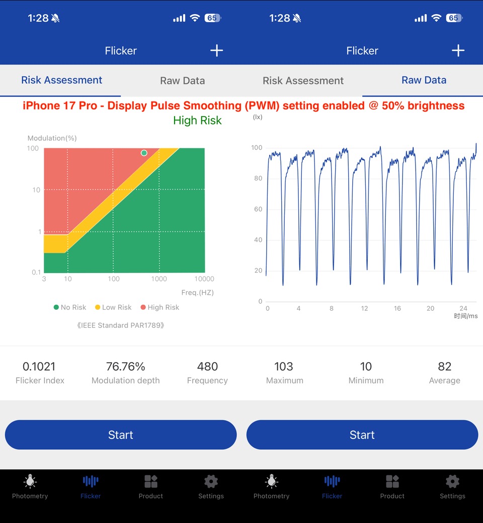

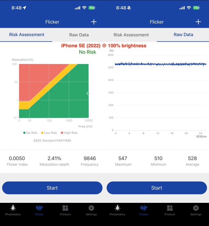

I’m extremely disappointed looking at all of the measurements and experiences in the PWM-sensitive communities. All iterations of iPhone 17 are still high-risk on the flicker index, regardless of whether Pulse Smoothing is disabled. Meanwhile, iPhone SE, iPhone 11, and even the LG OLED TV’s pose no risk.
I’m actually in disbelief at how badly-implemented and tone-deaf this feature is. I expected maybe it would be a a significant effort that wasn’t enough to be 100% reliable, especially for the most sensitive users like myself, but the measurements are virtually identical to every past year with the setting enabled. Wow. Blasphemy.
This is what we need:
vs what we got:
