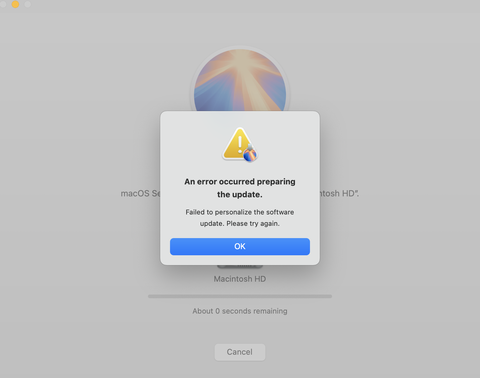

I'm having the same issues. It's pretty infuriating. Although apparently Apple has a fix for it sometime this week according to someone on reddit. Anticipated to arrive this week. So I guess we will see.
I would try creating a new user in Settings/Users & Groups/Add User... Log out of the current user you are using and update from the new user account.
I had this issue with an M1 mini going from one of the betas to the release candidate version (which is the same as the final release.) To fix it I had to put the mini into DFU mode and use another Mac and Apple Configurator to revive the firmware on the mini. Once that was done, I was able to install the 15.0 update without error.
Nice, but we shouldn't have to fuss around and waste our time with all that just to install or update our OS. This is entirely ALL on Apple. And some of us don't have the luxury of having more than 1 mac. Such a PITA really. Never had so much problems trying to update macOS before. This is a first.

I keep getting this window that pops up whenever I try to update to macOS Sequoia. I am currently on macOS 14.6.1. I'm on an M1 MacBook Pro. It's driving me nuts because I never had problems updating macOS before.
Seems a lot of us are having this issue. I assume and hope Apple will address it over the next few days. We'll just have to be patient

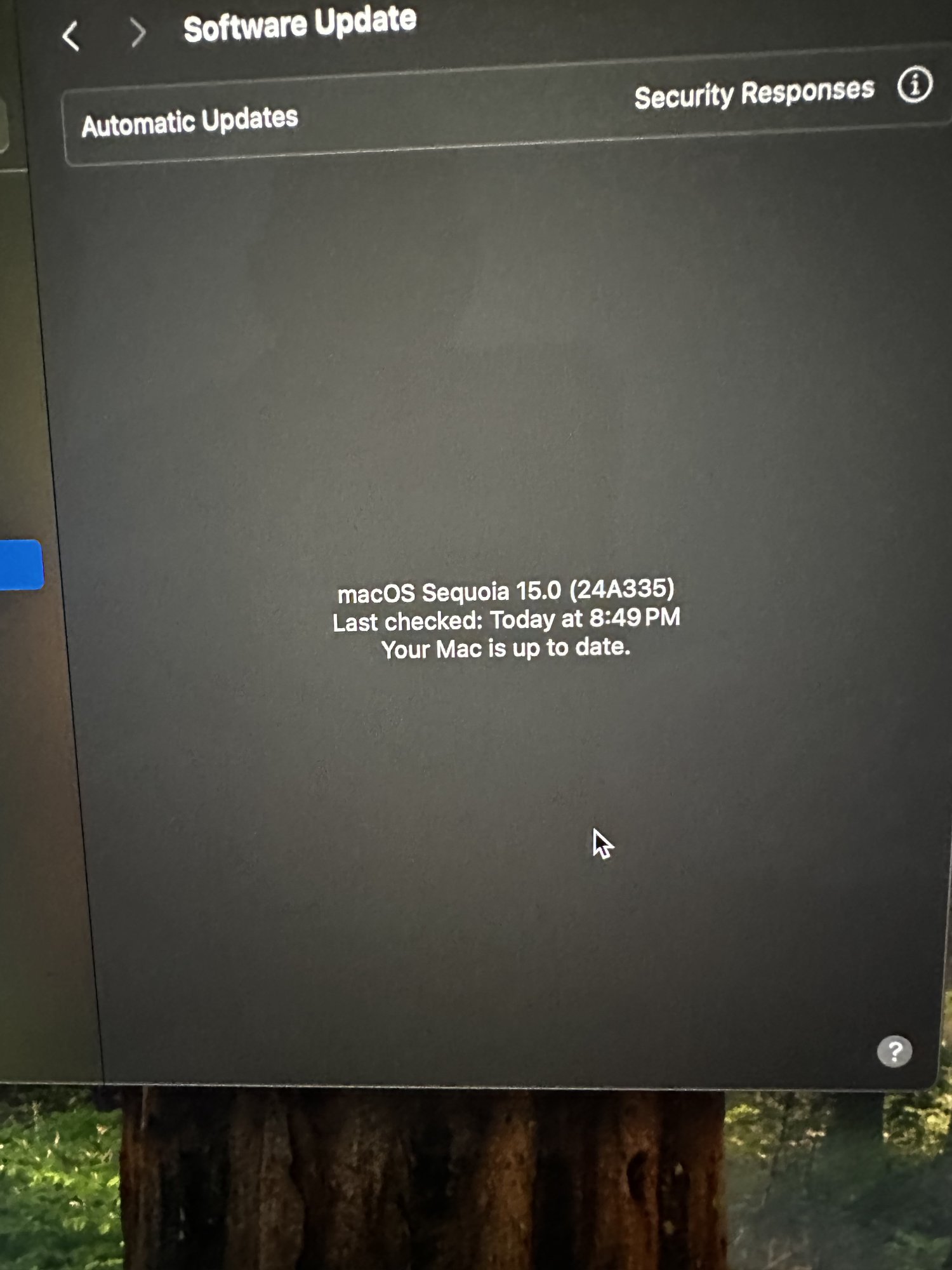

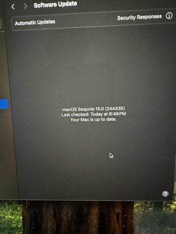

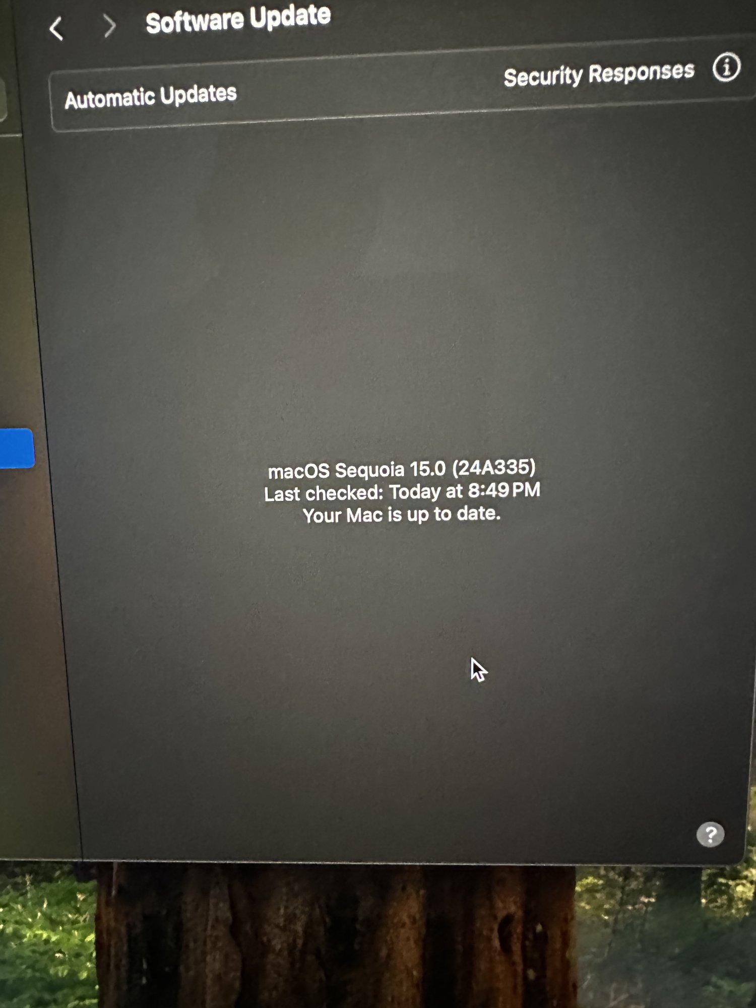

Update: I followed the list from the WiFi on and off to the forget network and establish it again. I booted into safe mode and downloaded Sequoia but when it came to installing it, ” an error occurred preparing the update, failed to personalize the software update”. I figured I would run through the online Apple support. I tried to reinstall Sonoma from recovery but had same error. I erased my drive and went into recovery. When it got time to put in for the activation lock password (because this fool forgot to turn off find my device) it failed activation. So long story short I took it in to the Apple Store I originally bought it from, and they hooked it up to their MacBook. Had me delete my device on iCloud and rebooted Sonoma for me. It was done pretty quick. I’m home and the update to Sequoia seems better than before. It finished and restarted and currently watching it update. Finally! It booted into Sequoia.
