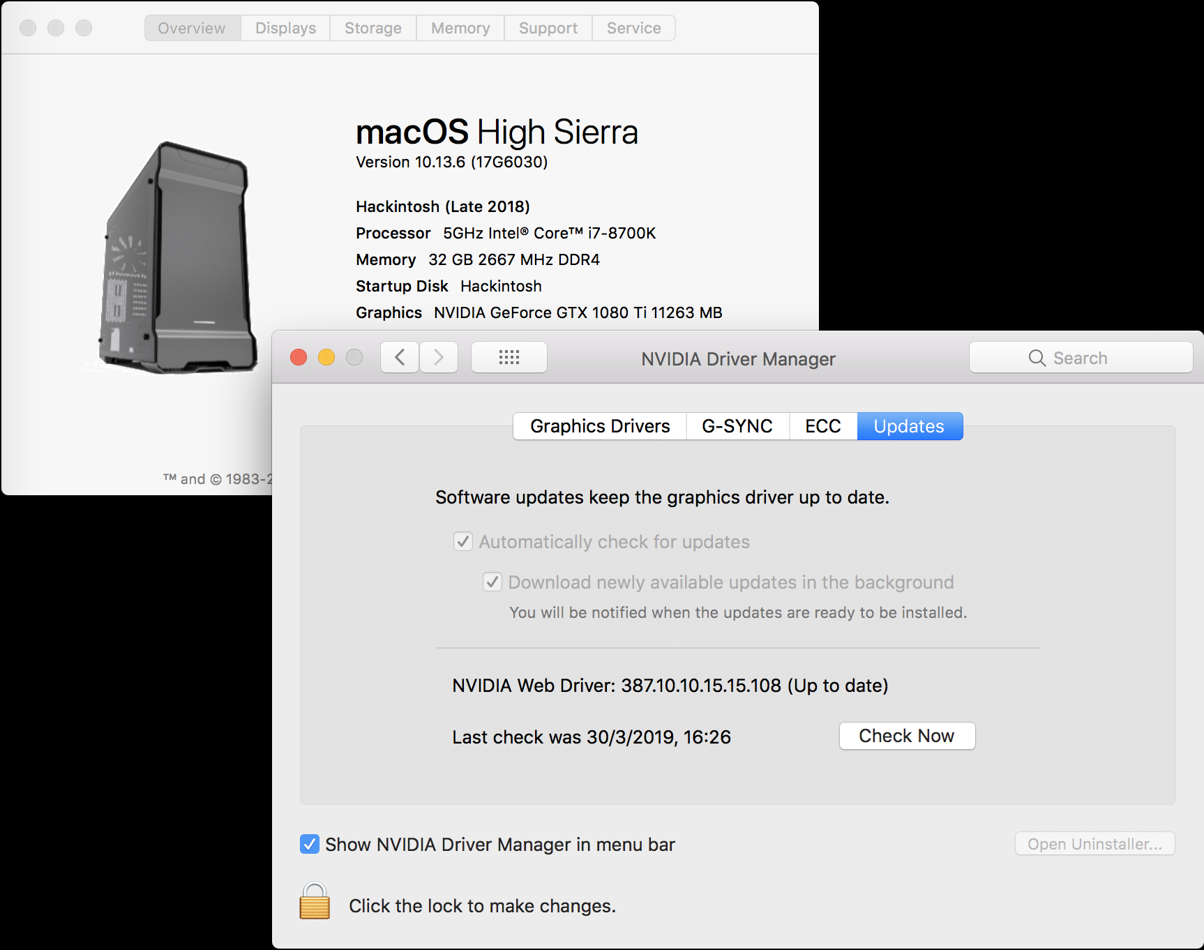

New Web Driver out for Security Update 2019-002:
(17G6029) (CUDA 10.1/418.105): https://www.nvidia.com/Download/driverResults.aspx/145775/en-us
I'm staying with 387.10.10.15.15.108.
Lou
I "updated" just to take a look and see.

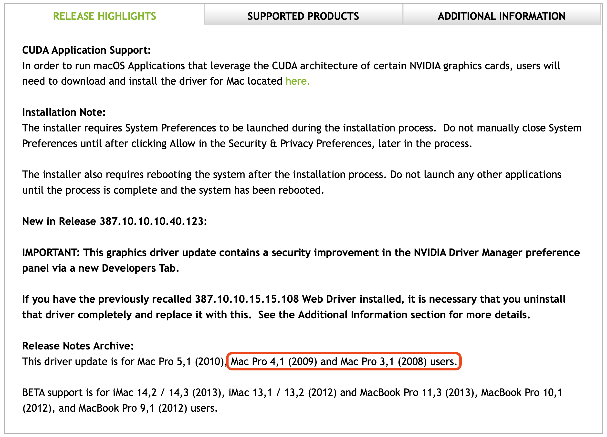

[B said:
NVIDIA Web Drivers[/B]
NOTE: NVIDIA is officially stating to uninstall the 387.10.10.15.15.108 driver and move to 387.10.10.10.40.122. Leaving this information and links for those who choose to use anyway. See post #17 below for release notes.
NVIDIA Web Driver version 387.10.10.15.15.108 does not break with each macOS update (through High Sierra), but was pulled by NVIDIA and is no longer publicly available directly from NVIDIA's servers. The 387.10.10.15.15.108 driver included VOLTA support.
387.10.10.15.15.108 has been posted below (See post #8):
http://scriptsandbits.billybobbongo.com/nvidia/WebDriver-387.10.10.15.15.108.zip
It is not 100% confirmed that 387.10.10.15.15.108 is functionally compatible with all features of CUDA 10.1/418.105. Driver appears to work with most basic CUDA acceleration applications. If your workflow depends on latest versions of CUDA, might be best to stick with the publicly released driver versions and would be first place to troubleshoot potential issues.

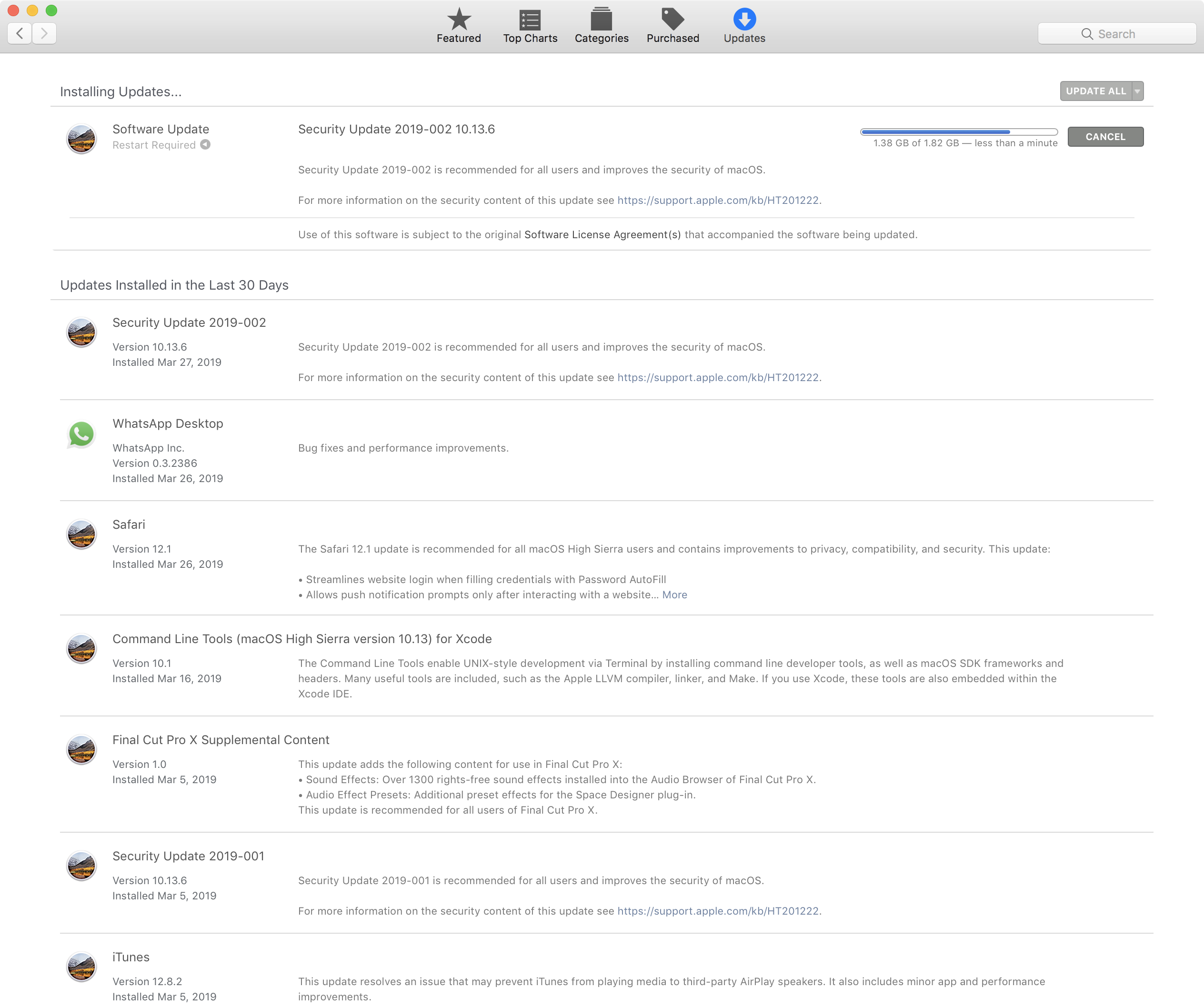

This was an extremely useful driver you pointed me to. I went ahead and installed 387.10.10.15.15.108 and it totally works. I don't use CUDA so I can't confirm that there are no issues there but I can confirm that it survives security updates. Thank you so much.
I was checking the SU catalog and noticed that Apple reissued the High Sierra SecurityUpdate 2009-002 and now the build is 17G6030.
So, NVIDIA will need to release a new version of the web driver.

Someone spotted this funny fact. Both Mac Pro 4,1 and Mac Pro 3,1 are NOT supported for High Sierra. There is no way to install 10.13.6 on these Mac natively and run this version's web driver.
TBH, I believe that they are just too lazy to check and update the info. I don't think they intentionally support those Mac that run patched macOS.
