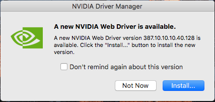

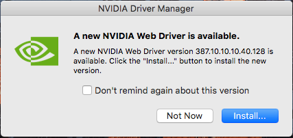

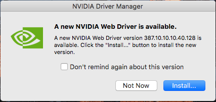

Web Driver for Security Update 2019-003 (17G7024) Issued this morning:
https://www.nvidia.com/content/Driv...-387.10.10.10.40.128.pkg&lang=us&type=GeForce
Web Driver 387.10.10.10.40.128
