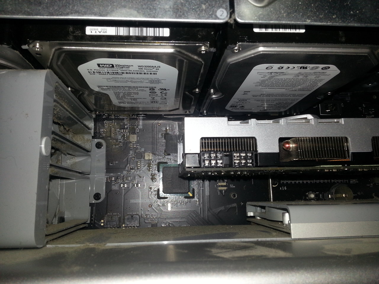

I have a 4.1 Mac Pro in which I want to install a Gainward GTX 580. From my reading this appears to require both a 6 pin and 8 pin power line. So far so clear.
However when I look at my card it appears to have two 6 pin sockets. So im checking if that is the case or is the gap between the two sockets the space for an 8 pin power line?
I have included a pic of the card just in case i'm missing the totally obvious.

580 wont work on internal power, you would have to power the card with an external Power Supply.
You need a card that is 6pin + 6pin max to use internal power on the Logicboard.
You can buy the power cables on Ebay, or if you live near Toronto I have a pair.
That definitely looks like 2 6-pin connectors, are you sure it's a 580 and not a 570 or something?
Doh! So long since I bought the card I forgot it actually is a 570. Thanks for the help. ;) And a can of air will be giving it the once over soon. :D
They look like two 6-pin connectors to me.
