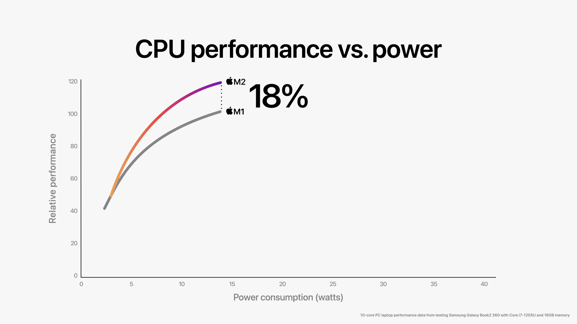

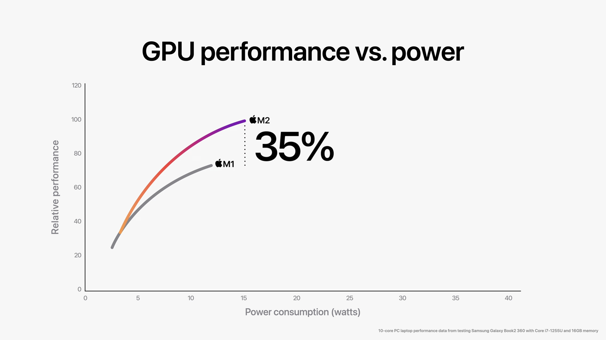

In transistor count I know it's ~20% bigger. As per power wise, it has been confirmed it consumes more power when reaching peak performance vs M1.

Something like that. In the end the power gaps between both at peak are 0W when at peak CPU performance, but at the lower end there is a 1W gap with the M2 consuming more.
In the GPU front, there is a ~4W gap at peak with the M2 being the high consumer. At lower end there is a ~1.5W, again with M2 consuming more.
How does this translate? Well, given the recent video reviews, it seems those minute power draws are creating hot spots on the fan cooled MBP. Albeit that can be attributed to the fan curve being a disaster. But in a finless operation? Translates to quicker throttling.
