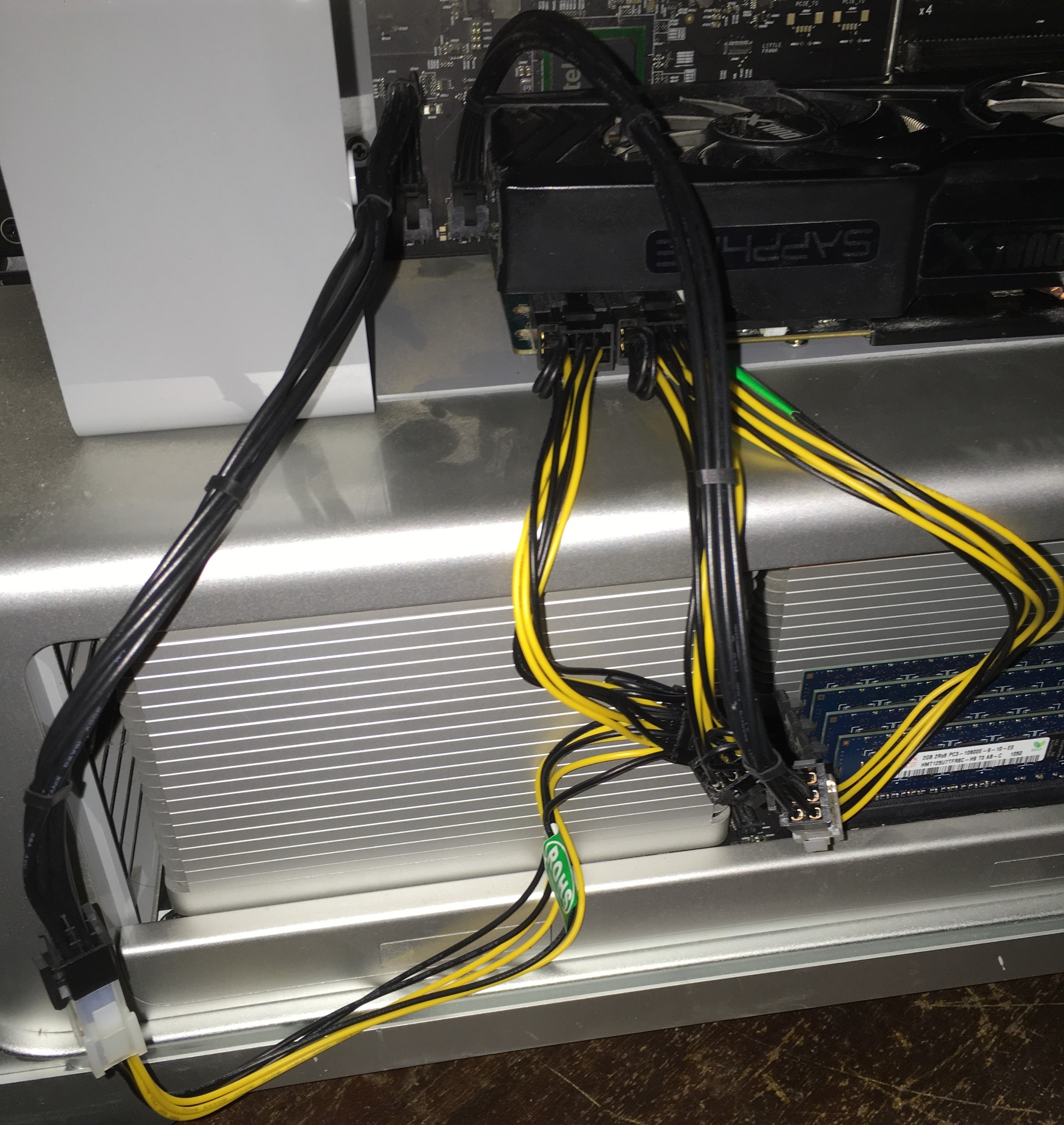

This is what I did for now. I plan to add another line on the mobo and do another 6-8 pin so it's one line per 8 pin.
I haven't run any benchmarks. I'm able to boot into OS X without issue minus my 3rd monitor, but I think that's the card configuration 2 dvi and 1 hdmi 3rd probably has to be display port instead. All 3 work in Windows 10 as is.

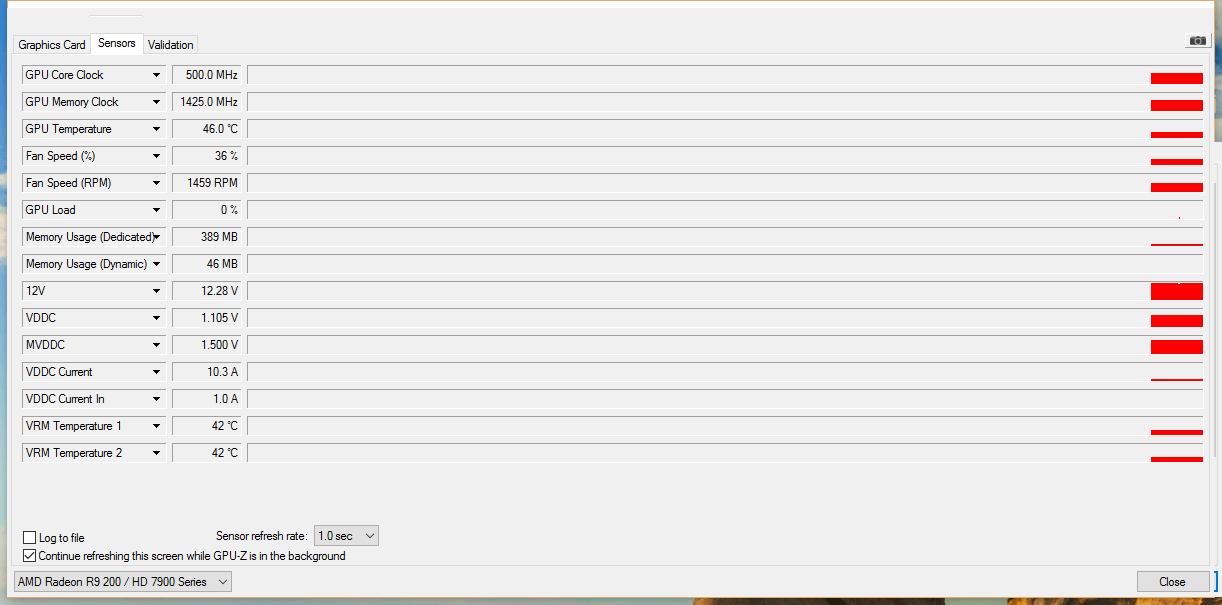

I did look at GPU-Z and HW Monitor but I have no way of knowing if the numbers are good or bad. However, I opened Steam and ran Fallout 3 on ultra high with Age of Ultron playing 1080p on another monitor and the voltage never budged and the highest gpu utilization was 18%-24%.
redir
https://onedrive.live.com/redir?res...authkey=!AM-KJdAPngq1FC4&v=3&ithint=photo,png
did a screenshot of what the hw monitor is showing currently as well.

Doesn't looks good to me. It will be ok in desktop environment, but will definite overload the 6pin source under stress.
You better not to stress the card until you install the 2nd 6-8>pin. Or you may get a mini 6pin male -> 6pin female to connect the remaining connector to the mobo. My understanding is that inside those cables are just wires, no circuit. So as long as you can connect the remaining 6pin to the mobo. The card will draw power from both 6pin sources.

The 7970 can definitely draw more than 120W from the aux power cables, which means will activate the self shutdown protection if put all loading on a single 6pin source.
HWMonitor or iStat can measure the power draw on the 6pins. The most extreme test in OSX should be Furmark. If your machine can run that for 15min, most likely it can handle any operation (including heave gaming).

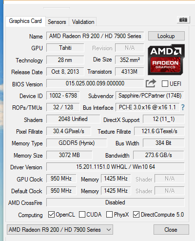

In other news - I successfully flashed my Sapphire R9 280x - one of the DVI ports is dead (not sure if it's the D or S - it is the black colored port. I haven't the foggiest if the HDMI port is working and I need a full size DP cable to test if it works - but at least I have a boot screen :D
Based on readings from the HW Monitor as I was running the Heaven benchmark, PCIe Booster A report a max of 105W - and Booster B was 69W (although not at the same time) that was while running a custom benchmark using full screen 1080P, high quality and x2 anti-aliasing - all other options disabled.
Using the same parameters as above, the MSI R7950 OC was at par if not a micro bit better (one or two points in score and frame rate) than the Sapphire R9 280x Vapor X pre-flash. Post flash was a different story - the R9 280x came out on top compared against its pre-flash self and the flashed R7950 - there was a performance gain! Could this be true or did the flash somehow 'gamed' the system?
I will say too - the cooling on the R9 kept the temps between 41-43C but the MSI under the same load goes up to 70! Maybe I should look for a Vapor X R7950?

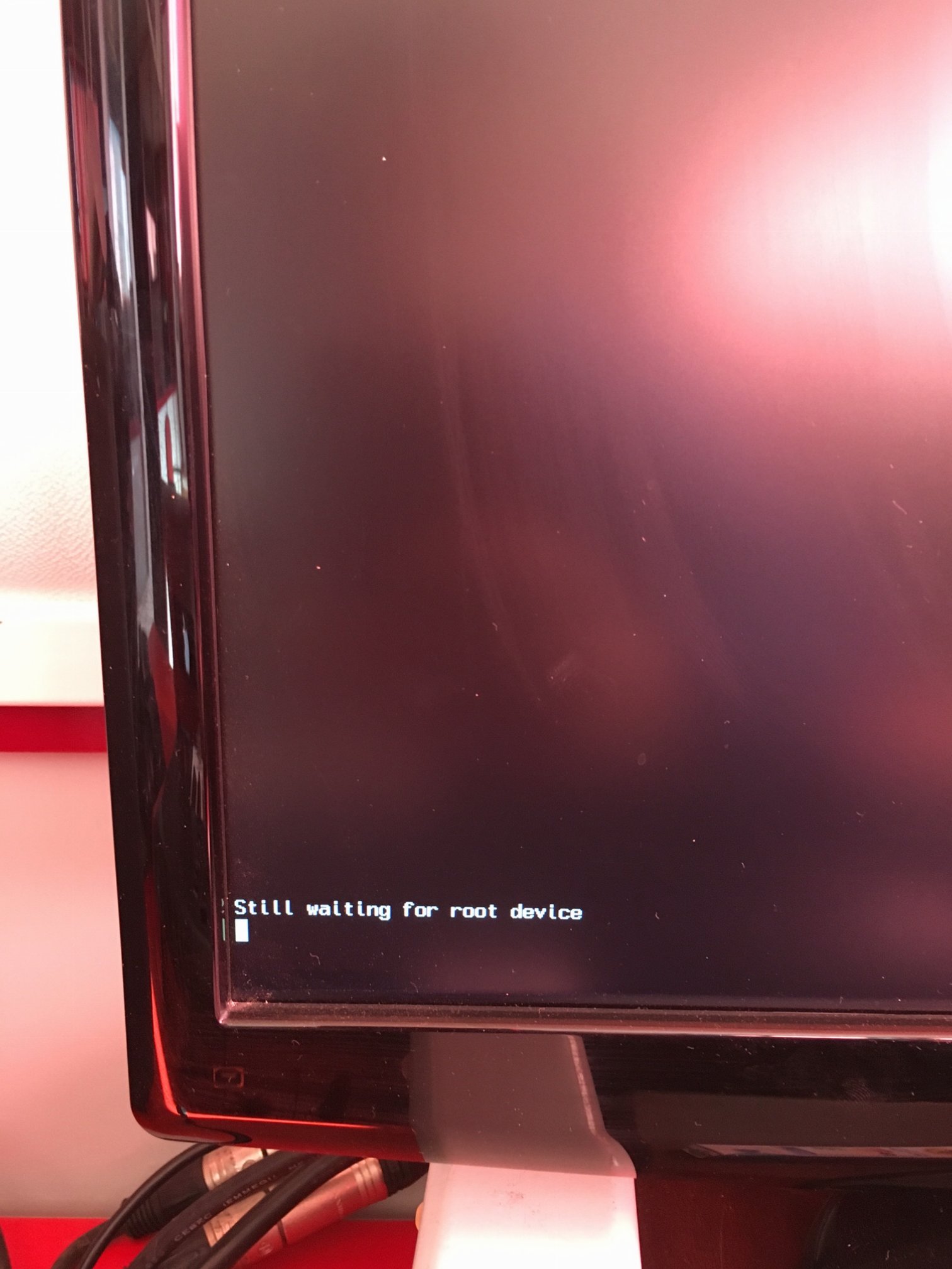

well, My mac pro 1.1 wont boot since this morning, not even with the original 7300 gt card. I can only get it to boot with safe mode, and all graphics goes super slow, screen is loaded in bars also.
Any one has had a similar experience?
I changed all, ram, gpu, etc...

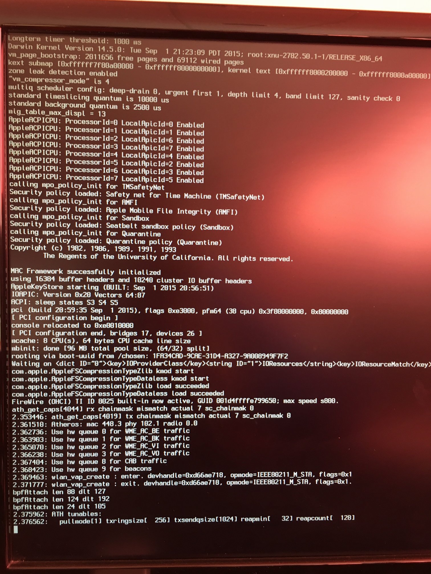

When i start in verbose mode i have this.

Nope! i really want that to be the last chance! cause i have a lot of software running.
I also did, repairing permission, disc, onyx and nothing!
Well Guys interesting news for real!
Finally i didn´t solve the problem of my Yosemite os, i was 10.10.5 all well and the other day it won't boot up.
So i saw some guys telling that the graphics work has been really optimized in El capitan because of the "Metal" thing.
Well, i´m only going to say 2 things, 5 min to have el capitan working.
