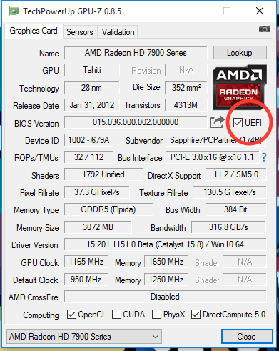

Yes, I suspect you used a UEFI ROM to create the Mac EFI ROM. For that script to work, you must use a 128k legacy ROM image as the source.
If your ROM image is 128k, but not legacy. You can either
1) Use VBE7 (in Windows) to open the ROM and as it, this will automatically disable the UEFI part (there will be a warning to tell you that).
2) Manually copy the Mac EFI part to replace the UEFI part in a Hex editor.
3) Disable / remove the UEFI part in a Hex editor, and then use that self created legacy ROM as the source for the script.
How do I know what kind of ROM it is? Sorry if these questions seem stupid I just really don't know what I'm doing. I'm trying to leave my PC and move onto MacPro but keep Windows on boot camp, but I want to bring my R9 280X with me. However without an EFI boot I can't use any hotkeys for boot options nor recovery. This is why I'm trying to flash this ROM. The forum made it look simple but I'm feeling so confused now.
GPU-Z will tell if your card is booted from a UEFI ROM.
Or use VBE7 to open the image file that just dump from the card, you will also revive a warning about the EFI part will be disabled (legacy ROM do not shows this warning).

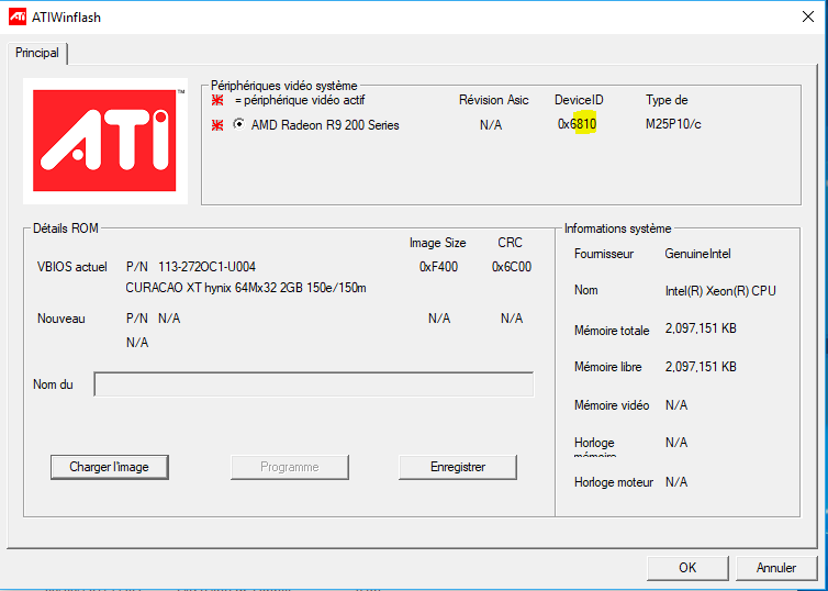

So this is my card : Sapphire R9 270X Toxic (https://www.techpowerup.com/gpudb/b2465/sapphire-toxic-r9-270x-oc)
I tried to flash it to have the EFi working in my MAC Pro
So I put the card in the mac pro booted Windows 10, I extracted the original BIOS and the Device ID using ATi Winflash (see deviceid.png)
I erased a usb key, downloaded the bundle from netkas forum (http://forum.netkas.org/index.php/topic,5619.0.html)
extracted it to the usb key, copied the original SapphireR9270XToxic.rom I saved from ATi Winflash to the key.
Then I went to my mybook pro inserted the key and executed the script
./makerom.sh --efifile=7950mac.efi --romfile=efiromheader.rom --originalrom=SapphireR9270XToxic.rom --devid=6810
this generated the SapphireR9270XToxic.rom.efi.rom without any error
So i took the usb key back to my pc and flashed my card using ATI Winflash with the SapphireR9270XToxic.rom.efi.rom
I included the original rom and the generated rom in SapphireR9270XToxicroms.zip
Apparently EFI is working well , I can press the alt key and I have the boot menu on my mac pro

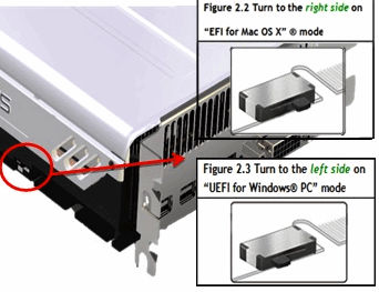

With MSI R9 you have UEFI BIOS on one switch position, so you could just grab EFI part from finished MSI Mac EFI ROM and paste it into your own. Again, you should read netkas' topic on this so you know exactly what to do but that way you don't have to manually edit your ROM for the card to be recognized as 7950 or 7970 but as R9 280X.
