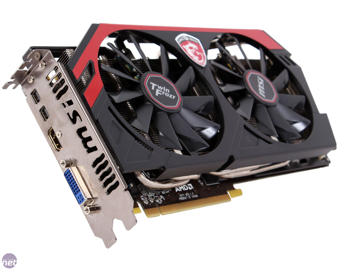

Okay, so I'm a little late to the party. I have a Mac Pro 5,1 with x5650 cpu + 24GB Ram, Boot Rom 144.0.0.0.0. Installed an MSI R9 280x with both 6 + 8pin cables connected, however I only get a black screen. Flashed it using Rom from first page of this thread, I get the boot screen, then back screen. Fans rev up then slow down on black screen. It boots fine in Windows and will also boot into Mojave in safe mode only. Any ideas?
Try the lower dvi port, hdmi and upper dvi could not work in macOs
Thanks for your response, however the card has one DVI, one HDMI and two Mini DP. I have tried all configurations with the same result. The model is the same as the photo: MSI R9 280x.

Exactly how are you powering the MSI R8 280X ?
( Note : You can use the EVGa PowerLink with this card, it's cheap and balances all the power avail able to to card. Originally designed for Nvidia cards .. it CAN be used with AMD cards. )
https://www.amazon.com/EVGA-PowerLink-Support-Founders-600-PL-2816-LR/dp/B01MQ1YEYH
I used the PowerLink with my flashed HD 7970 which is a little brother to your R9 280X
https://forums.macrumors.com/threads/evga-powerlink-with-amd-gpus.2166917/
If you need help please PM me.
Which BIOS switch setting is the card on ? It should be on Setting " 2"
( if it is on # 1 set it to #2 and re-flash it )
PS : I hope that you backed up the original ROM.

I'm using mini 6pin - 6pin, mini 6pin - 8pin. Flashing was not the problem (yes I used #2 and I backed up original rom). I get boot screen, progress bar goes to about 80%, then black screen, followed Fans revving up, then reboot. I can boot in safe mode into Mojave (tried macOSs back to El Capitan), and can boot to windows.

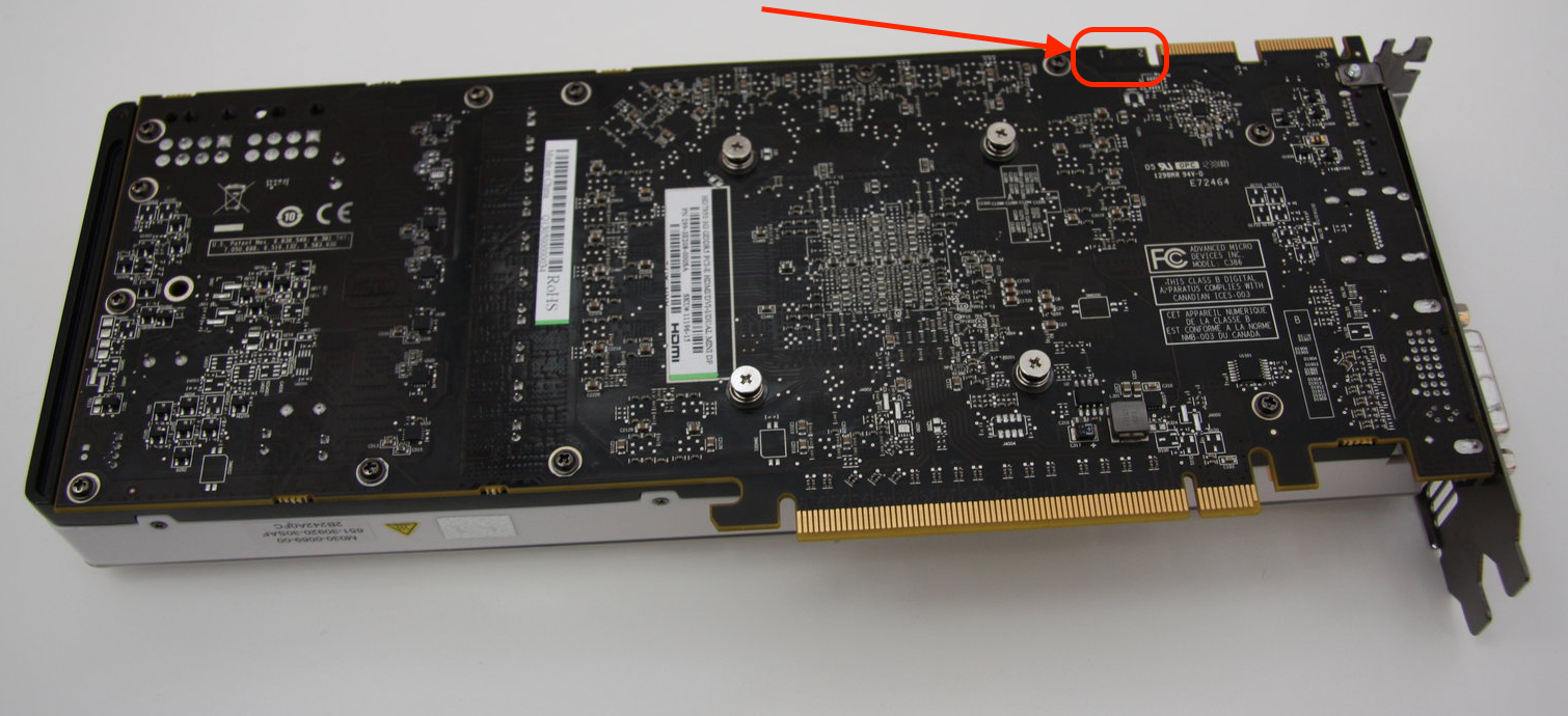

Just for info, how do you know which is position 2? It's not marked on mine...
eighteentee
We ALL went through that . . . the first time.
As long as you have backed up the card's ORIGINAL ROM ( from BIOS SWITCH position #2 ) and have read ALL the Netkas pages http://forum.netkas.org/index.php/topic,5619.0.html
.. . . you will be OK. I have ( since the first time ) successfully EFI flashed 6 AMD GPUs but I still work slowly, carefully, double & triple checking everything. It's a bit like a pilot's pre-flight checklist.
